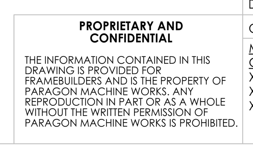

Paragon’s own axle (https://paragonmachineworks.com/files/public-docs/SK4025.PDF) is 125mm long, so you should be able to use any other M15 x 1.5mm x 125mm axle like Lightning Bolt-on Axle - Front 15 mm x 125 mm x 1.5 Thread - The Robert Axle Project
NOOOOOOOOOOO YOU CAN’T JUST COPY AND PASTE A PDF NOOOOOOOOO!!!
YOU
           WOULDN’T
   STEAL LINK A
                        CAR PDF
