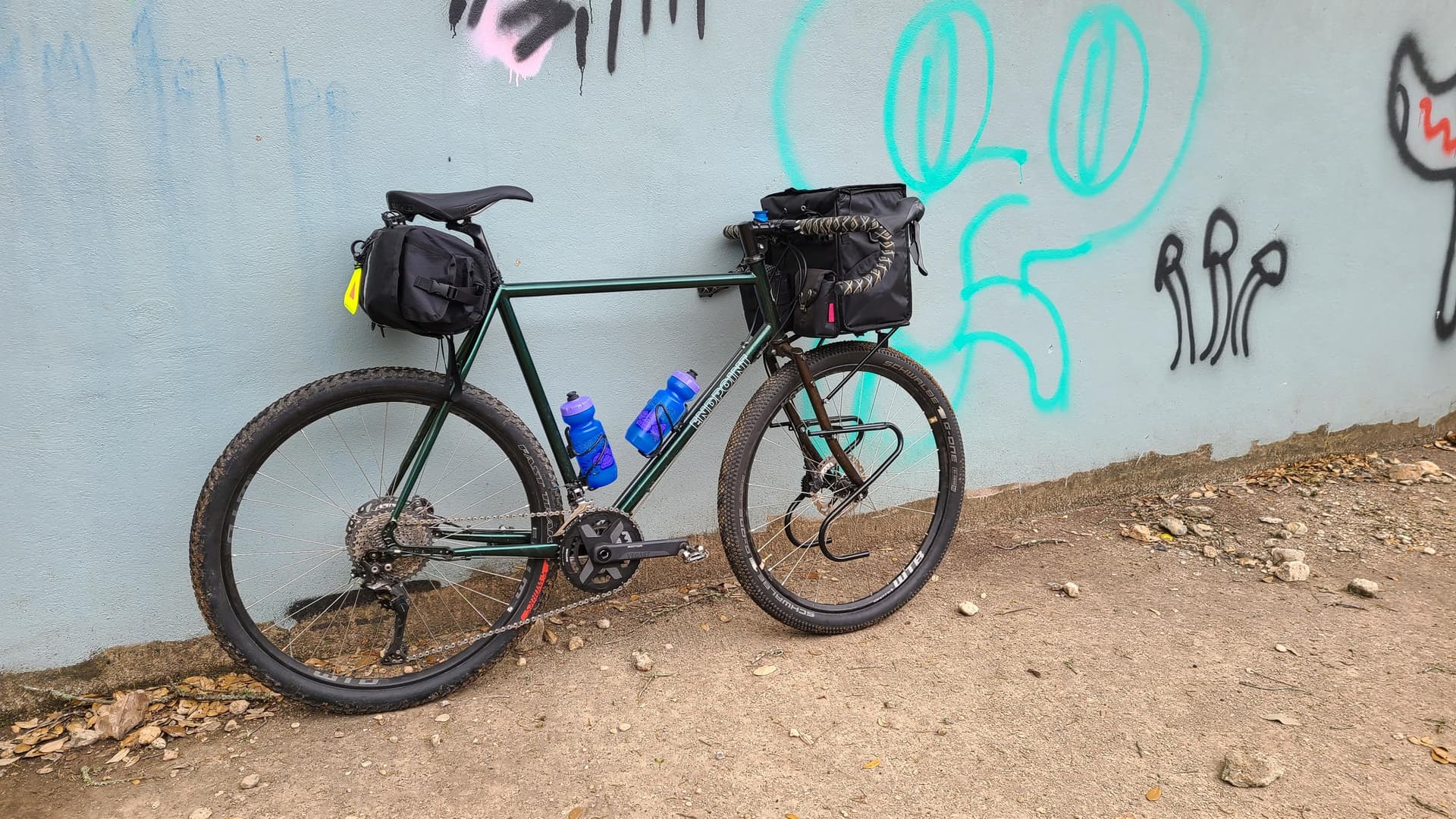

Here’s a super duper proto thing with some chonky Fast Traks on it. 2.2?
ok ok ok let’s take a step back here
Let’s not. This had to happen to get us where we are now, but it was never meant to be.
as the owner of a titanium prototype all road frame that doesn’t clear a road crank properly i’ll go ahead and agree. great bike though as long as you embrace square taper life
