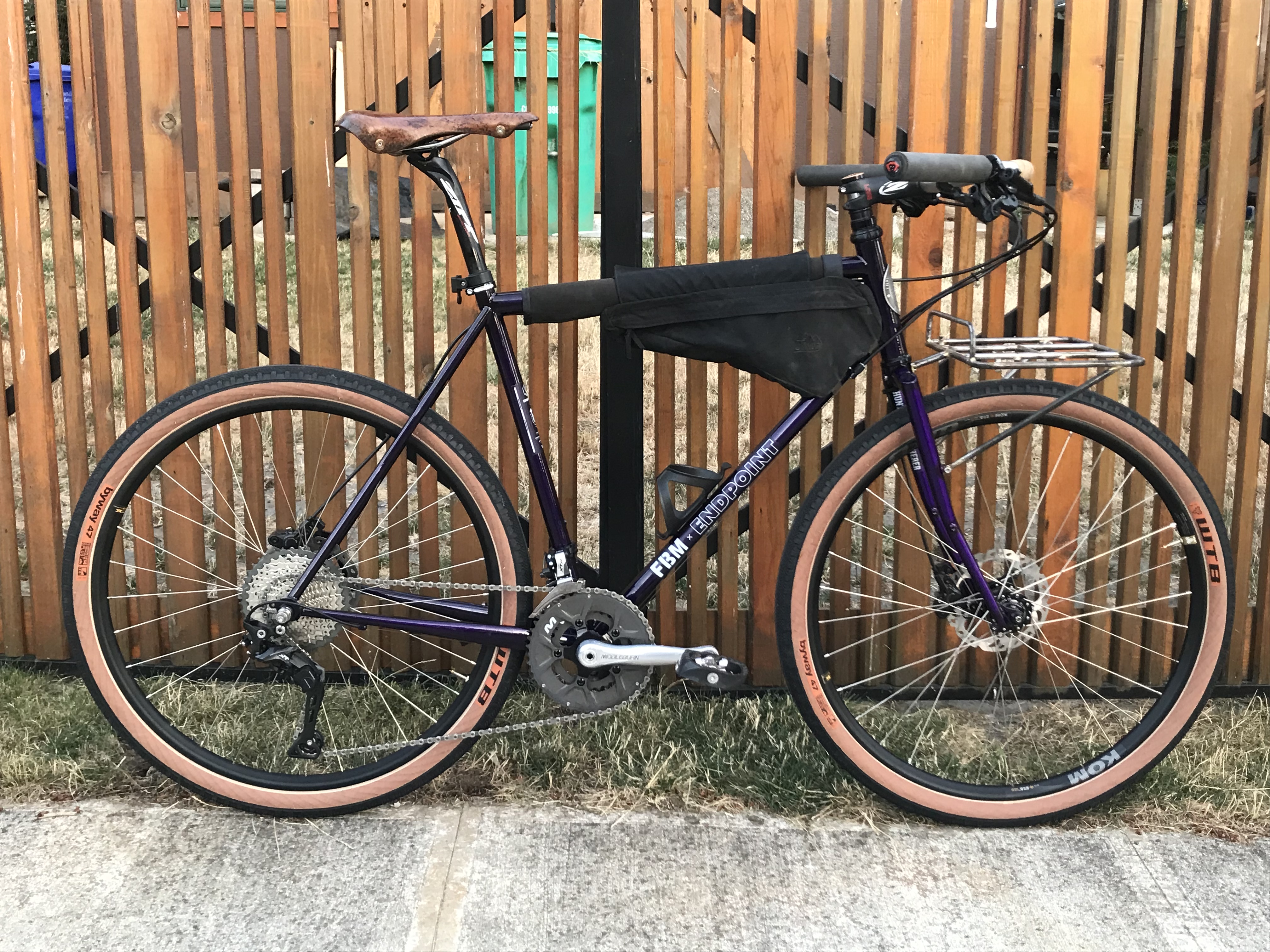

I’ve posted this photo but since then I’ve added an iq-x, different saddle, dropper and some fenders. I’ll try to get something scenic this weekend
We’re absolutely going to need to see a photo of that!
same, 650b Horizons fit albeit tightly

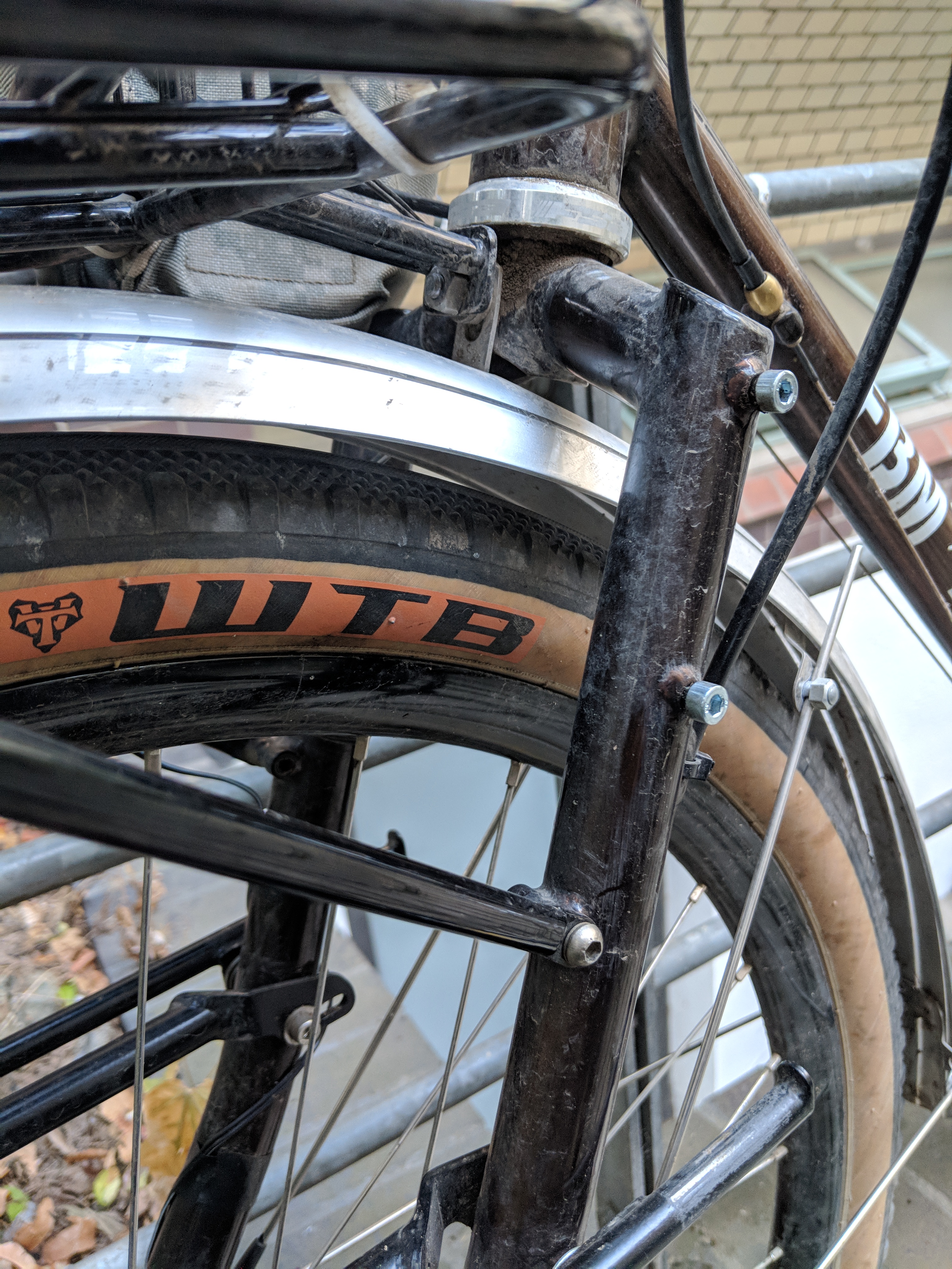

The problem on the Coffee Grinder is the clearance on the rear, I think.
It gets quite narrow at the brake bridge, so trying to squeeze a wide fender in there would require a significant amount of fuckery.
