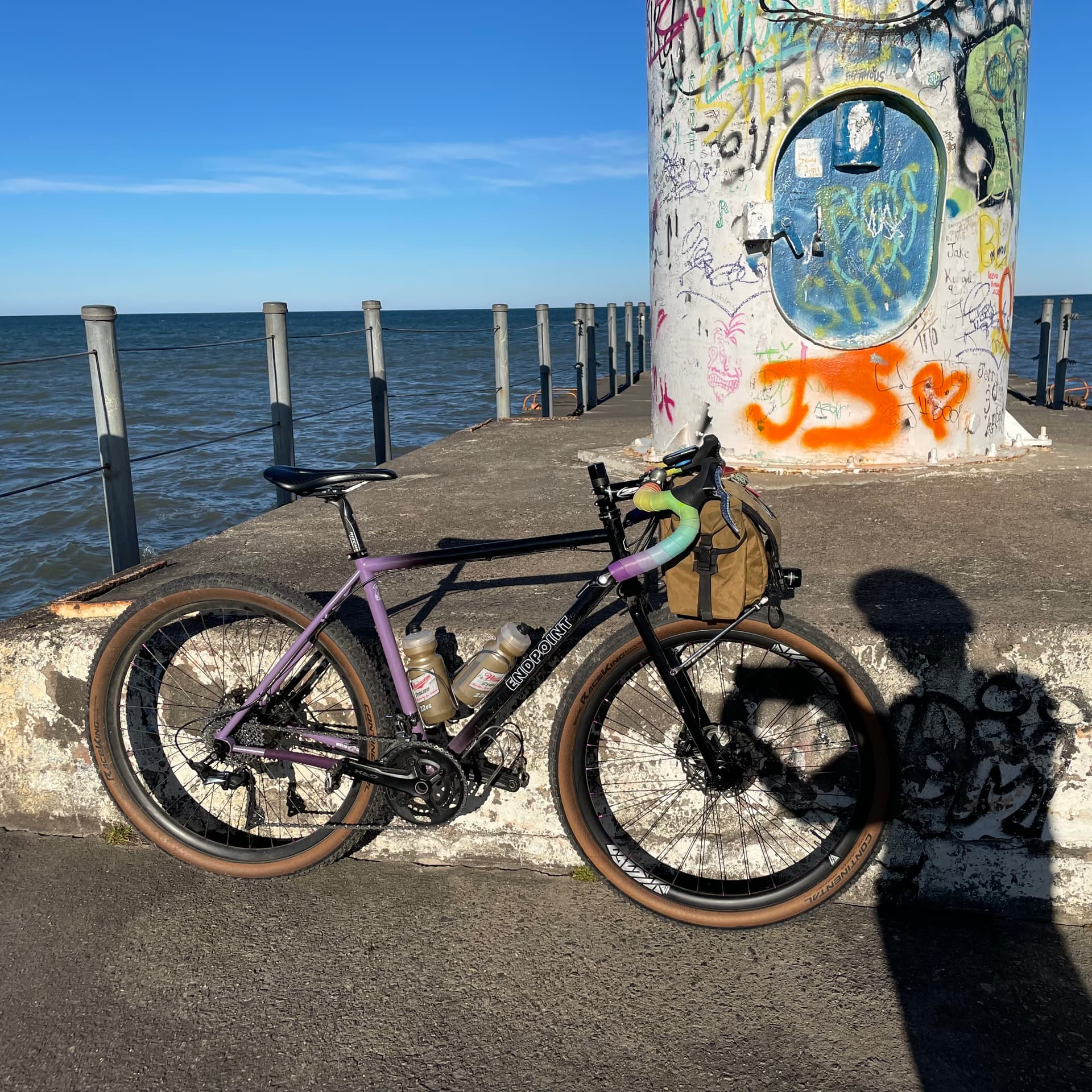

Can’t take a photo of these bars that doesn’t look dumb but they do be comfy
300mm
