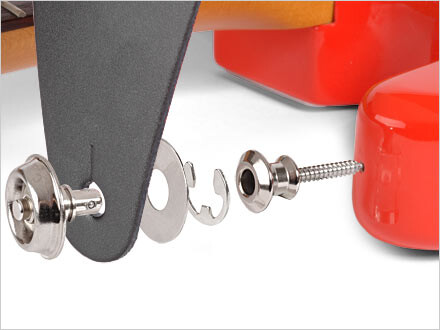

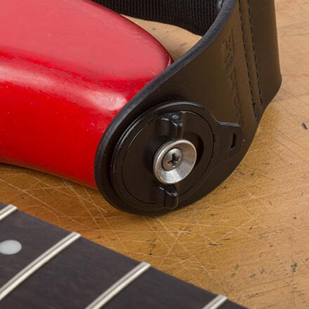

“guitar strap quick release” seems like another interesting category of hardware to dither with
push button release with a big gripping area:
this one locks/unlocks by turning the tabs 180 degrees
Oooh, nice find! That top one reminds me of some 2-part keychains that use a similar ball-lock pin, but that guitar stuff comes ready-made to be mounted with screws.

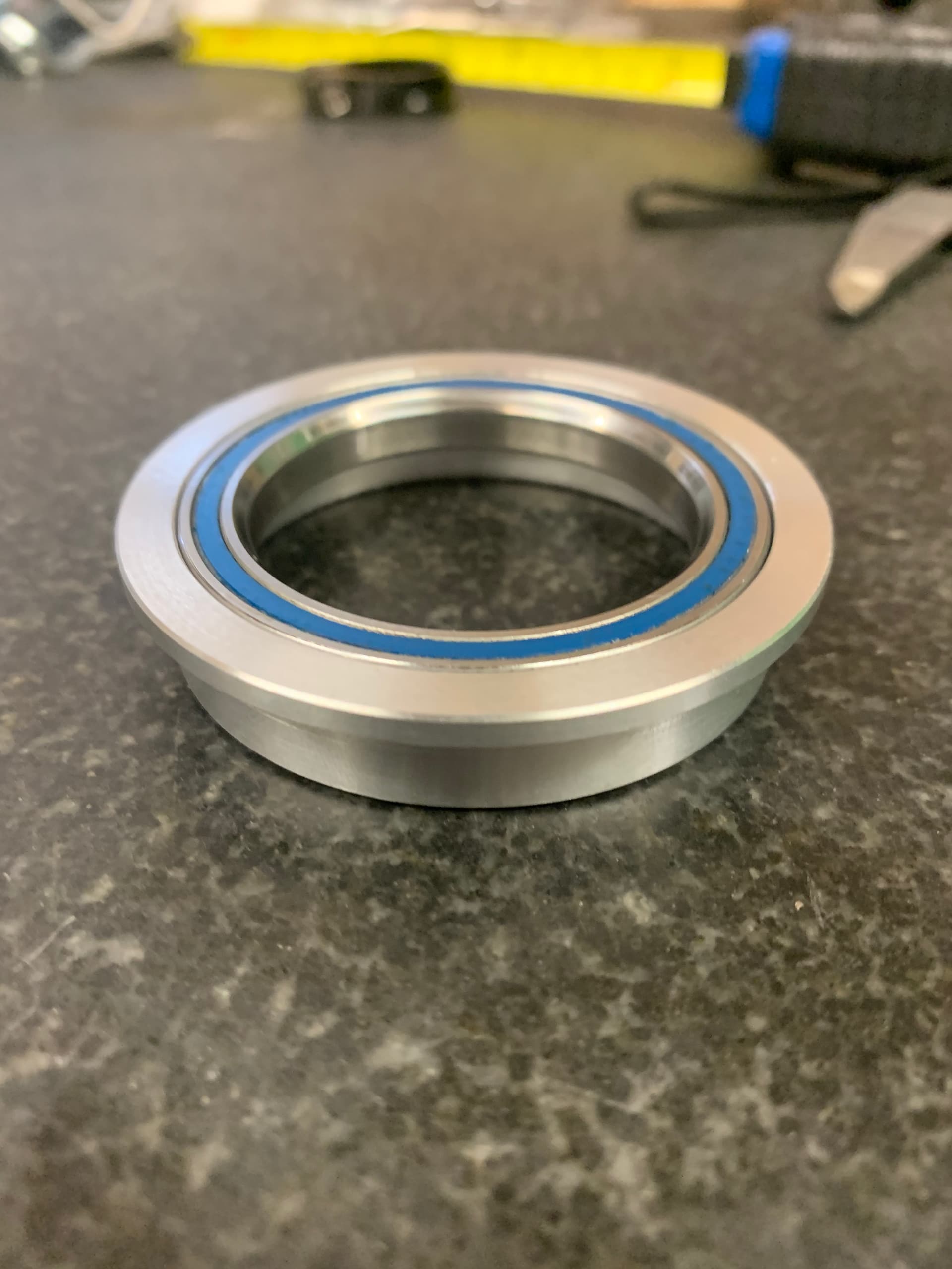

Helped out a local shop with a weird compatibility issue. Kona jake needed a new fork and the new fork they got with an integrated crown race fouled the CC40 ZS56 cup. I turned a custom cup that seats the bearing closer to the edge of the cup.

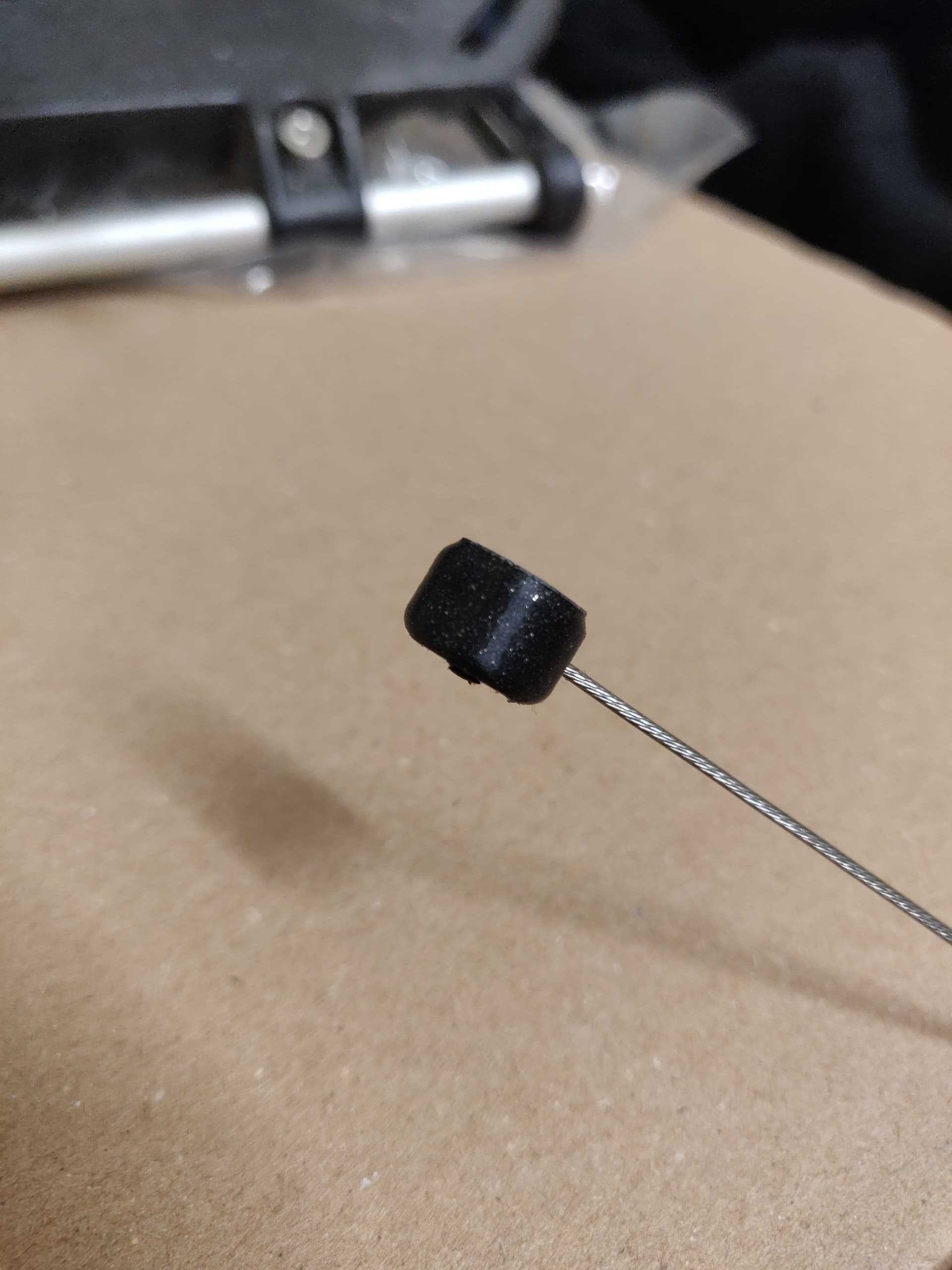

Printed the first iteration of my latest simplism, mon-cheri
After a bit of fandangling I’ve decided to make them all smaller with bigger cable holes, I’m already 8 frayed cables deep goin into this.
