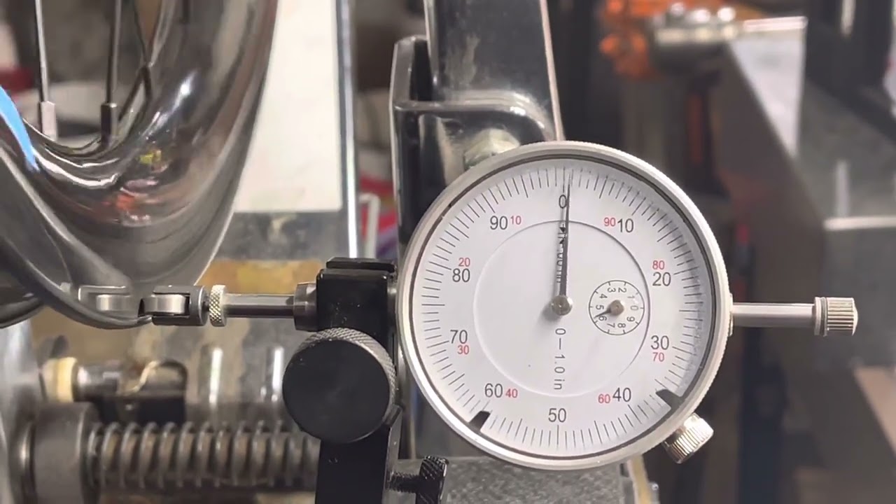

These wheels are going together nicely:
First time using Sapim HM washers and they make for easy adjustments.
LB WR35 650b 32h to DT350 with Sapim Race 2.0/1.8 and brass double-square nips. Gonna be perfect for under-biking.
