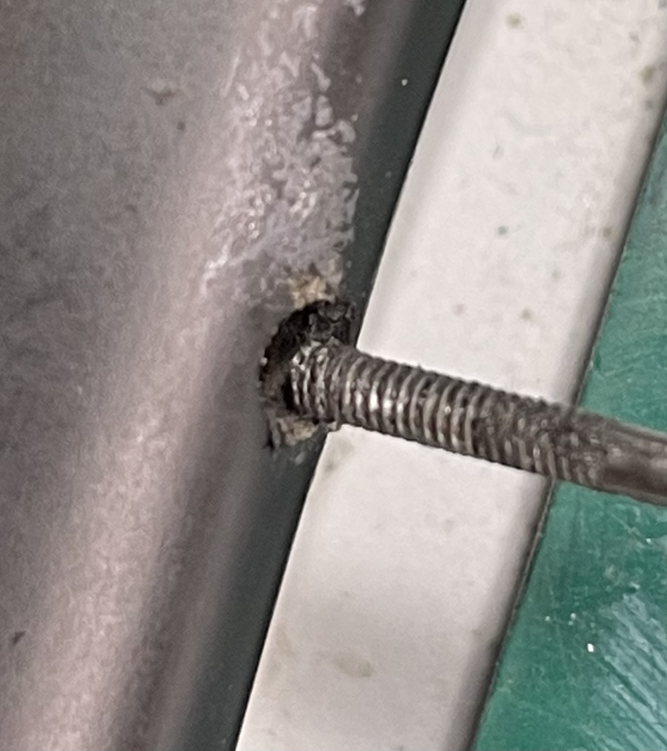

I’ve built several sets of LB rims using advertised numbers and ended up with “minimum length” spokes.
Here’s a close up of one that is waiting to be rebuilt:
I’ve just removed the nipple here, the spoke has no tension, and the end of the spoke comes just to the bottom of the nipple seat, which is as I described “minimum length”. With some tension, it would extend a bit further beyond the nipple seat.
If the spoke doesn’t protrude through the seat sufficiently, it could tear the nipple in half, which is something you’d notice or the wheel itself wouldn’t hold tension. Building a couple wheels like this and having the spokes almost come up too short led me to figure out that LB publishes the diameter of the nipple seat and adjust accordingly.

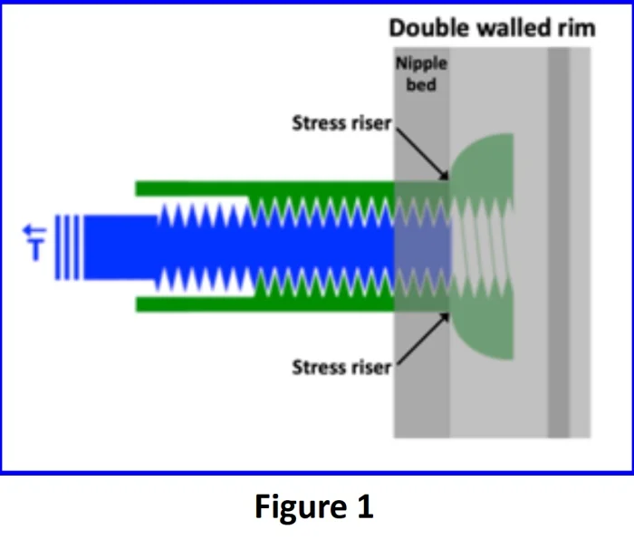

For one, I built these wheels. I presume LB uses correct length spokes. For two, Lennard Zinn made this handy diagram:
This is how long my spoke is without tension. It grows by another mm when under tension. Zinn created this diagram to demonstrate what happens with aluminum nipples, brass are a fair bit stronger, which is all I use. Finally, the failure mode is some broken nipples, which is not catastrophic. This wheel has >5k miles on it and lots of hard abuse and had no issues. I cased a bunch of things really hard with this guy eventually sufficient to cause the rim to fail and the nipples were fine.

I see what you mean. I’d offer two things: the first is that if you haven’t seen nipple failures over the years, then you’re fine. The second being that if you used normal nipples and not double-square or squorx, you can peek at the bottom of the nipple and see. If it’s a standard flathead slot, the nipple should come to the bottom of the slot.
It’s a trust but verify situation atmo.

more like 2mm too short. 4mm off on the diameter = 2mm off on the radius. See Heath’s picture and diagram about “minimum length spokes” above. It’s not catastrophic as long as you’re not using aluminum nipples, but it’s definitely not best practice.

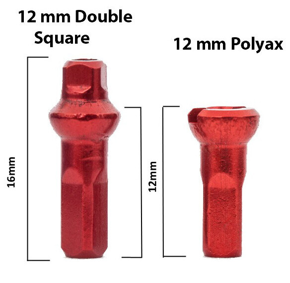

I’m back with more dumb questions. What do I need to know about nipple length? I’d guess longer is stronger, more thread engagement? Are any of them so long as to have to worry about running out of threaded area on the spoke, itself?

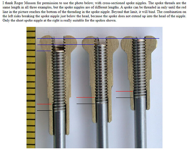

St. Sheldon to the rescue with this great image from Musson
I have always bought the shortest (standard length?) 12mm Sapim or DT Swiss nipples (or the “same length” 16mm doublesquare versions) because I’m not building on weird deep-section aero rims or whatever would require deeper nipples to have good access to the flats for truing.
And channeling my inner Jan about marginal gains: shorter nipples are lighter, and they’re out at the edge of the wheel where weight matters more (pay no attention to the fact that I build with brass nipples instead of alloy, no one ever said I had to be internally consistent). Never ran into any issues with this length of nipple.

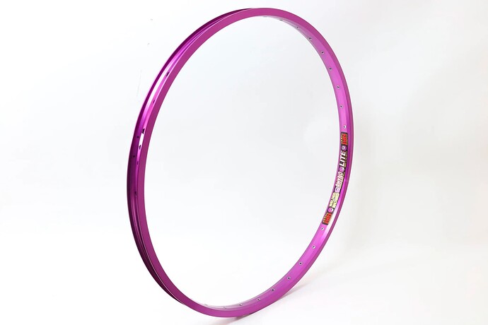

are these going to really suck with rim brakes? i feel like i’ve use the non-machined rhynolites with a rim brake before and not really cared.
it should suck the same amount
pretty sure those Rhynolite XLs have a welded joint and thus always machined, otherwise the truing would be horrible
