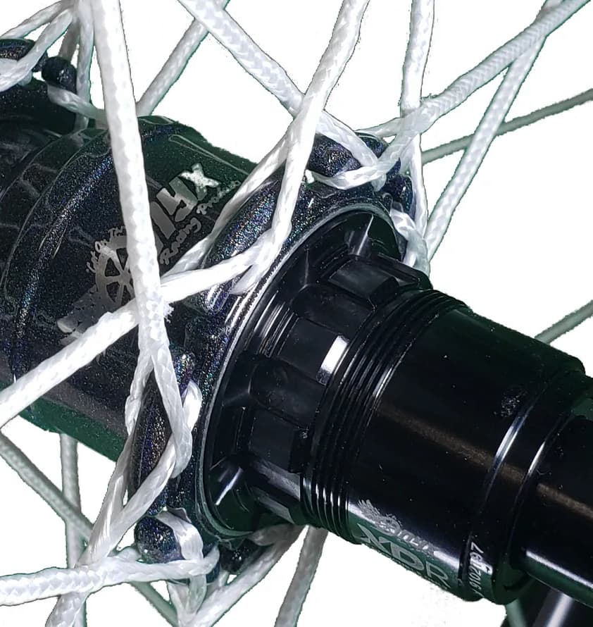

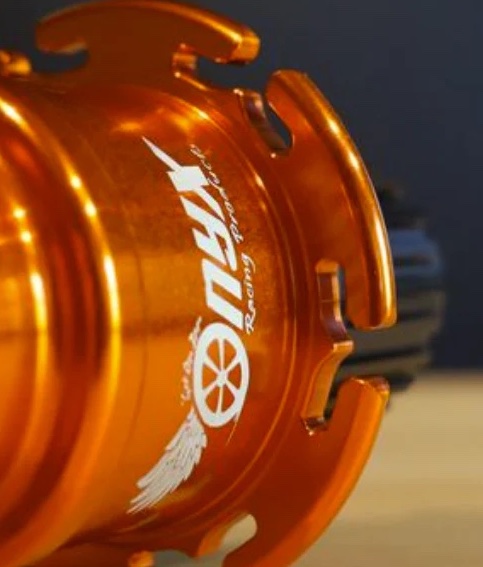

I’m a little concerned with this design. Unless I’m mistaken, do you still build the wheel to similar tensions to steel spokes?
If yes, that open flange says long term failure to me. I’d love to be wrong as I’d consider it.
Indeed, same tension or more. Here’s the open flange:
and the laced wheel:
Looks like there’s not much force on the open flange with these kind of spoke angles.
and Berd is confident that the spoke crossings wont get abraded over time?
I mean I’m sure they tested it, but gosh that looks sort of sketchy
feels less sketchy than having to hog out traditional spoke holes, which is part of their process for how your standard hub doesn’t cut all your spokes
I’m guessing there’s not much movement. Also, the fiber they’re using may be abrasion resistant.
