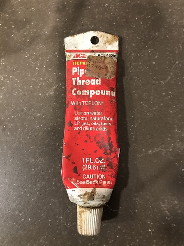

Should we use Phil grease or Shimano mineral oil for spoke prep? I’ve only used grease in the past.
For science, alternate to get a mix of both and see whether one loosens or gives you grief more than the other.
Neither! Jesus Christ!
Get some proper spoke prep stuff!
Like a foolish fool, I used Phil grease for years and switching to nipple cream made building so much better and easier to get that tension up there.
Dammit I should have bought some when I bought spokes. Looks like we’re not going to get around to it tonight so I’ll see if lbs has any…they definitely don’t tho. Will not be shocked if he tries to sell me wd40.
Edit: I will be surprised if he doesn’t try to sell me wd40
Teflon pipe paste from your local Ace Hardware Workers Collective.
Looks like I can get a lifetime supply from local marine supply store
I’ve used this 1oz tube for probably 30 years? It still has a price tag!
