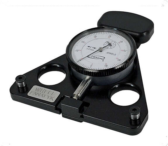

Tensiometer seems like a tougher one. There are examples on amazon for <$20 but I am guessing they are junk? Name brand versions all seem more pricey than might be necessary for my uses but I’m willing to be told it’s an investment lol

I have a cheap tensionmeter and don’t use it for hitting a specific number but just to see a uniform reading across spokes
you probably want a tensiometer for your first builds, but yeah a cheap one should be fine.

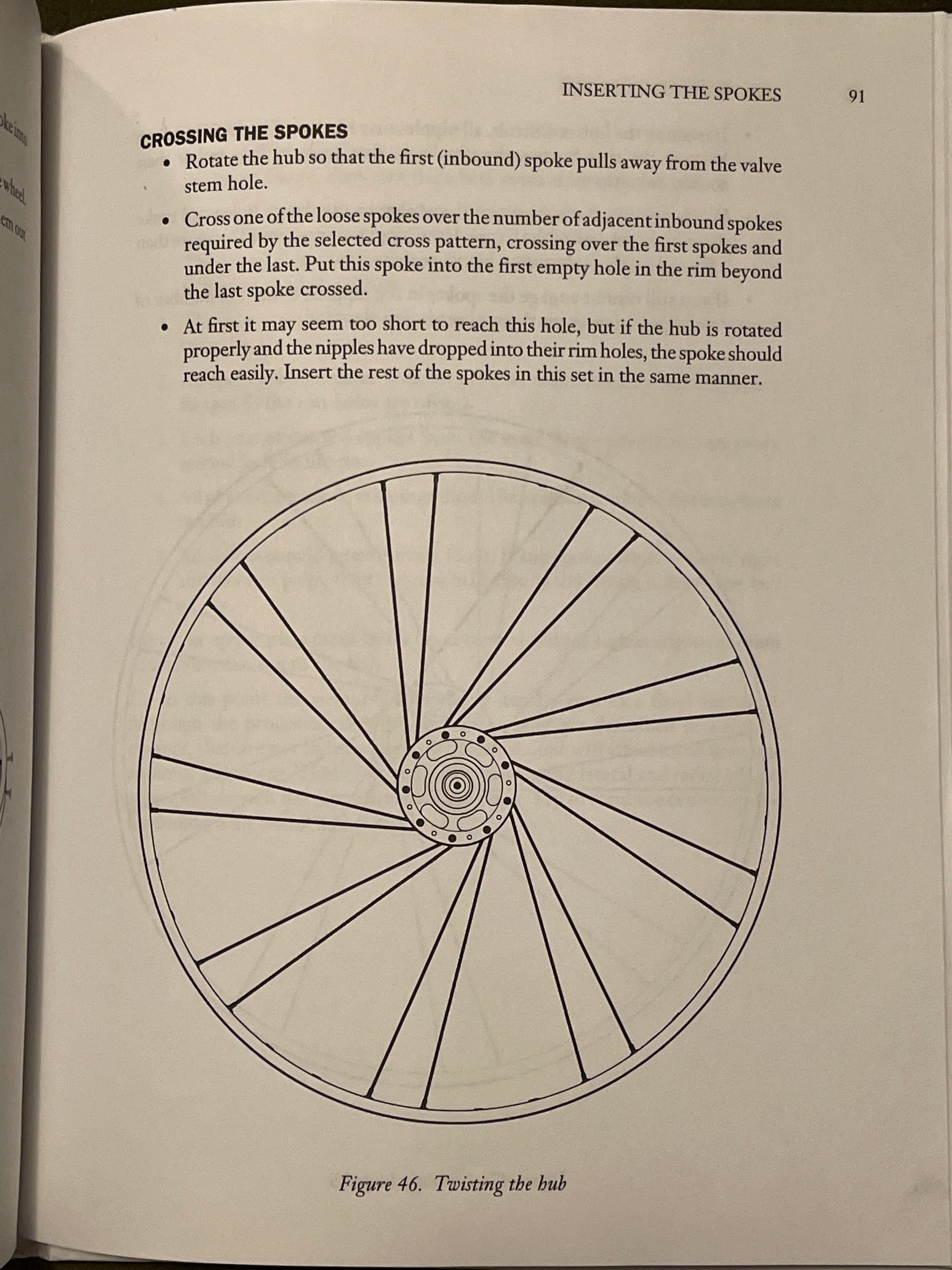

since this scan is missing page 91 (and I’ve given up looking for a PDF that isn’t), and it’s kind of an important one, here you go:
You know, I was doing a quick read of that section and there seemed to be a missing instruction for rotating the hub but I just thought it would make more sense when I was actually working on a wheel lol… Thank you!
Bicycle_Wheel_-_Jobst_Brandt_w.p.91.pdf (4.5 MB)
using the tensiometer is my least favorite part about building wheels. hurts my hand! i dunno if i trust myself enough to just rely on the pings though

the tricky part is you have to manuever the thing into a space between the spokes where it has free motion
i have one of these, except it’s the FSA carbon one
It’s marginally less annoying than the park tensiometer, i haven’t calibrated it ever.
