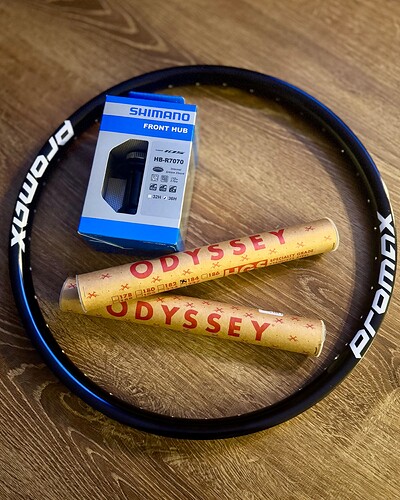

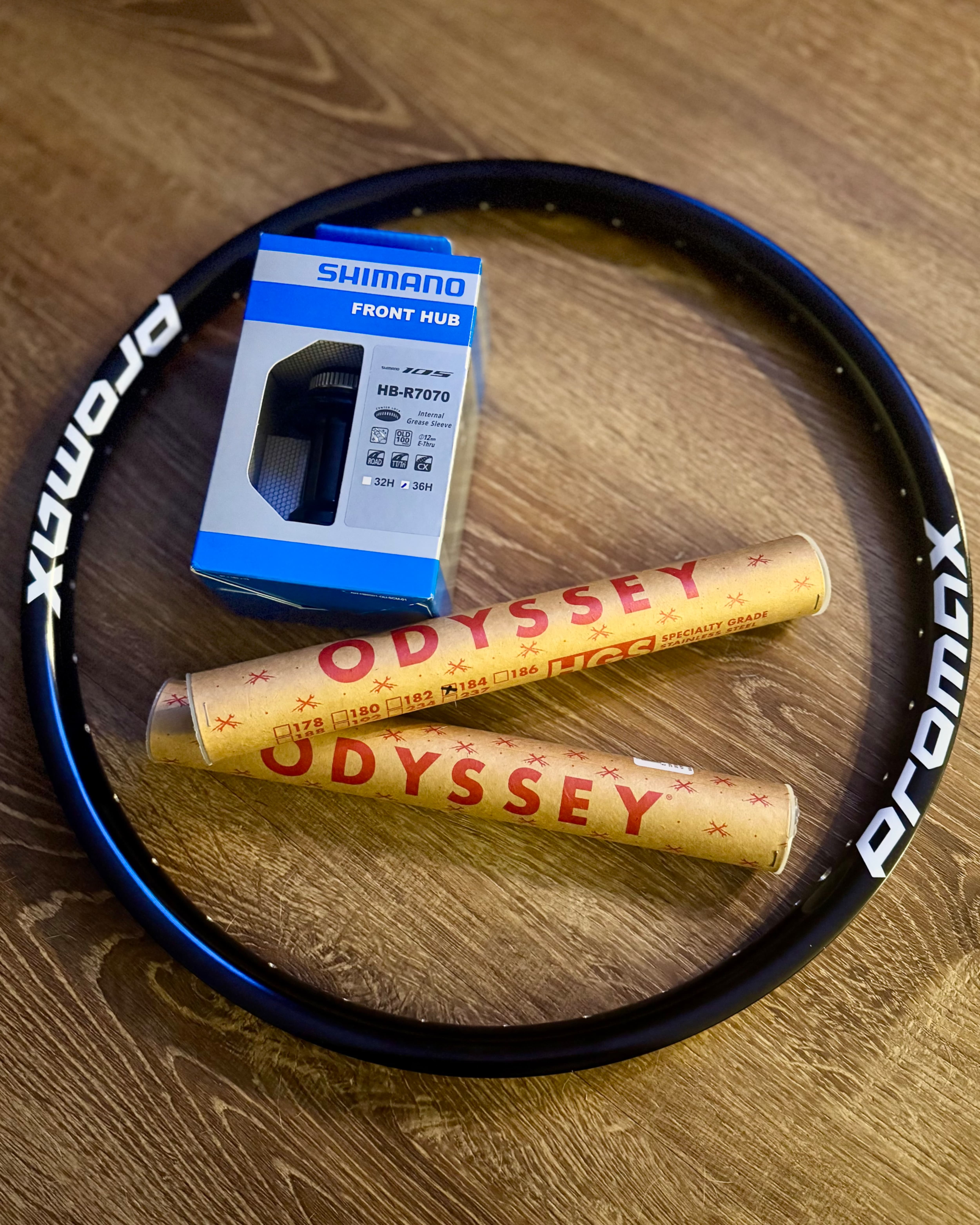

Edit: never mind, just ordered a cheap hub and spokes and I’m going to take the wheel apart and start over. Couldn’t find a replacement cone, couldn’t find a replacement wheel with tubeless, didn’t want to ride roached bearings or a new bike so all new wheel it is
Well what the fuck could I possibly be up to
Edit: damnit I bought the wrong hub
Yeah, it’s not a dynamo for some reason.

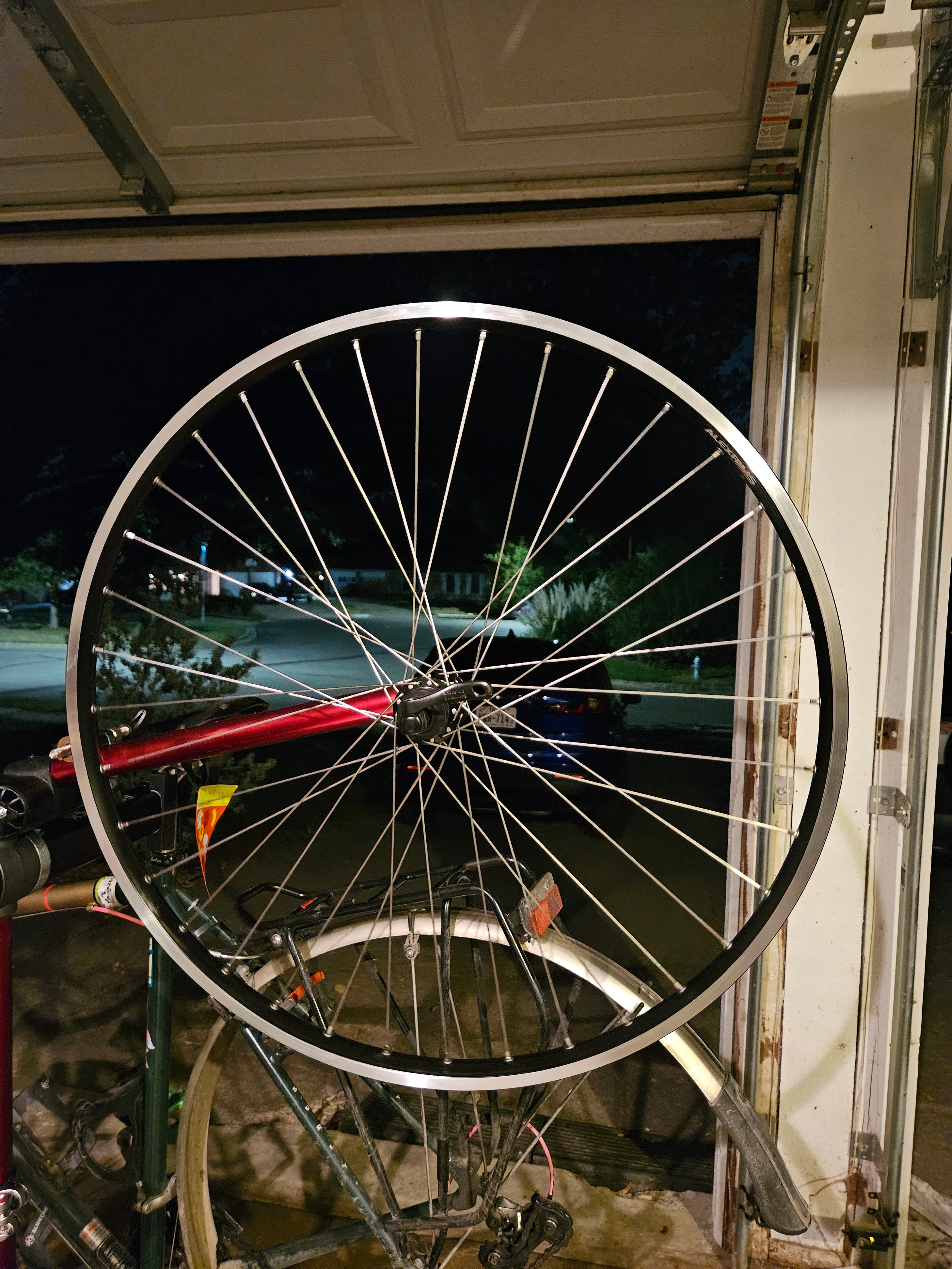

Okay I (might have) did it
Notes:
Lacing a wheel from nothing might have actually been faster than doing a rim swap because I found the nipples easier to manage shartmo
I think I had too much tension on the NDS to start, had to take some of that off to get the rim centered in the frame. The Feedback truing stand is kinda YOLO about the actual position of the rim relative to the hub so that didn’t help me much
I did a half mile ride around the block and didn’t notice any noises or other shenanigans. How long before I’m back in the asploded parts thread?
Overall this is fun if not time consuming at this stage. Want to build more wheels to get more practice but I’m the kinda bozo where most of the wheels I want are probably cheaper to buy built lol

probably a while dude- building wheels is cool and not super hard if you take the time and follow instructions. if you did that, they are probably going to hold up better than most machine built wheels you’ve had over the years.
i am not of substance but i have rarely had to actually true wheels i’ve built any considerable amount. even the early american velocity a23s i built, because one crash and it was just totally fucked.

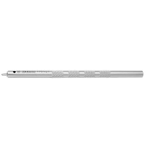

Regarding your nipples, I HIGHLY recommend getting a nipple grabber. I’ve had this Unior thingie for forever and it’s never failed me.

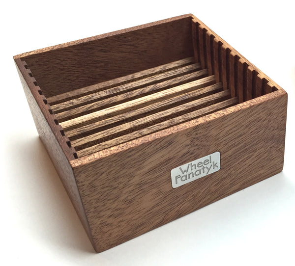

If you really want to handle your nipples luxuriously, get you a nipple shuffler. You can drip your nipple cream right into the tops of the nipples.
I may need a nipple grabber. I’ve just used a pick but it’s not great.
I got like a $2 3d printed nipple shuffler that’s great
