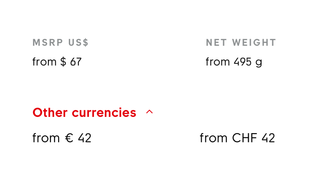

Any reason not to use a DT swiss R500 DB rim? It’ll be laced to a 142mm 32h 105 rear hub and run a 700x40 tire, I had really good luck with the R460 rims on my kids bike.
