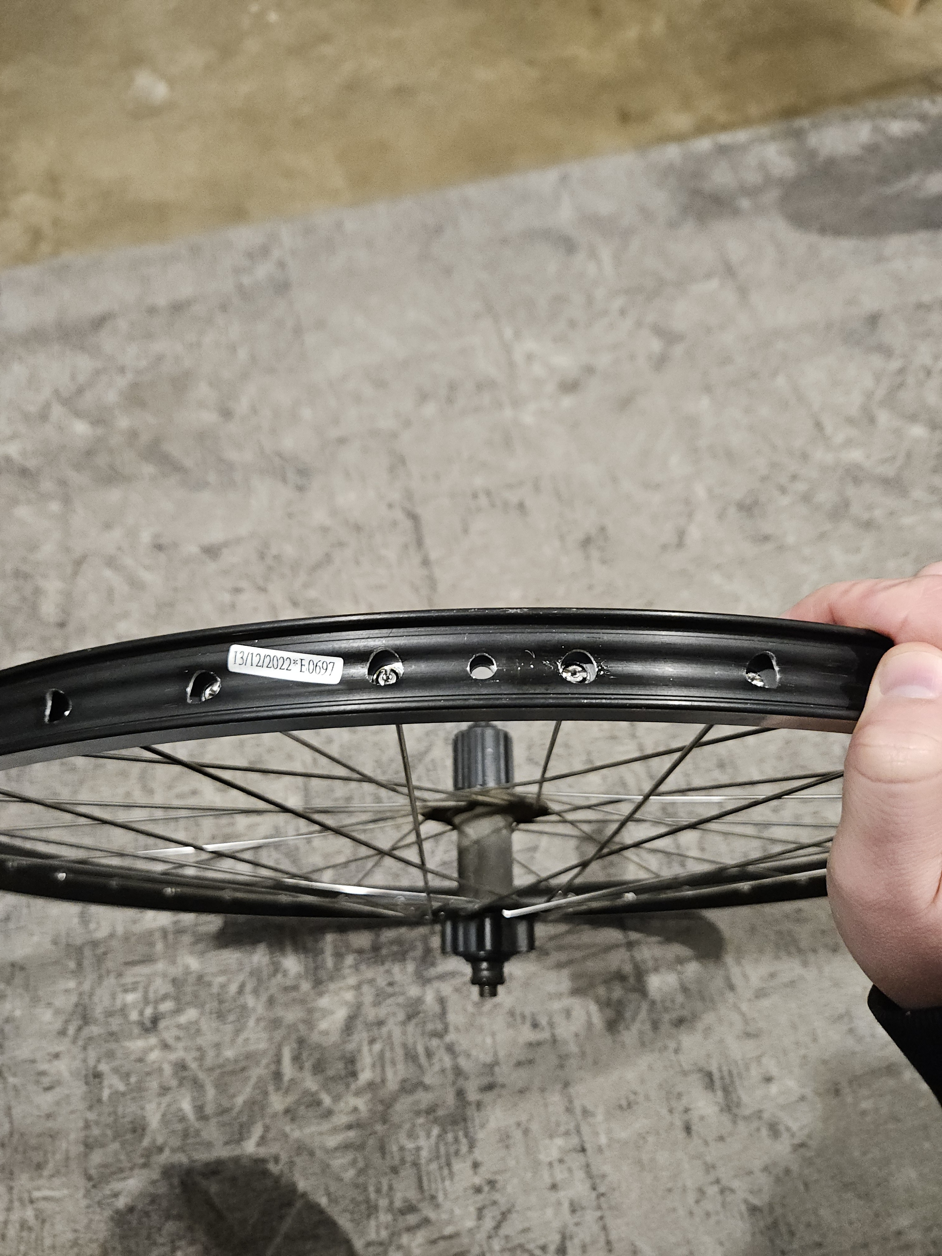

Welp I took the problem wheel apart, kept the DS and NDS spokes separate, and relaced it a la Jobst. All came together fine but after tensioning I am still showing a thread or 2 on pretty much every spoke. I don’t think I’m being a wimp about it either, they all feel pretty tight. In one way this is an improvement since I feel like it’s more even but I still don’t think you are supposed to be showing any threads at all lol.
Thinking maybe I need to run the spoke calculator and order some new ones since I have had that work for me! But also interested to hear any more ideas. This is just to be a backup for my cargo bike and it is tempting to just order another $150 complete Cliffhanger wheel off of Universal and call it a day but I am going to be Wheel Builder
My guess is ERD variance, I wouldn’t put it past Alex’s QA to be off a couple mm’s in either direction.
Measure the ERD, run it through the spoke calc, then compare to your current spoke length.
I fucked up the spoke calc on my pub wheels and I’ve got threads showing but I’ve been rocking it for like… 2-3 years on one of my most ridden bikes and haven’t had issues?
If it wasn’t the bike I ride around with my kid on I would probably do a yolo trial but the last thing I need is this wheel to explode 5 miles from home while I’ve got my daughter with me. So maybe it would be fine but I’m trying to exercise a little caution
I’ll check the ERD. The Alex website says it should be 538.8mm for the 26” rim. The QBP website says it is 541.5 mm. Treefort website says 540.5 mm. I haven’t shopped enough wheels to know if these are normal discrepancies among available numbers.
Edit: ok I went out to the garage to measure the ERD. I don’t really trust myself to do this real accurately but I used the bumpers on my dishing tool to make a measurement and the new rim was somewhere around 535-540, probably about 537-538. I checked the OEM wheel and the ERD on that rim was like 530-535. Also forgot I had the OEM cracked rim, that one also appears to be ~530-535. Like I said I don’t trust my measurement within a couple mm but that’s more than a couple mm. Mystery probably solved.

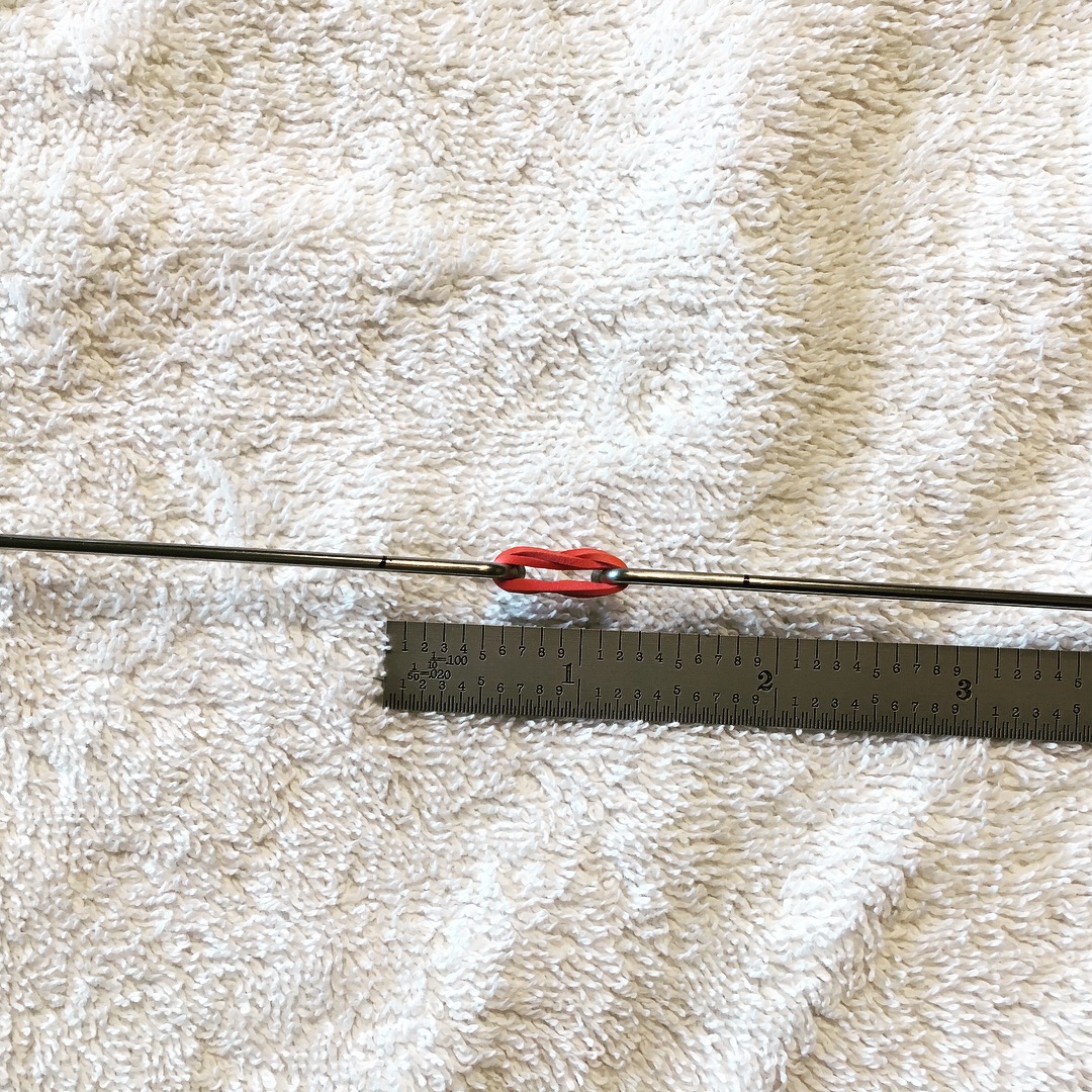

The way I was taught was to take two spokes of known length, thread them flush into nipples in opposite holes on the rim, pull them fully into the rim, then measure the distance between them and add the spoke lengths. Repeat at a couple other points around the rim and take the average.
You could also make custom “reusable tools” by cutting the spokes to an even length and then using thread locker to keep them set in the nipples.
I just got home from a ride and my partner was in the bike dungeon doing this
QBP sold these little “rim rod” plastic sticks with stoppers which always worked great
I’ve done something similar, except with marks on each spoke and a small rubber band for tension. Measure the length of each spoke to the marks, then measure between the marks. Just be sure to measure on the same side of the marks if the marks are wider than just a scribe line.
