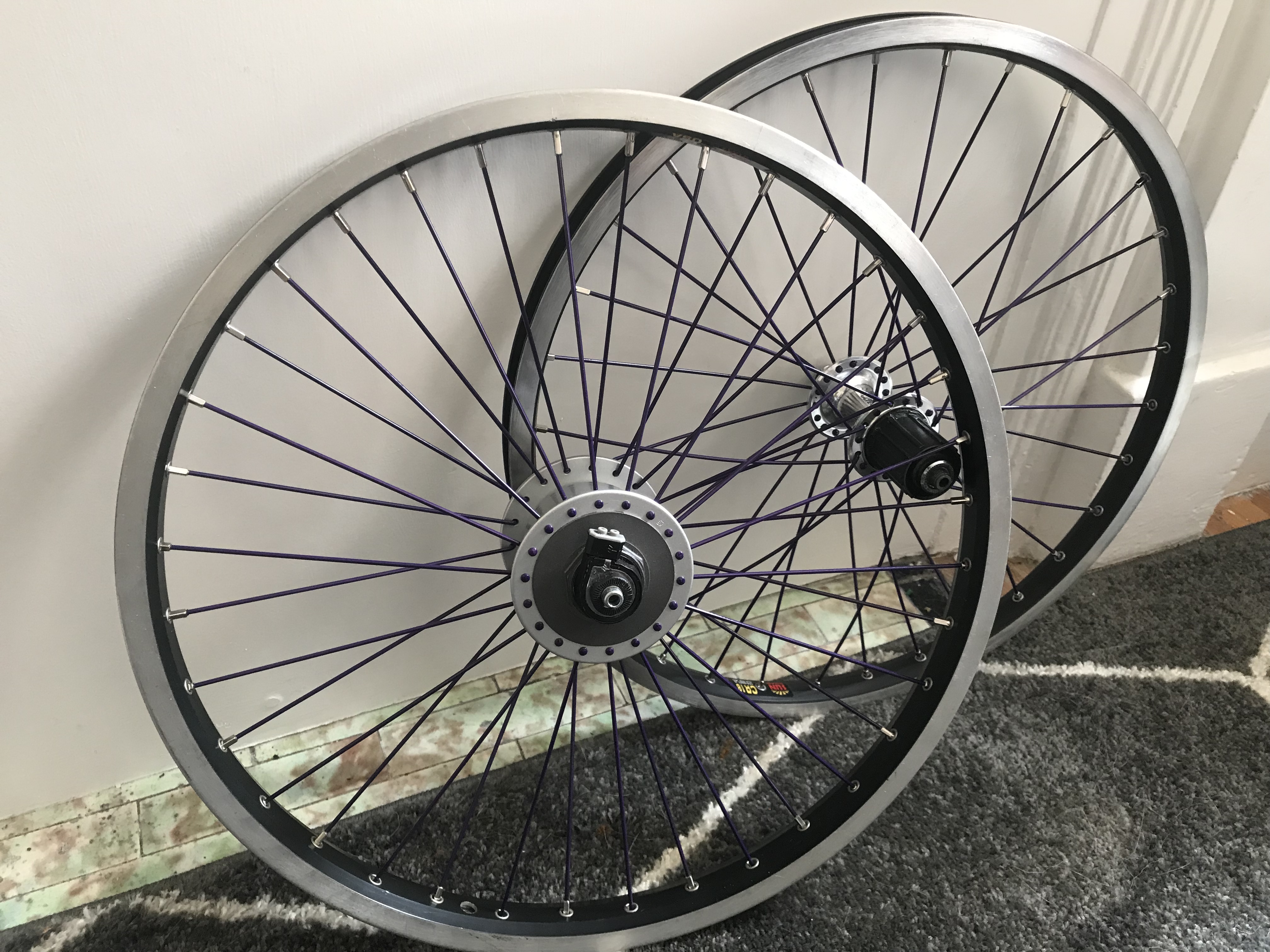

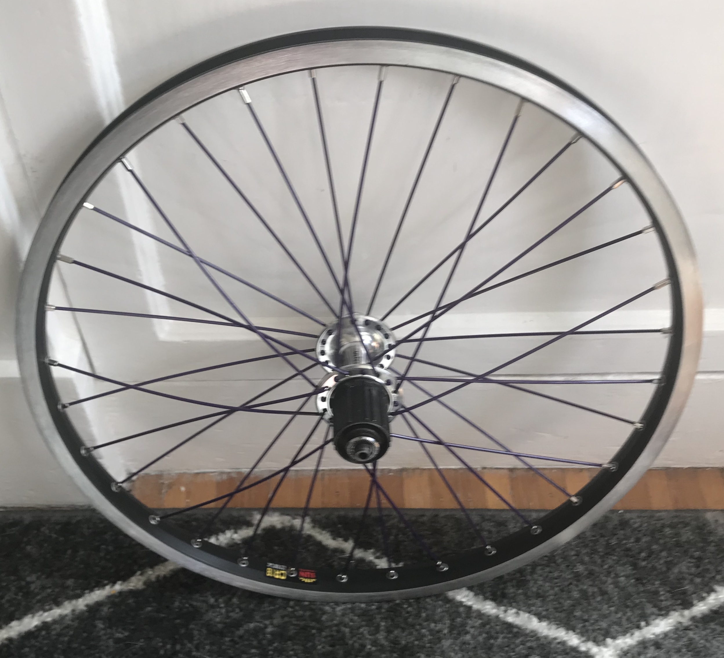

I built a little 20” wheel from sickbed today

Finished lacing the set.
“Do these rims make my dyno look big?”

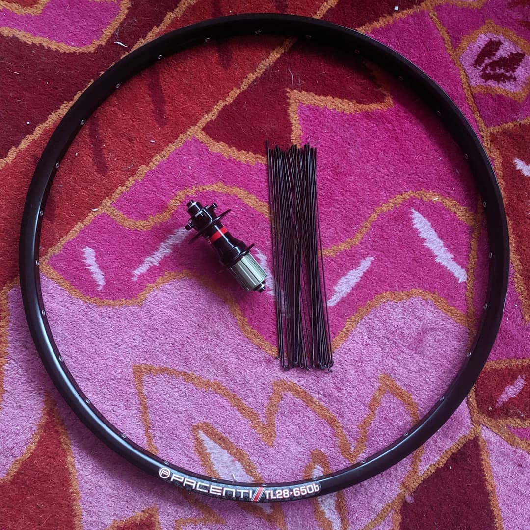

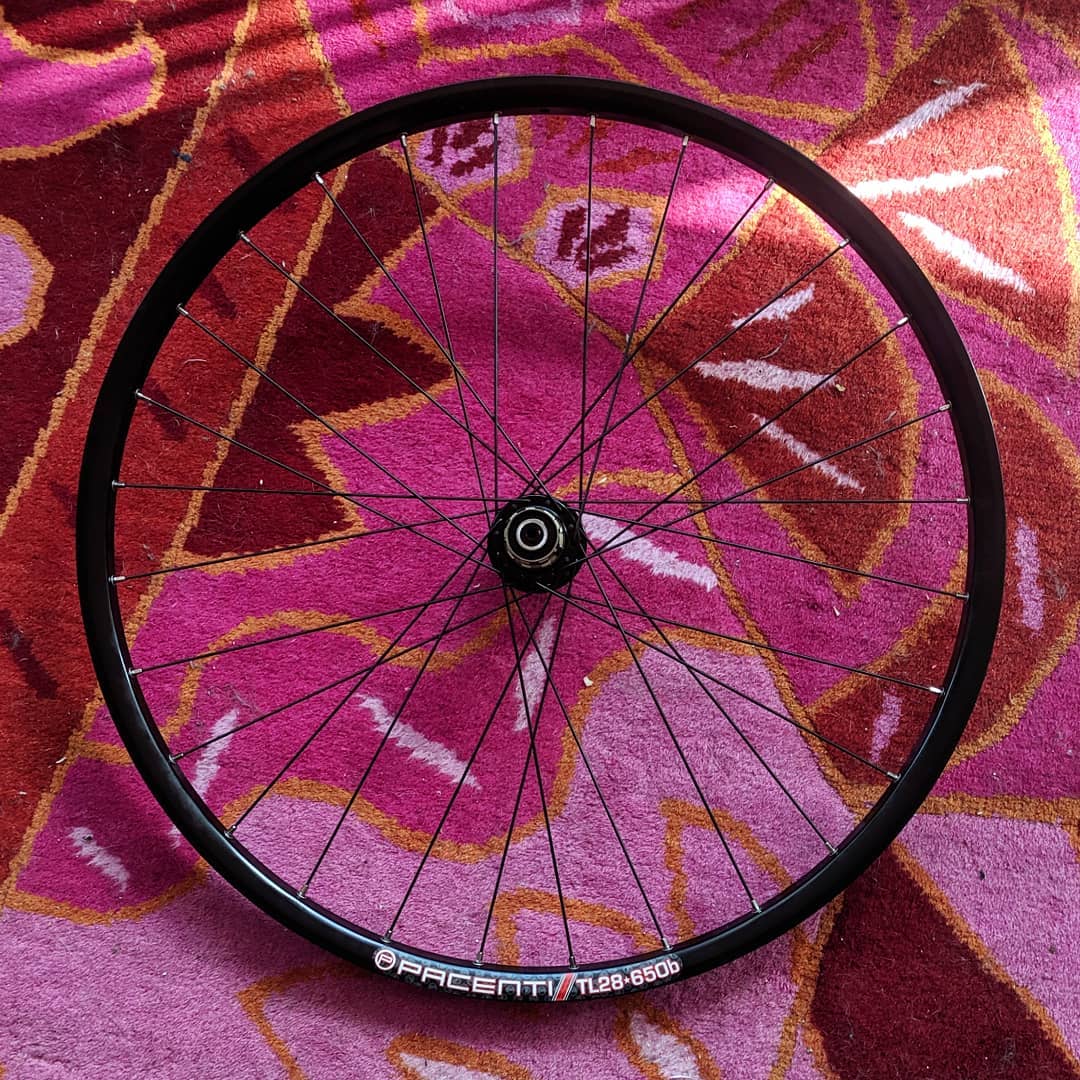

Really my strangest wheel build yet, 3x 28h to the “deadender holy grail” Novatec D722SB: 130 OLD, 11 speed, disc hub, 9mm qr.
My kinda wheel build

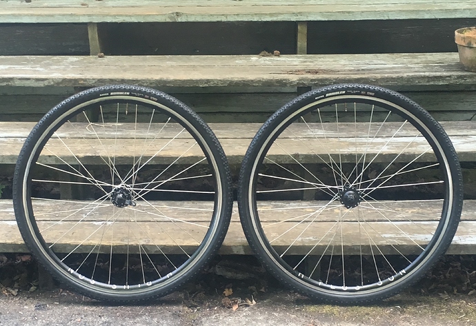

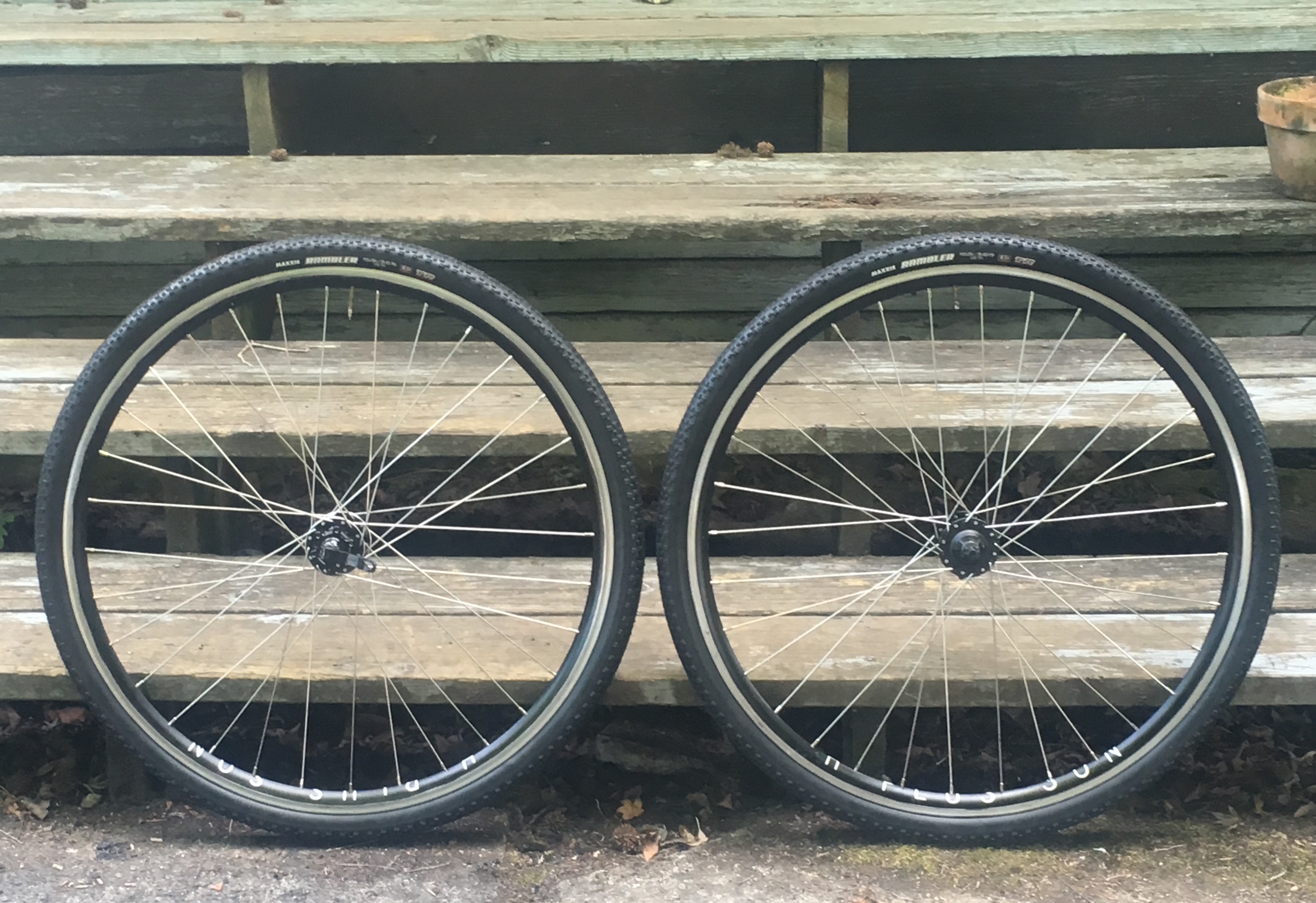

I needed to build a pair of 700c disc wheels for updating @Rusty_Piton’s Traffic to a disco machine; I bought a pair of disc hubs at the community cycling center, a pair of Maxxis Rambler TL tires from a bikedirect link in the Deals! Deals! Deals! thread, reused the Archetypes I retired years ago (they were retired because their brake tracks were not up to the sort of gravel roads I go wandering down to get some variety on the way out of town, but with disc brakes that’s not a problem), and scrounged spokes from my big pile of used spokes:
These wheels took an embarrassingly long time to lace up. Tubeless? Fuck no, these are sizing & test drive wheels, and I don’t want to have to deal with the tire goo drying up when I go a year between projects that require 700c wheels for sizing.
I can’t believe you scrapped together a set of wheels. Especially the used spokes part. That’s impressive.
