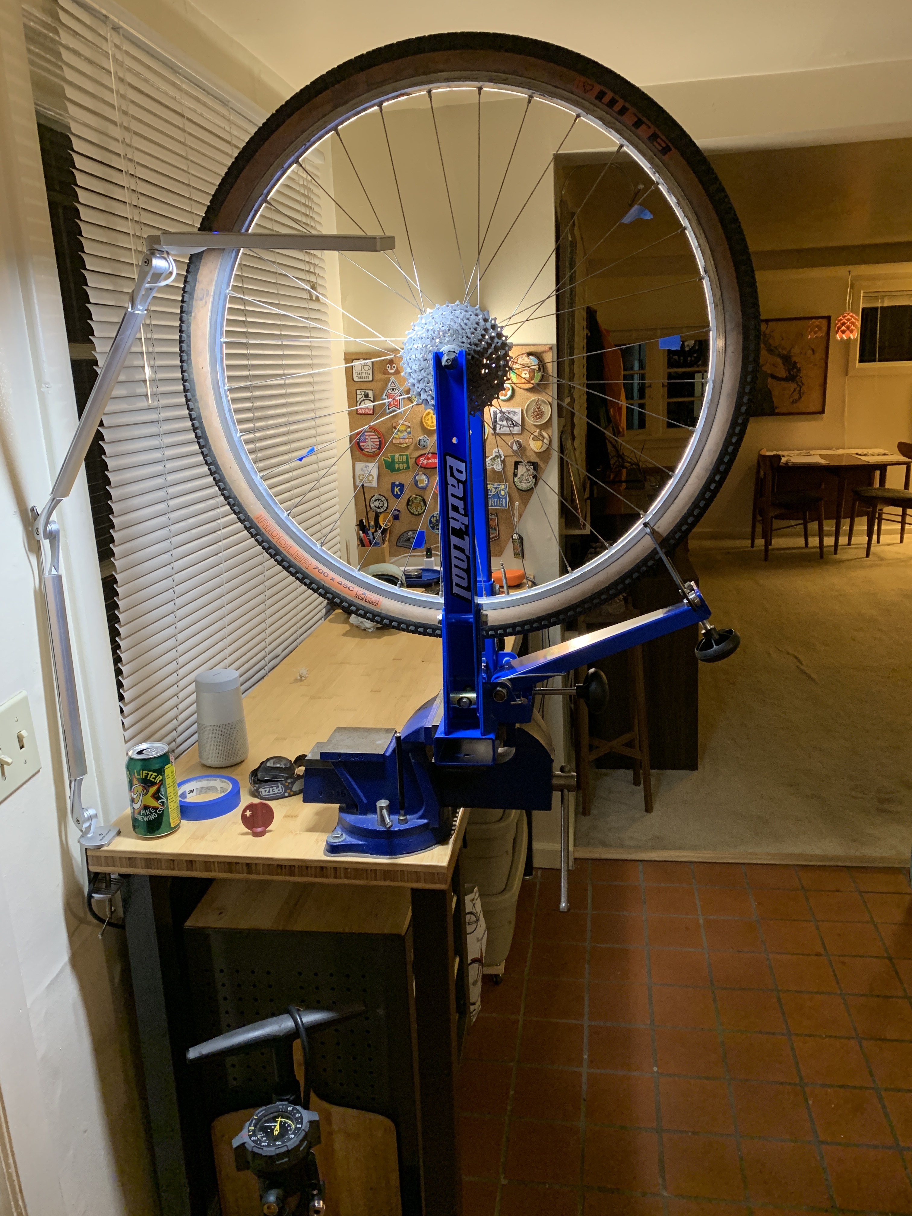

Sup backed out of driveway with bike on trunk rack right into a parked car, knocked her brand new wheel way outta true. I fixed it mostly by strategically slamming it on the ground. Tiny bit of fine tune with spoke wrench. First time trying slam technique, can’t believe it works.
It works, but for how long? Slamming a wheel is a trailside fix, something you can do to get to the end of the ride. I wouldn’t be surprised if that thing starts breaking spokes after too long
Kinda depends on spoke tension afterward and whether any of the spokes were stretched to yield.
Good point, the slams were relatively gentle so hopefully didn’t do too much damage.
Is the proper way to fix to detension then retension?
The proper way is to replace the now partially compromised rim.
That’s probably going to be a hard sell for her. Thanks for the feedback.
I think I oversold the “way outta true” and “slamming” in my first post.
Wheel was slightly wobbly and I performed a gentle hit on the carpet (with tire mounted) to get it 95% back to normal.
furthering your gentle boyfriend course of action, just collect evidence:
look closely for a hop
and run a tensiometer over all of them to look for outliers
On the other hand , if you need to rebuild it in 2 year vs 5+ years what’s the big deal. Just fix it until it works fine and then replace the rim/spokes finally when you need to.

  1. trueness of the hub flanges after a significant rim warp event
  2. integrity of an aluminum rim after a warp event
it may last for years, but it could also inconveniently fail sooner in a number of ways. the safe thing to do is at least re-lace to a new rim with new spokes, and eyeball the flange runout in the process.
