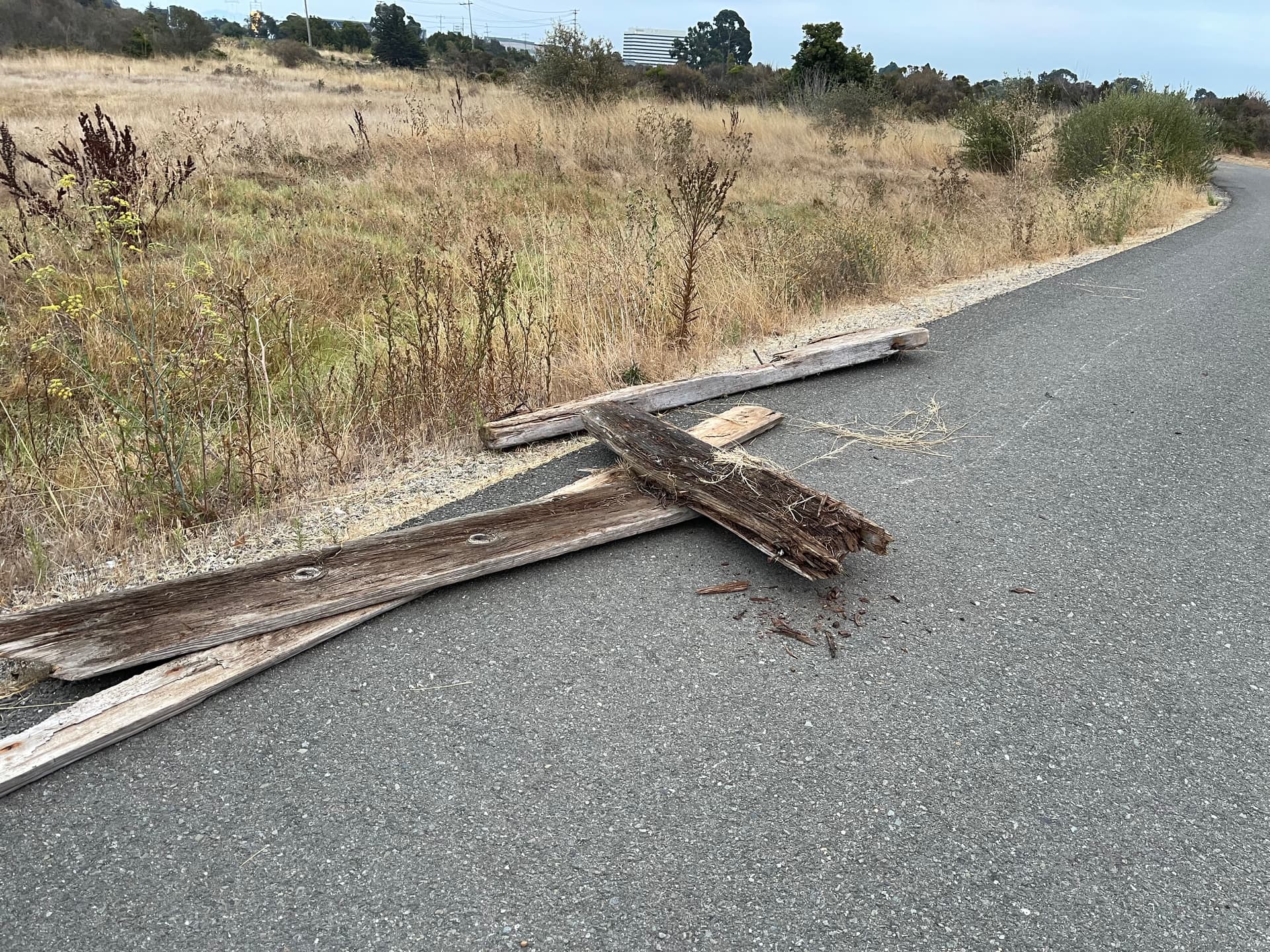

Oh hey, my AR56 from light bicycle died inside the 3 year warranty period.
They did have 8000 miles on em and cased more badness and lived beyond my wildest expectations. Couple weeks ago on my morning ride on the empty mup I was railing around well known turns and absolutely smashed this without noticing:
I was sure I’d broke the wheel from the sound but it looked fine. Few rides later on a long descent the wheel stopped holding tension and began rubbing. Upon closer inspection, it was done.
So, new rims time.

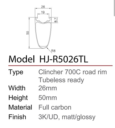

Looking for hub recommendations. Building up some 50mm carbon rims I sourced from parts unknown (wheel manufacturer has unbranded stock). $360 shipped for rims only
looking for best value recommendations on 24h disc hubs and spokes
