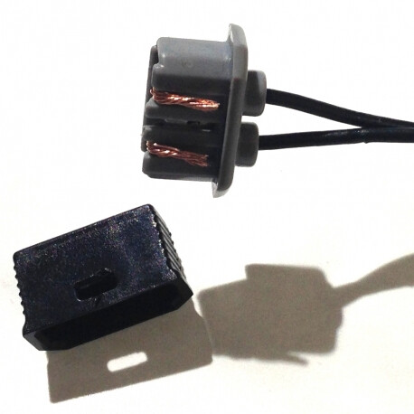

Another strong no here, the wires are held in by the connector. They would only come out with a VERY firm tug.
Maybe this connector is out of spec then, or the wires are on the smaller side, cuz these were loose as hell and slipped right out with the slightest bump.
Maybe I worry about nothing too much
Are you putting it together correctly? Wire goes through the holes, exposed wire bends over the inner part of the connector, outer part slips over and holds everything in place?
I’m sure there are pictures someone can share.
edit:
I’ve put a small amount of hot glue around where the wires enter the lego piece. Not sure it really did much but it didn’t seem to hurt anything.
Yeah, just like that. I figure the budget light came with fairly small gauge wire
/shrug
fourth no
I asked the same thing a while ago. There is not really any good place to do it. It is a little fiddly. After you play with it a little it works. I left my copper long and hanging out of the clip until it was all together and then clipped the tails
i also did this and has been fine for ~4 years
you can pull the connector out by the wire if you want, it’s not a concern
