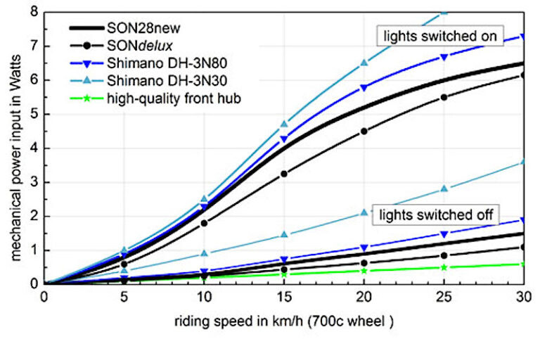

Someone here correct me, drag on a dyno hub remains pretty low when not in use (light on, charging etc), and increases (albeit slightly) once a load is placed on it?

Outside of spinning the dyno wheel in the stand I don’t notice any drag at all fwiw but yeah there’s supposedly a small but measureable difference with the light on vs off.
Should be about 5w of drag. SON 28 shows 6v, 3w printed on the hub body. Claimed 60% efficiency, IIRC. 3w is 60% of 5w, so there you go. Less drag with light off.

I’ve measured the current draw of the IQ-X E front light on my ebike at 6.3W, not sure what the rear light adds to that. That matches up pretty closely with the SON28 with the light on at 30 kph in the chart above. Say you’re only tootin’ around at 20 kph on that ebike, that’s only about 1.2-1.3W more than the same hub.
