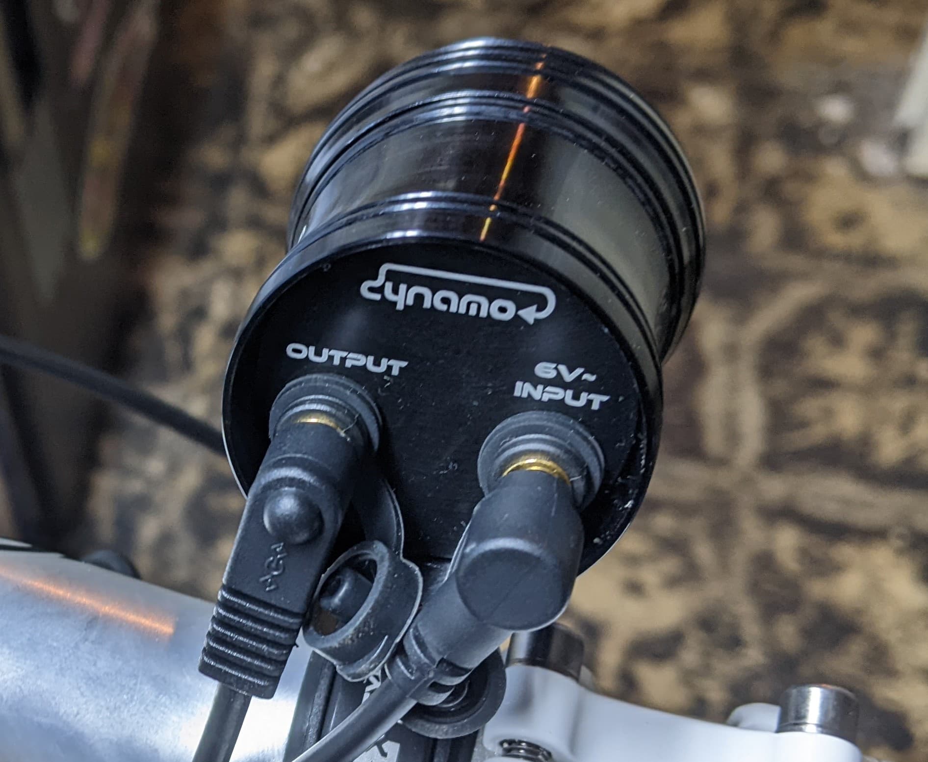

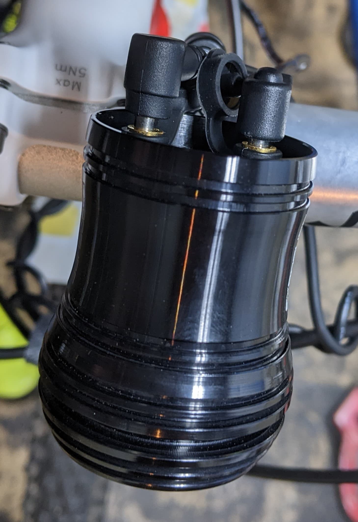

Anyone use the Exposure Revo? I got a deal on one from Pro’s Closet. It works, but in my 10-15 minutes test ride just now only 2/4 LEDs illuminated. They’re the two lateral ones. No action from the top and bottom.
One thing that seemed weird setting it up was that the wire plug from the hub to the lamp doesn’t fully insert. The one from the lamp to the taillight is a bit shorter, fully inserts. Maybe it’s fine and you just have to ride farther/faster to get them all lit?
Maybe there’s shmoo in the plug or you need to push significantly harder
I pushed as hard as I dare, looked inside carefully with a light. Kinda wondering if I just have the wrong connecter. Seems weird to design it to stand proud like that.
We’ll, shit. From their FAQ:
"Why do 2 of the LED’s on my Exposure Revo appear not to work?
When using the Revo the horizontal LED’s will alight after a short while riding and the vertical LEDs will come on soon after. As soon as you stop riding the vertical LEDs will go off and the horizontal LEDs will stay on in stand light mode until the power is drained from the internal capacitors."

OK, more testing has revealed the following. 2/4 LEDs is standard, they light up right away. After riding 5-10 minutes the third begins to glow. The fourth seems to only light for extended descents. I suppose lighting all four constantly would create more drag and be a bummer. The scaled deployment of the array is pretty clever, perceived drag is quite low.
The stand light starts as two but quickly fades to one. That one stays pretty bright, though.
