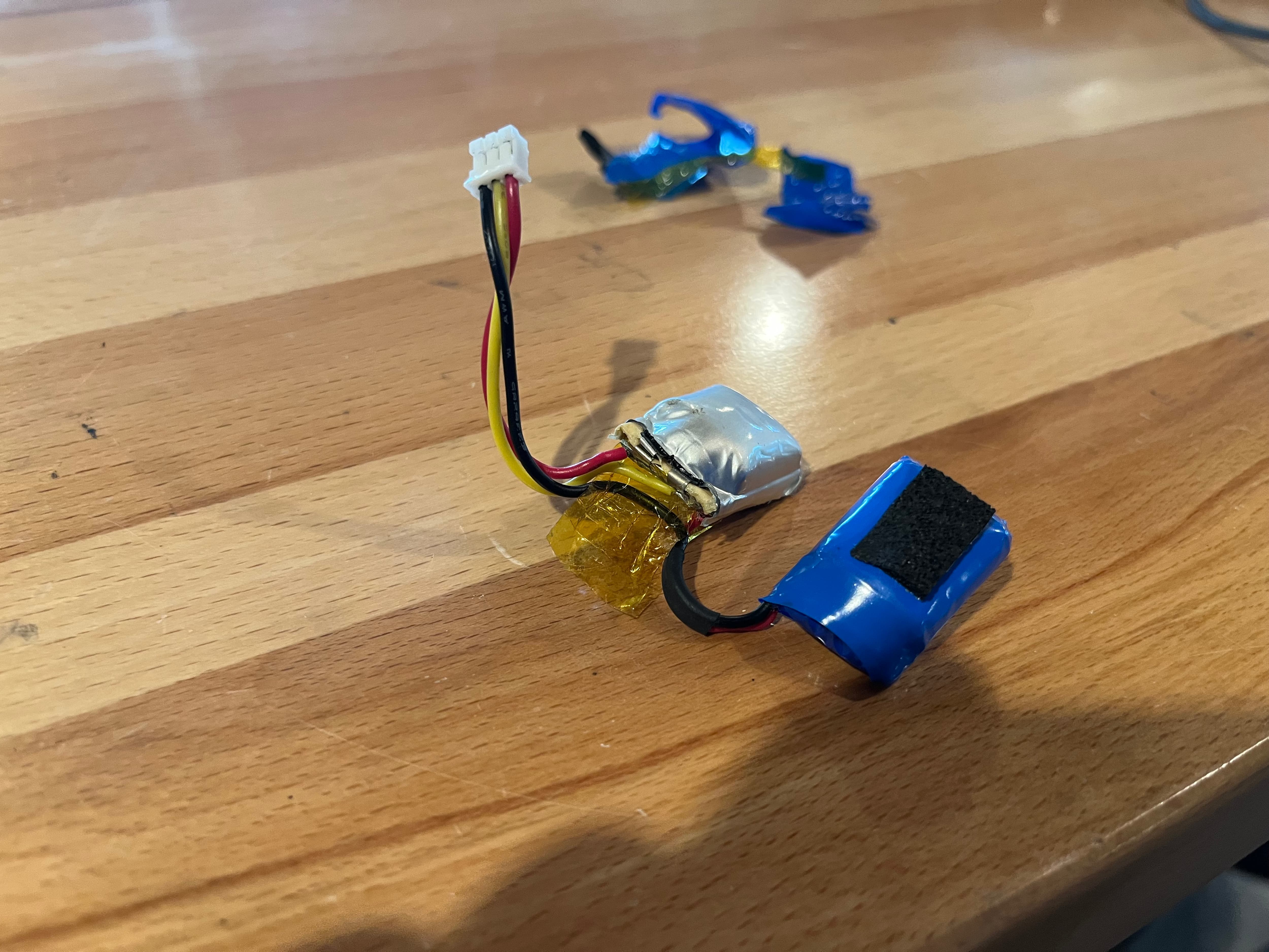

Has anyone successfully replaced the battery in a Luxos U? Suggestions on sourcing the battery?

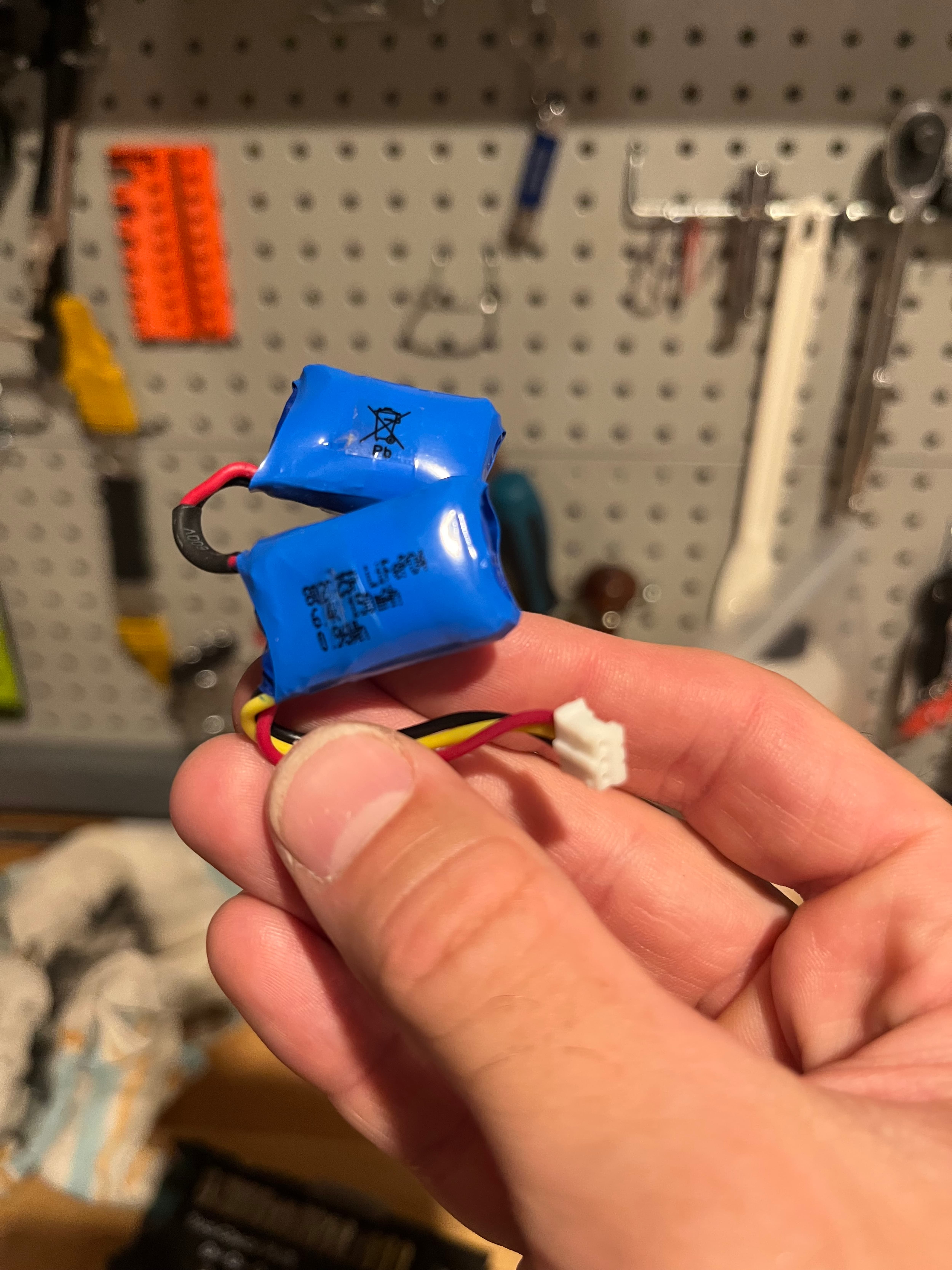

Looks like lifepo4 150mah
I’m finding either 3.7V 150mAh batteries (wrong voltage), or 6.4V but much larger (1500+ mAh) batteries. While 1500 mAh might be great for charging a device, I don’t think it’ll fit in the light body.

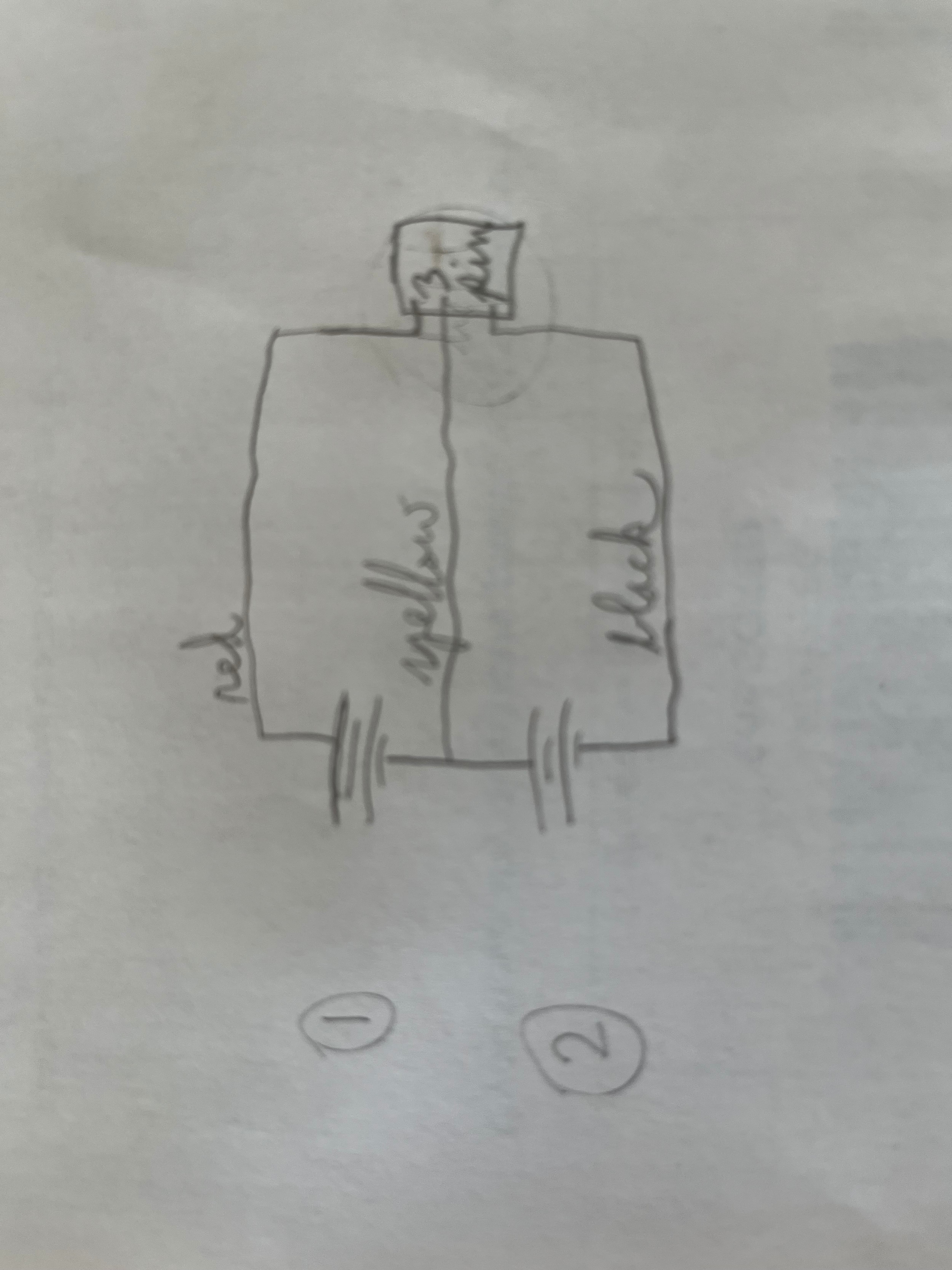

You think maybe they’re wired in series and the 6.4 is ideal and not actual
Yeah, just realized that.
Dq what is the number before lifepo4?
802025p, I think.
And I opened it up to figure out what was going on with the wiring.
Seems like a potentially finicky/annoying but doable project. It’s conceivable there’s other broken components, but the batteries definitely look like the culprit.
