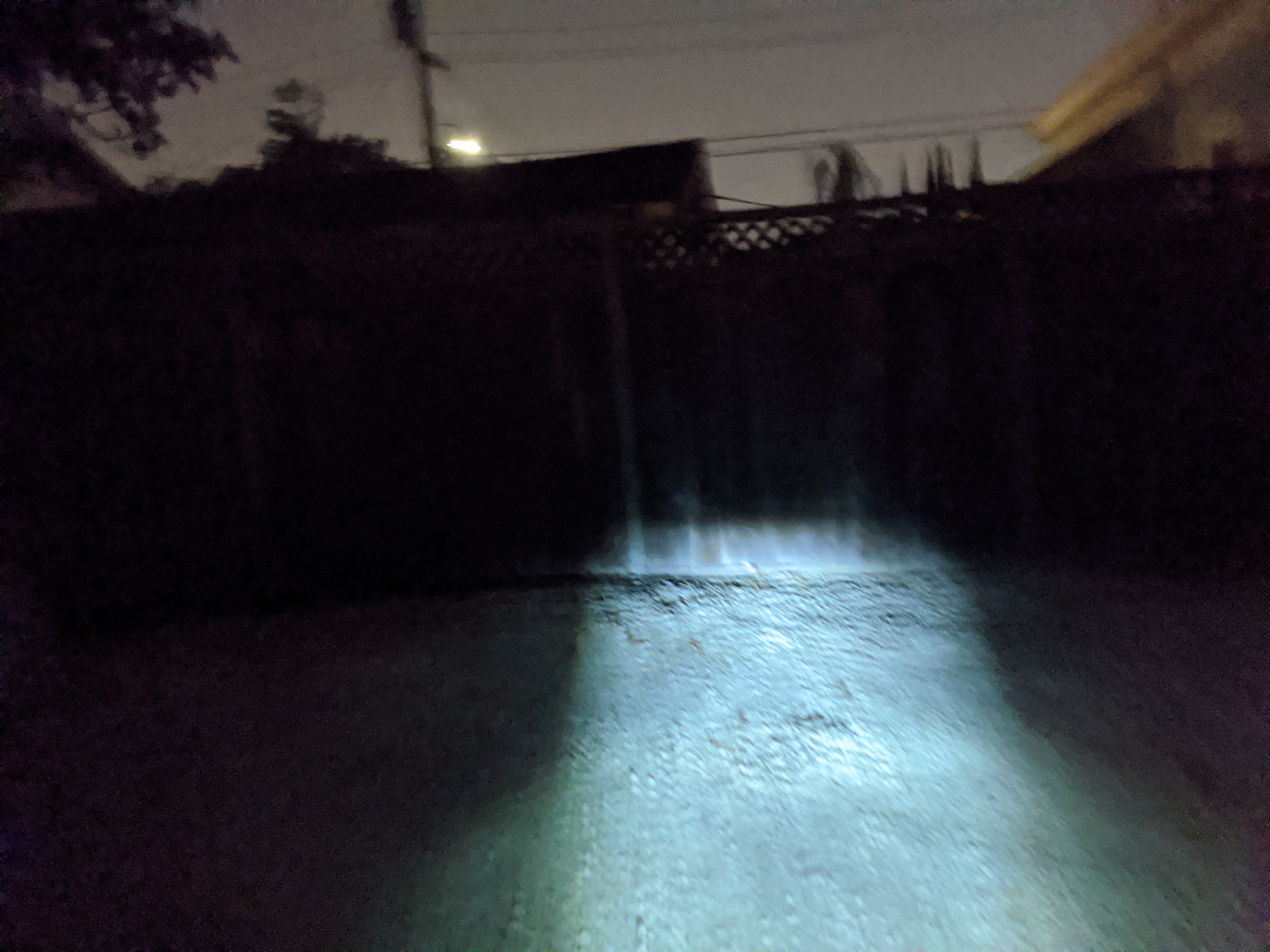

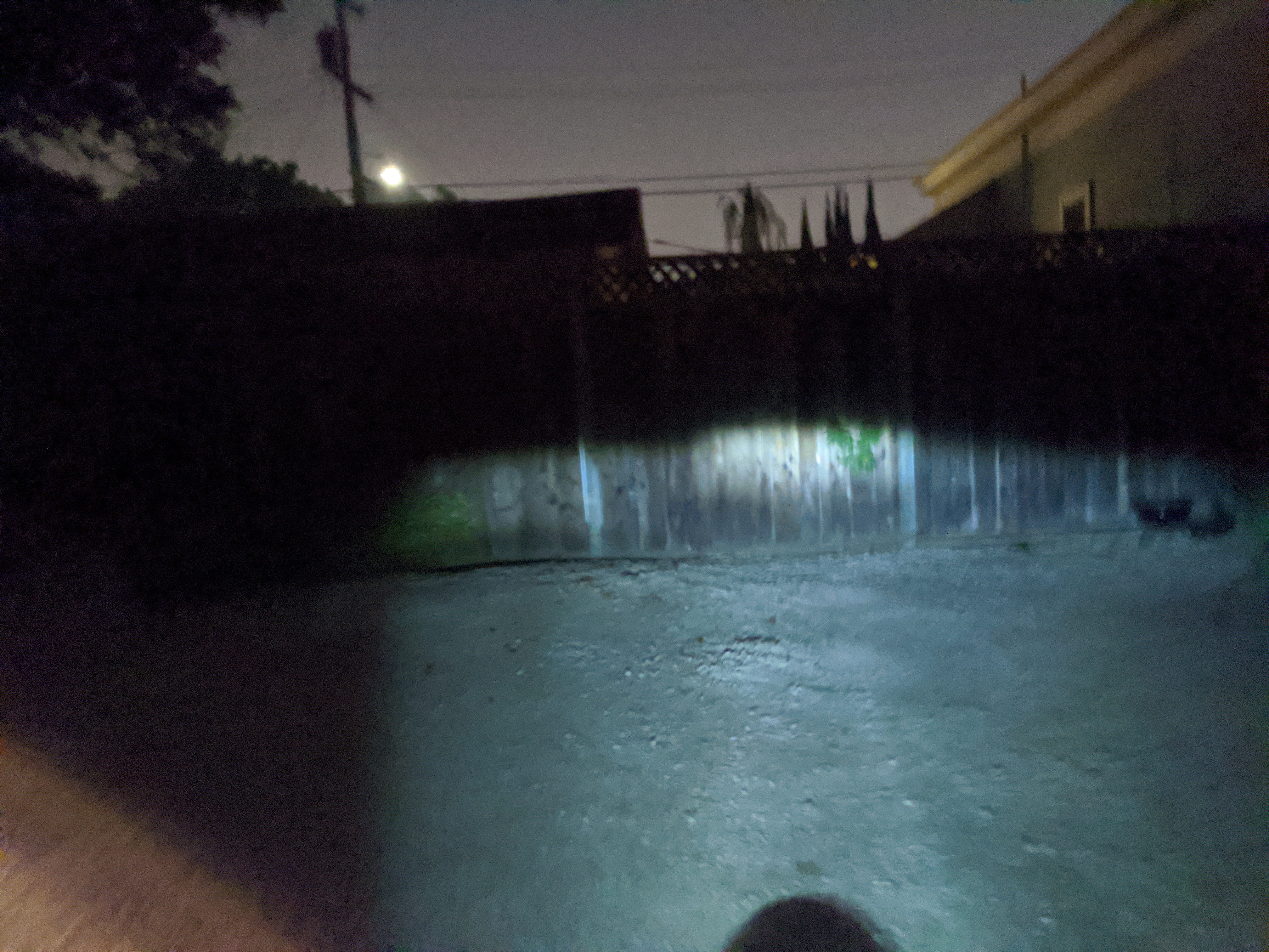

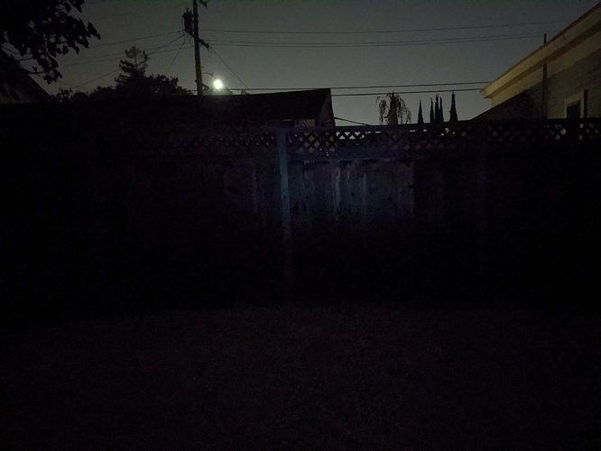

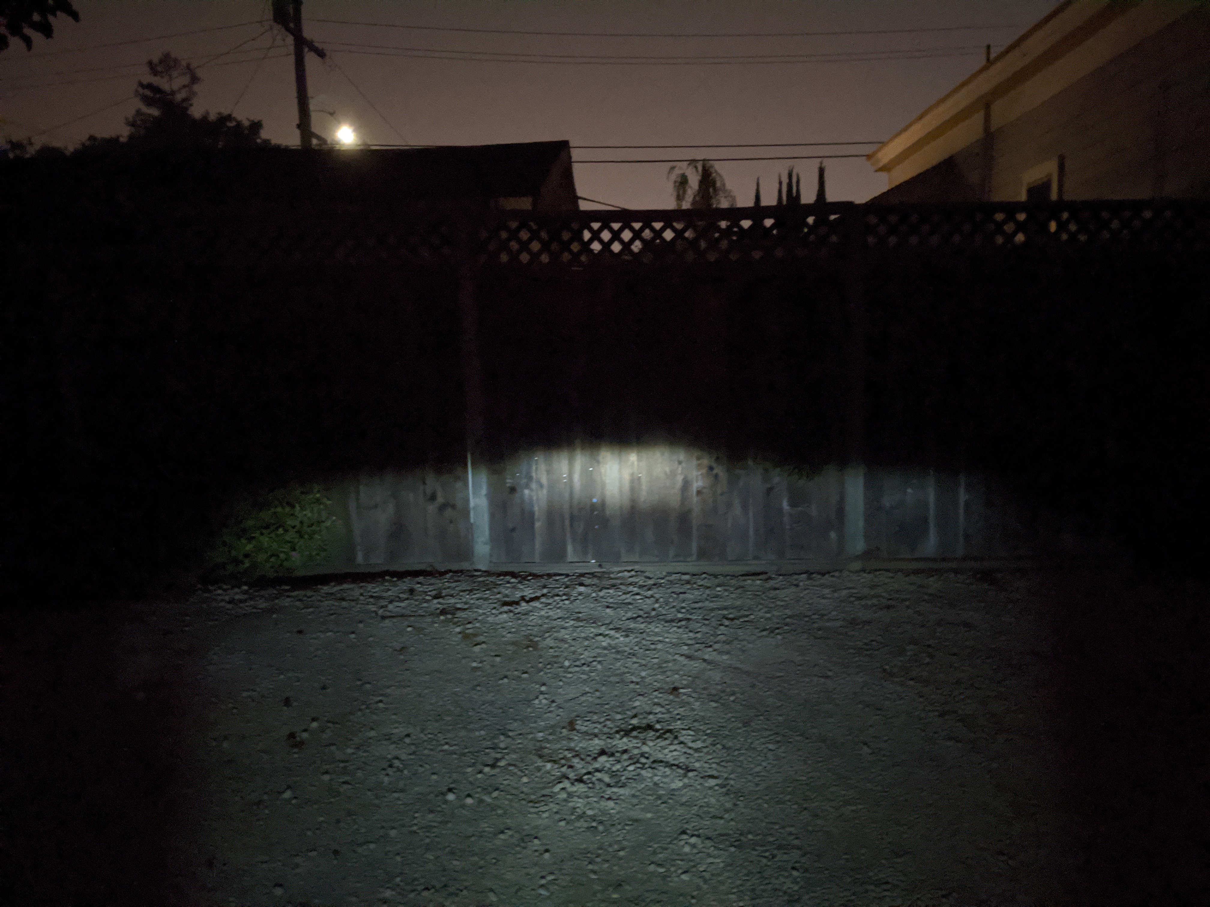

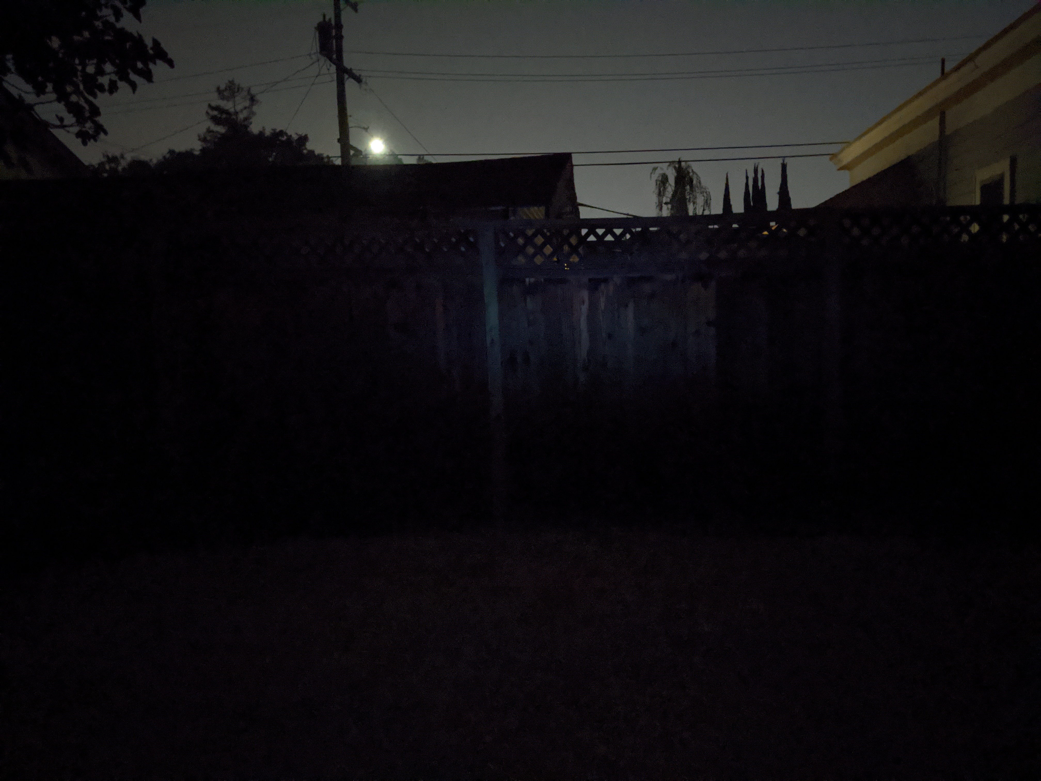

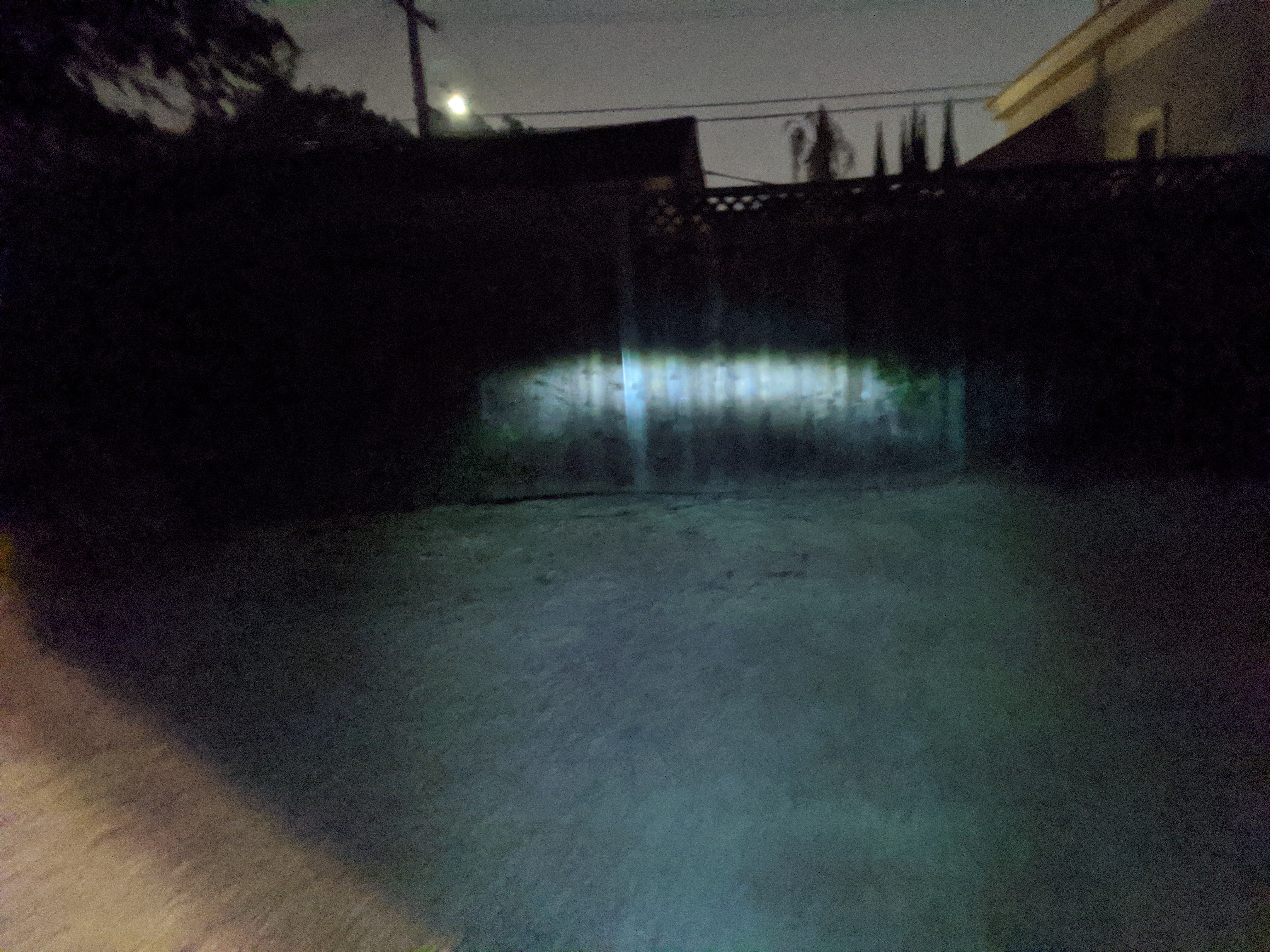

alright, y’know what, i’m bored and i have nothing better to do with my time so why not. TL;DR i was very wrong and the IQ-XS standlight appears to be poop.
Procedure: rode around the block to charge the cap then rode back up my driveway and pointed at a dark fence. Phone photos so it’s auto-exposing and white-balancing and everything, very non-scientific. Tried to get a photo of the full-bright beam as well as the standlight, although the former is much harder than the latter because you have to be moving and my dark fence was right after a sharp turn.
Edelux II moving:
Edelux II Standlight:
IQ-XS moving:
IQ-XS standlight:
note the (very dim) bright patch waaaay up the fence. why is the only illuminated area above where the beam cutoff is???
Just for comparison, Eyc moving:
yeah it’s a shitty picture and it turns out I have the light aimed too low but I didn’t care enough to try again with this light. Note the super-narrow beam on the Eyc. Standlight on the Eyc did not noticeably illuminate the fence so I didn’t bother with a photo.
Weird thing is when viewed off-angle from the front of the bike, the Edelux II and IQ-XS looked semi-similar brightness on the standlight - but the IQ-XS standlight just doesn’t project at all, it’s very diffuse.
