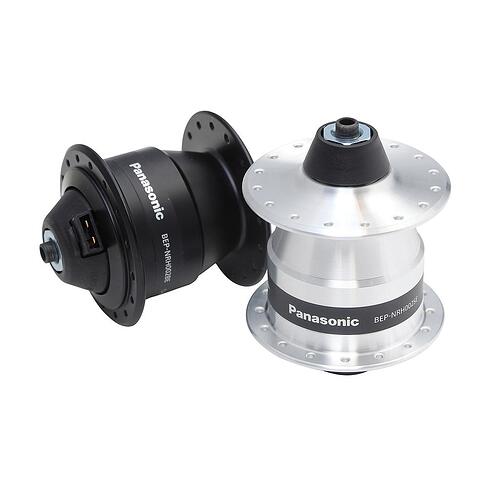

Yo, $22 Panasonic hubs, might even be worth the $15 shipping charge.
Oh, 6-bolt too
Has anyone used panasonic hubs? How do they compare to Shimano?
I ran the SRAM branded version for a while and it was fine other than the weight.
I’ve had a Sanyo (same difference I think) for like 7 years now with no issues. I think they are supposed to be draggy even with the lights off but I just leave mine on all the time

Well what it is interesting is that I seem to remember that basically all the hubs have pretty similar drag with the lights on, whether they are $20 or $200. Since daylight running lights have been shown to reduce your chance of being run over, drag with the lights off doesn’t matter much to me!
ok mr scientist
I have one I got at a bike swap for $10 and have used for a year+ now. it’s exceedingly fine! I don’t have graphs or whatever but it works and I don’t notice any weirdness compared to the SP dynamos I use on my not-beater-old-26"-mtb-commuter type bikes. Would absolutely buy again.
I have one on my commuter and have used them on some customer builds. They’re fine. Definitely draggy but cheap and reliable.
I’ve got 2 of the Sanyo/Panasonics. One going 7-8 years, and the other about 5-6. No problems with either. :man_shrugging:
Maybe they have enough drag to put a little dent in a fast rando time, compared to SON etc. I sure don’t notice, and rarely turn them off.
