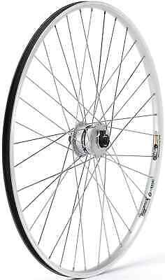

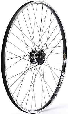

Heads up that the cheap but well built IDC Stout dyno wheels that Shart and I (and maybe a few others) have are available again after being MIA for a few years. They used to be $99 but still super cheap.
Now Featuring 650b!
I’ve had the silver 700c on the front of my VO for like 5 years now and it’s been great.
That’s pretty cool. And a pretty still a really good price for a Shimano disc wheel!
Kinda surprised they didn’t go for a rim with tubeless capability though.
Yeah I’m this close to dyno’ing my fixie with this.
Just went for a wheelset. $200 is a steal to avoid scratching my head at the slow-developing nipple cracks and hollowing brake tracks which I guess I’d been waiting to fail before replacing
Thanks for the heads up!

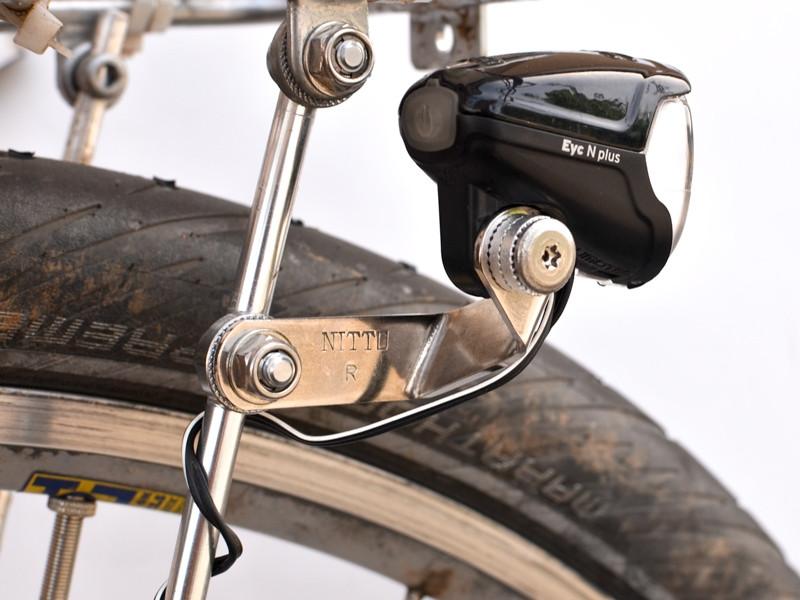

What’s the best way to mount a front light to a nitto M18 and a rear light to a seatstay?
Cyo premium is totally fine, so is luxos m (the non usb one) imo. Source, used both.
Nitto sells a thing for mounting to rack legs. It works well imo, i have one that has been solid for years.
On the other hand, a light that supports hanging will get onto a nitto rack boss with a bit less faff.

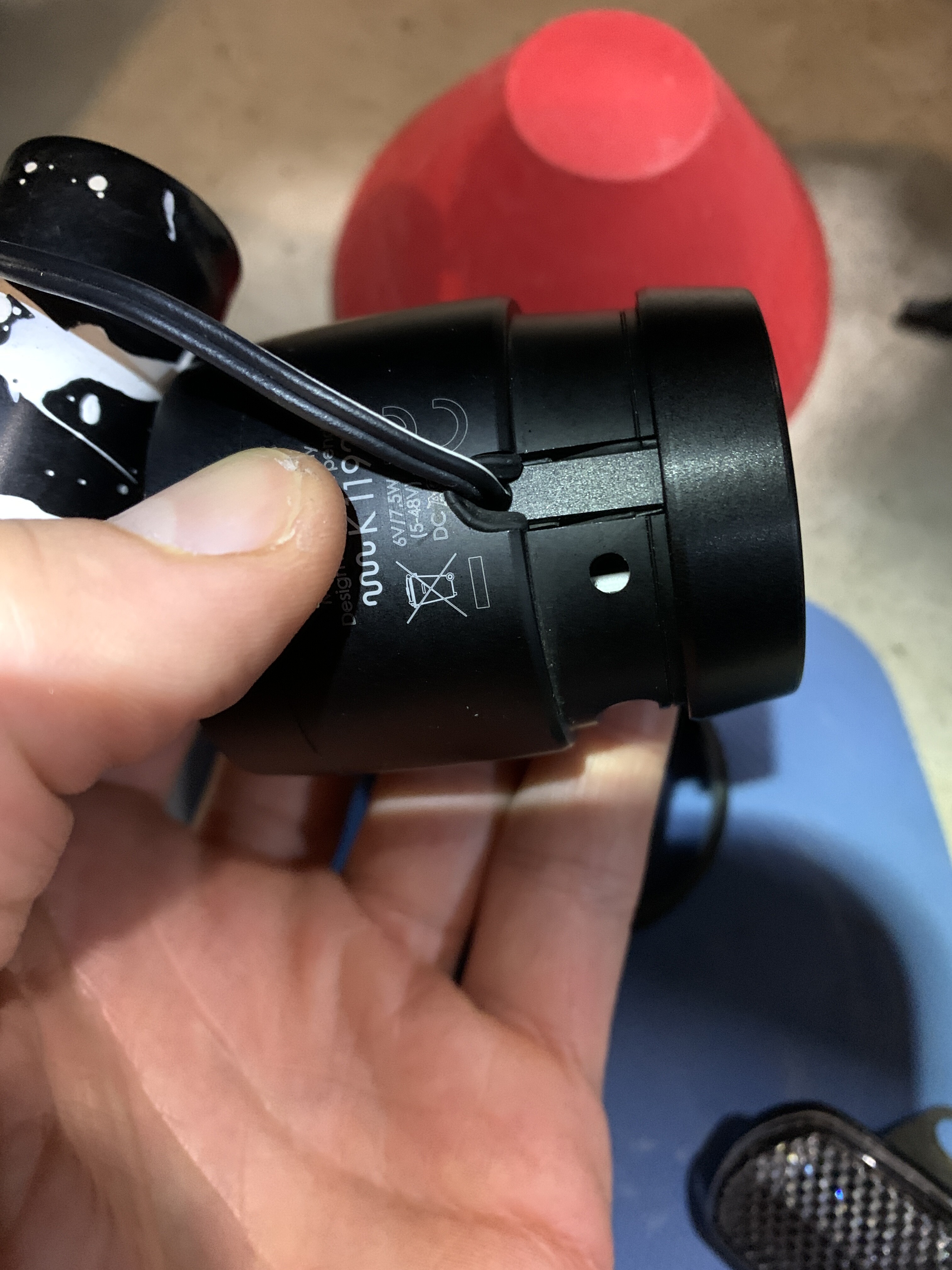

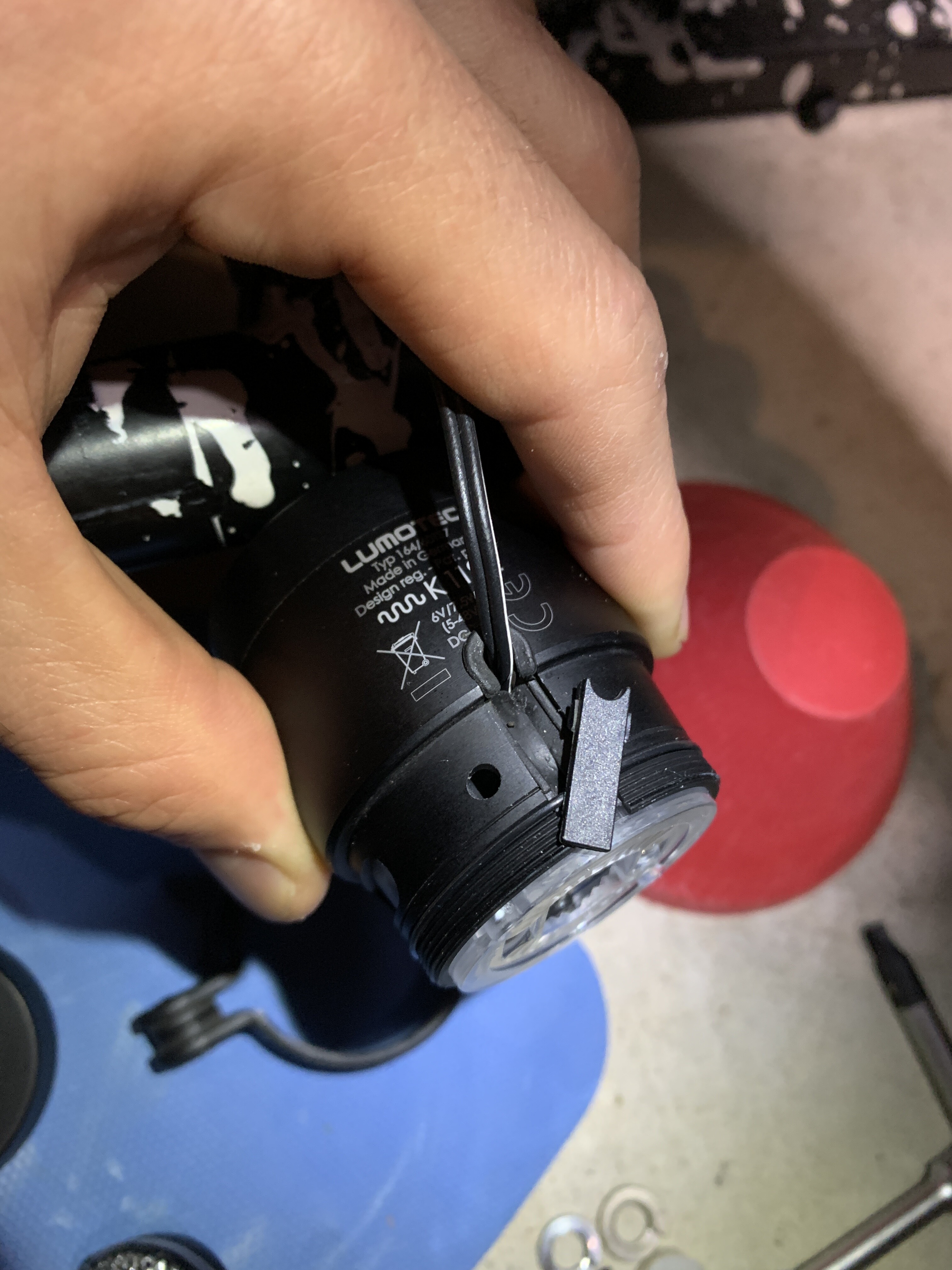

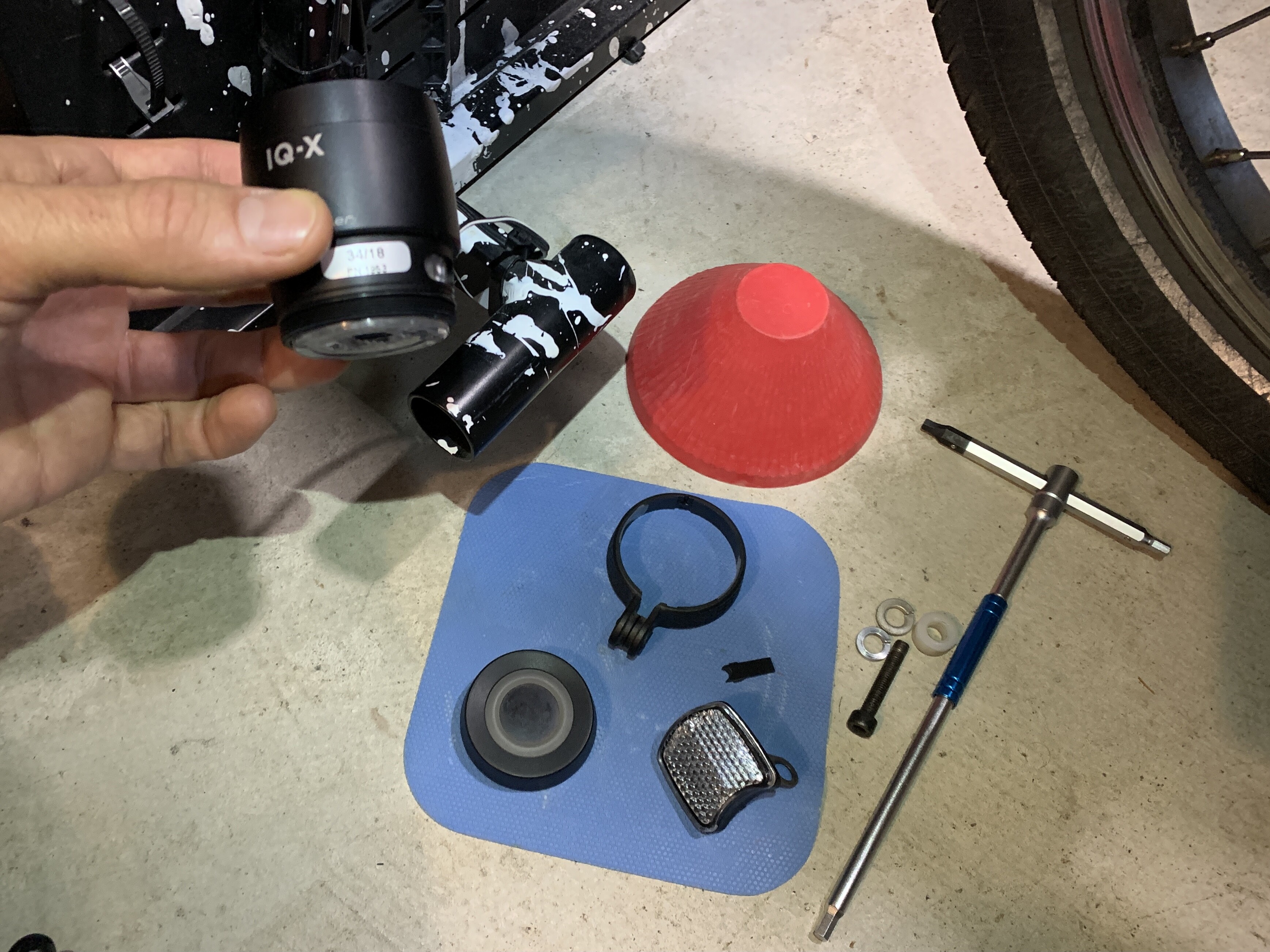

Had this little cover piece fly out yesterday when I was adjust the angle on my IQ-X DC e-bike version. Couldn’t find any documentation online about it.
Turns out it’s the cover of the wire exit slot under the band. You have to unscrew the switch cover to put it back on and I ended up placing it under the o-ring seal which seems correct. Note that the switch cover is reverse threaded to what you expect, I needed a jar lid gripper to get some purchase.
