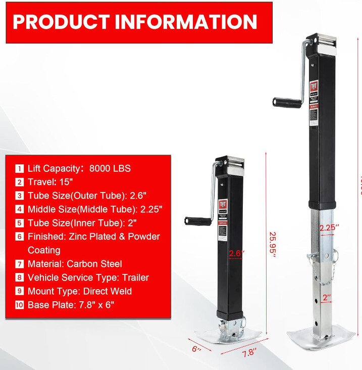

I think a better solution would be to use a trailer screw jack.
This one has 15" of travel, and the 13" of drop leg adjustment means you can adjust it a bit to fit most bike seatpost locations before clamping them on.
Something like this. Bolt the foot to the floor or to a large stable steel base plate. Attach the bike seatpost clamp head with big square U-bolts or whatever.
If you search around a bit (“direct weld on trailer jack” is a good term) you can find them with the winding handle from the top, and some with a bare axle meant for use with a detachable handle. Depending on what you get, I’d suggest working out an adapter socket so you can use a battery drill to wind them up and down.
I still think having the weight of a big cargo bike cantilevered off center over the lift is going to topple that configuration over. It’d be much better to use some pulleys or something bolted to the ground atmo.

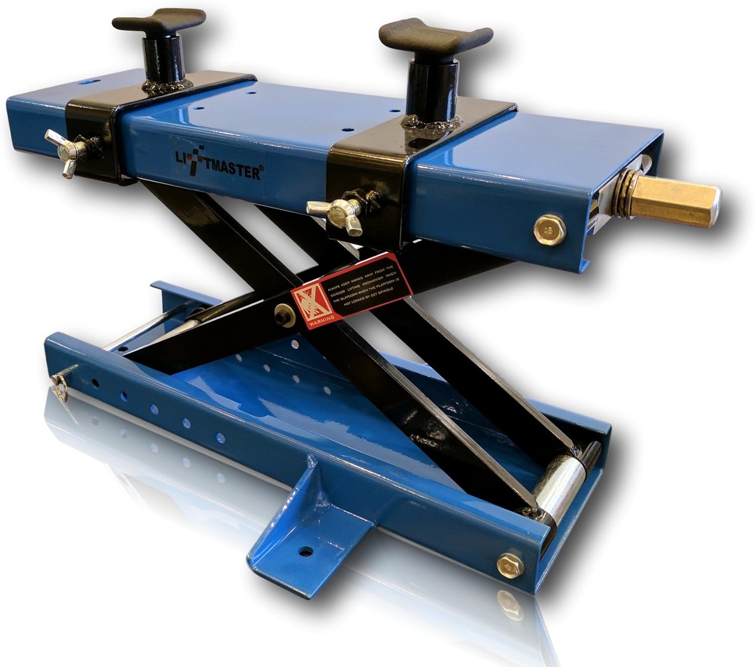

Why doesn’t the cargo bike just go on a motorcycle stand? I think hoisting huge bikes up by the chairpole is kinda dumb. Did I miss something?

The problem I see with the moto lift is that I want the wheels able to spin freely. At least the rear wheel. As it is, I lift the back end of the Bullitt off the floor with my pulleys and then secure it in the workstand with the front wheel on the ground.
This specifically says it’s not intended for long cargo bikes like yours, but I wonder how well it would work anyway. Would that be because the weight hanging further out to the sides could put undue stress on the lift mechanism?
Guessing this might not get it as high as you want, but it feels like supporting the Bullitt from underneath with something like this would be stable:

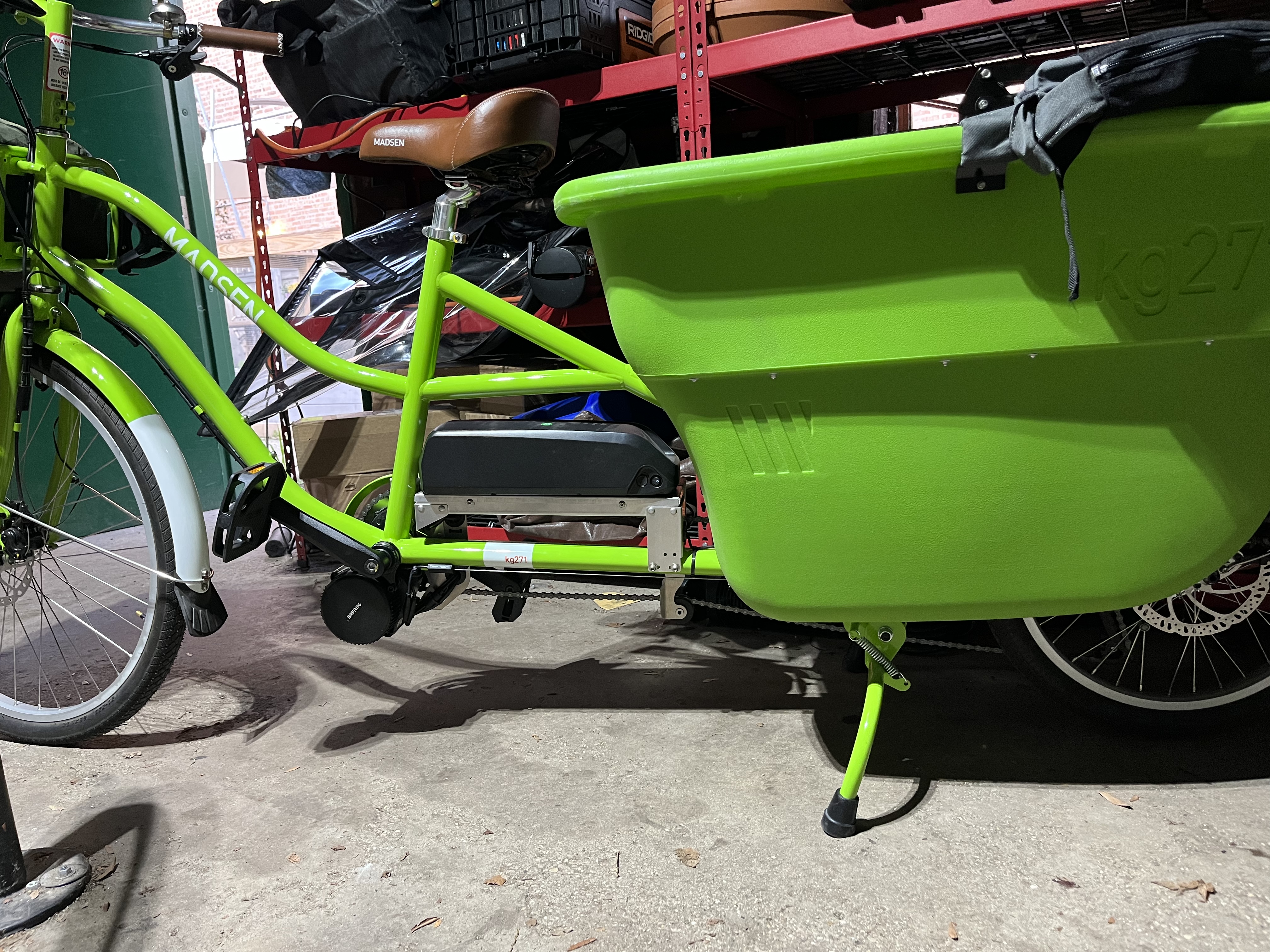

With the bakfiets, my dangly pulley system works ok. I’m more thinking about the Madsen which is heavier by a fair bit and way more unwieldy. It’s back heavy, so it’s way harder to get the drivetrain up enough to work on it.
The moto lift under the boom tube would be great, but the Bafang motor hangs under the biscuit shell and is in the way.
There are also some cables and sensors and wires under there.

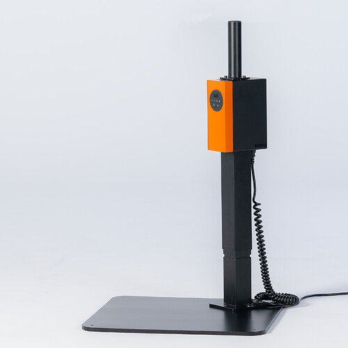

I think the Remco would work well for you. Or a pulley or hoist system with 2 straps for an even lift.

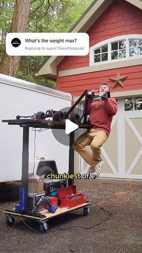

Or I could do like this guy and use a standing desk!
