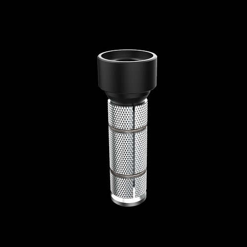

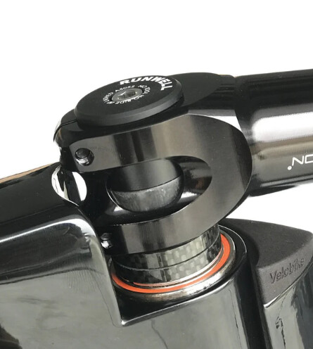

This doesn’t seem like a terrible idea but I’d love to know why I’m wrong:
I am currently using one of those on a SS mtb and I’m a little bit scared of it, but I’m not sure if my fear is justified or not.
My current setup has the stem half on the (steel) steerer, half on the extender.
I like that it has enough insertion depth to get some grip. And while it is applying force outward from within the steerer(not meant for it!), the stem is squeezing right back inward against it, sandwiching the top of the steerer in between.
It sure seems solid, but I’m not sure how much I’m willing to reef on these 760mm wide bars and really test it. I’ll probably trim the head tube, get a shorter stack stem, or swap forks.

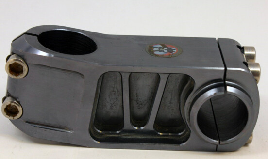

I’d feel better with some sort of beefier closed-back stem, like this:
(so that the stem flexing and moving doesn’t wiggle the steerer and extender against each other, but rather stays connected as one solid block better).
For a kids bike or something that doesn’t see standing climbing from someone powerful it’s probably fine.
Their pic shows it on a carbon steerer with a stem that has huge cutouts, both of which I would avoid.
Their guidance recommends (but for some reason doesn’t require) epoxy bonding the insert. Alpha Q forks used to be that way by default, and the Cervelo T1 I have also expects to be bonded. If you do that I imagine it’s mostly fine.
Cripes. Not cheap.
Shouldn’t there be concerns over manufacturing tolerance between the extender surface/steerer? Otherwise, I’d think it’s fine unless you’re hitting potholes or bumps regularly. Or standing climbing as jimbofly mentioned. Almost anything should be fine on smooth roads anyway.
I think it adds 3 times the material. I would guess it’s stronger

This brings up something I’ve tried to figure out yesterday - how exactly are carbon steer tubes made as far as the layup goes? I know that generally the fiber for the crown/ST junction runs longitudinally down through the crown and in to the legs, but are the majority of fibers in the steer tube oriented longitudinally along the steering axis?
To your comment about steer tubes not being designed to be loaded in compression from a stem clamping the outside rather than tension from an expander plug from the inside, it seems to my little brain that a tube made from fibers would be able to take more of a load from the inside than a compressive load from the outside.
What kind of cracked me up is they say “yeah you should epoxy it in for best results, but if you ever want the option to remove it just put a little bit of epoxy and you can knock out the expansion wedges with a punch”.

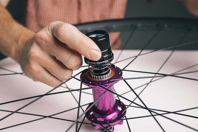

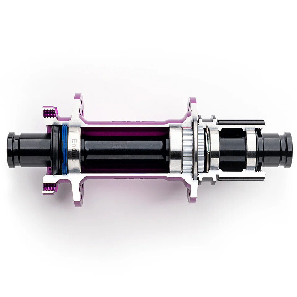

These guys got significantly weirder with it though:
  • one spring in the freehub with the hubshell ratchet fixed like Hugi from the 90s
  • but that nonmoving ratchet sits directly in aluminum teeth in the hubshell
  • don’t have to remove threaded steel drivering to service DS bearing
  • but have to knock the DS bearing though the hubshell twice to get it out the NDS
  • the bearings are is preloaded from the NDS with a cassette lockring
  • but that inherently means it’s 6-bolt only
all measurements for hub are printed on box and etched on the hub.
