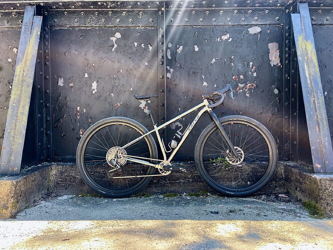

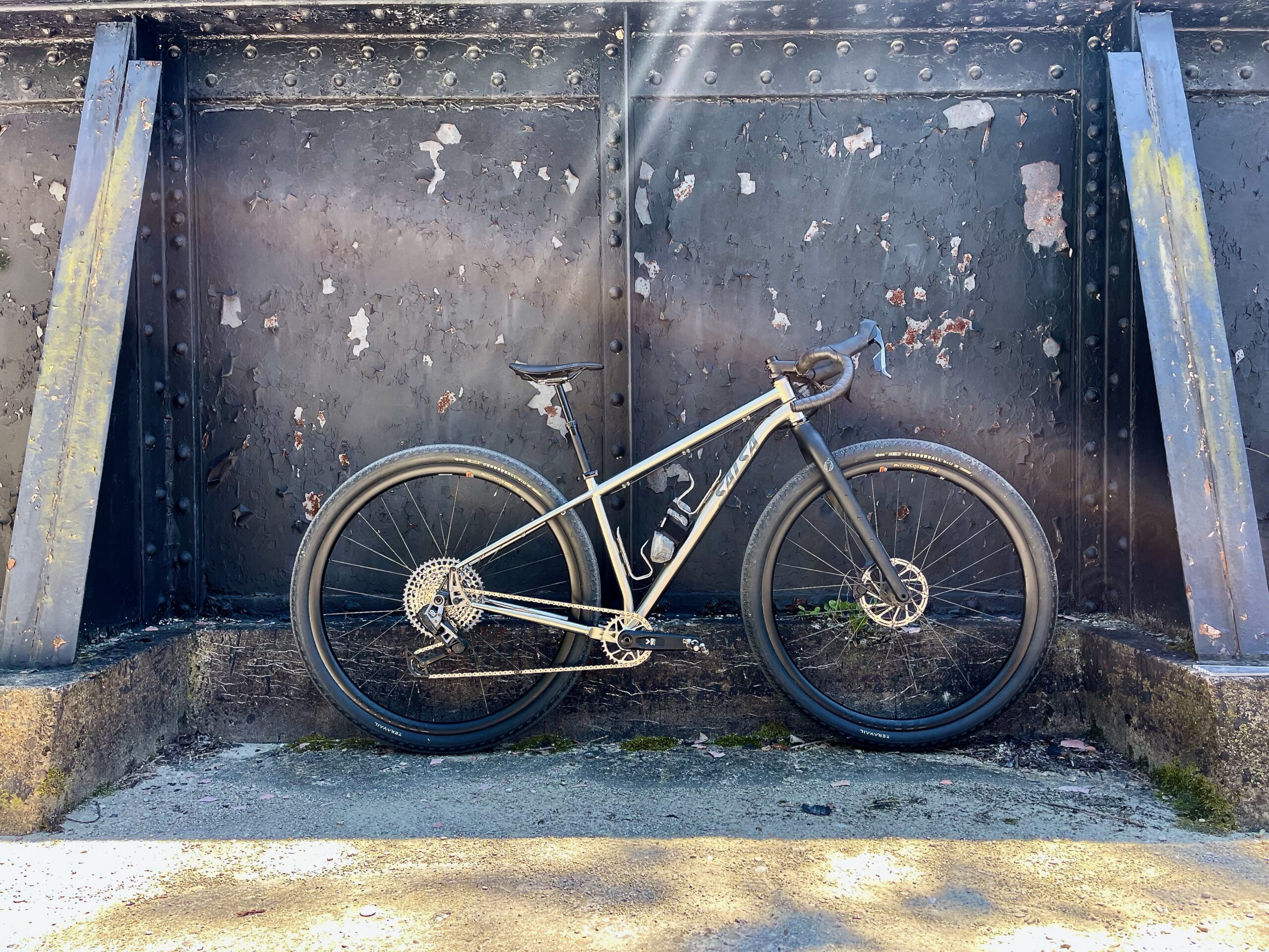

People are reviewing 32" dropbar bikes and perhaps this is nothing more than being an asshole but I read these reviews and I can’t help but be like “yeah no shit what did you expect with a giant wheel and that geometry”.
This bike has ~110mm of trail and 42mm of flop. That’s terrible geometry for a dropbar bike.
They basically took the worst hacked together dropbar MTB geometry and put it on a bike with significantly larger wheels. The normal 29" Fargo is ~88mm of trail and 30mm of flop. I get the design intent and balancing a lot of design choices but there’s no sense in making the geometry that much more progressive for the larger 32" wheel.
What am I missing here? These designers have to have some mental model of handling right? How could it be that inherently more stable wheelsize needs even more stability?
It can handle singletrack, but quick direction changes take planning. In twisty, awkward sections, it feels a little like driving an 18-wheeler through the jungle. That is not meant as a dealbreaker. It is just the reality of the platform. This is not a short, sharp, trail-focused drop-bar bike. It is a long-distance adventure bike that will maintain momentum when you have the power, but more on that in the ride review.
