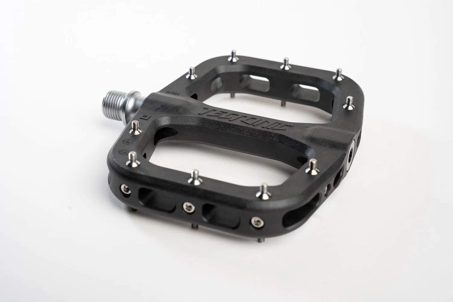

Interesting pin design on these pedals.

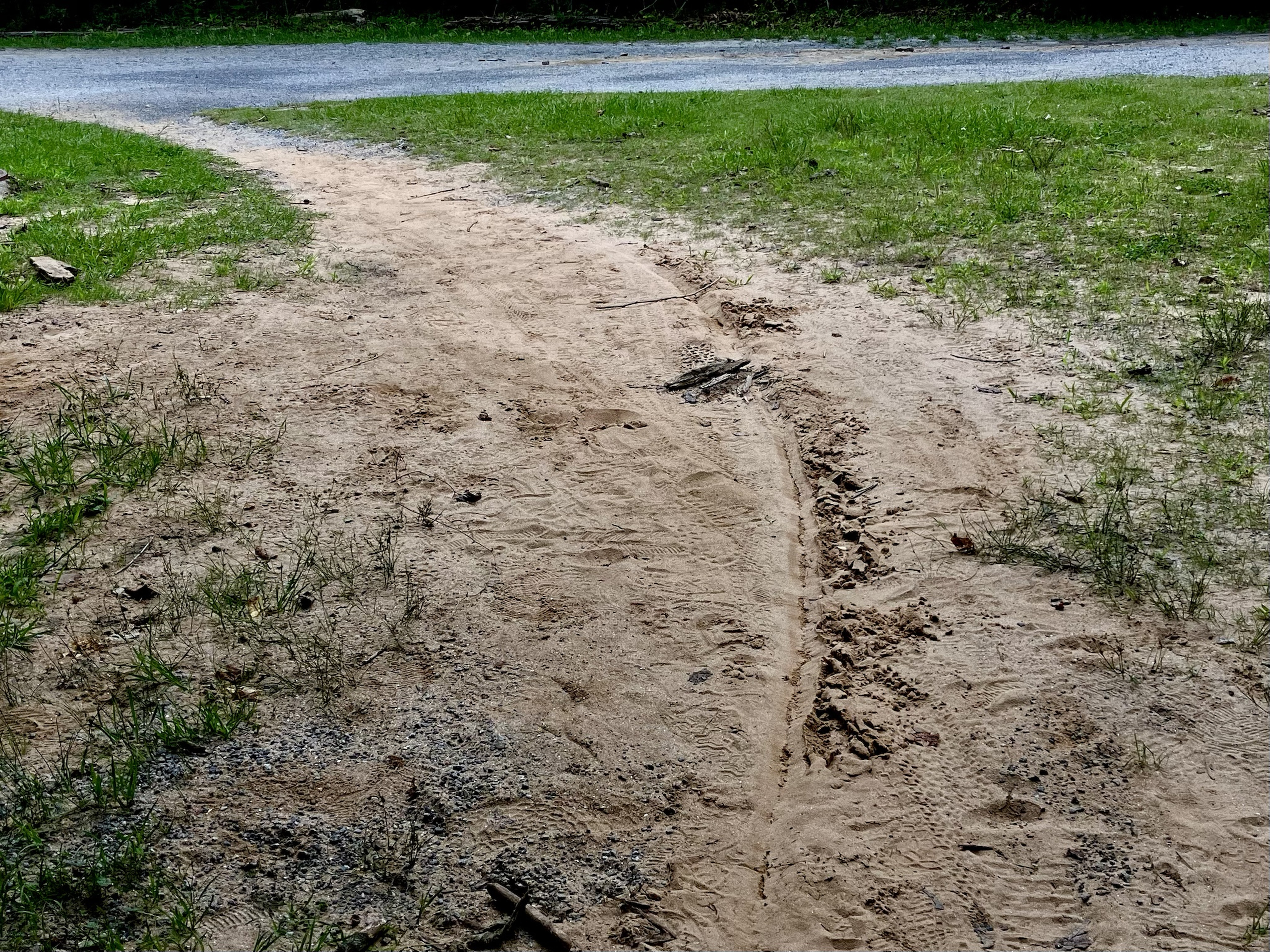

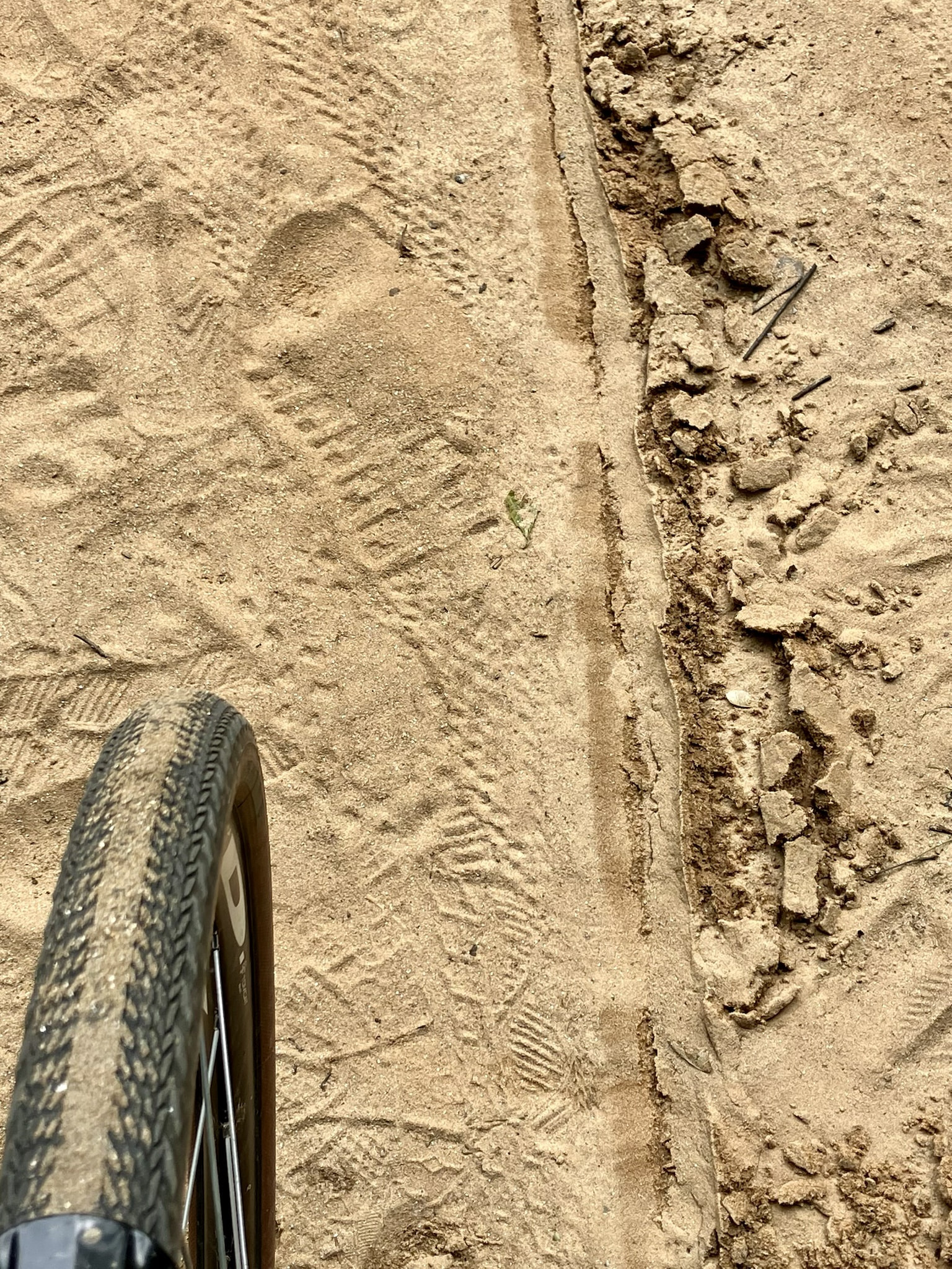

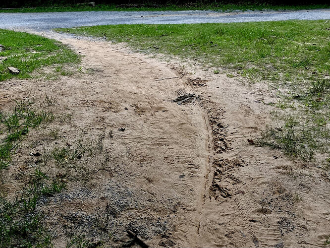

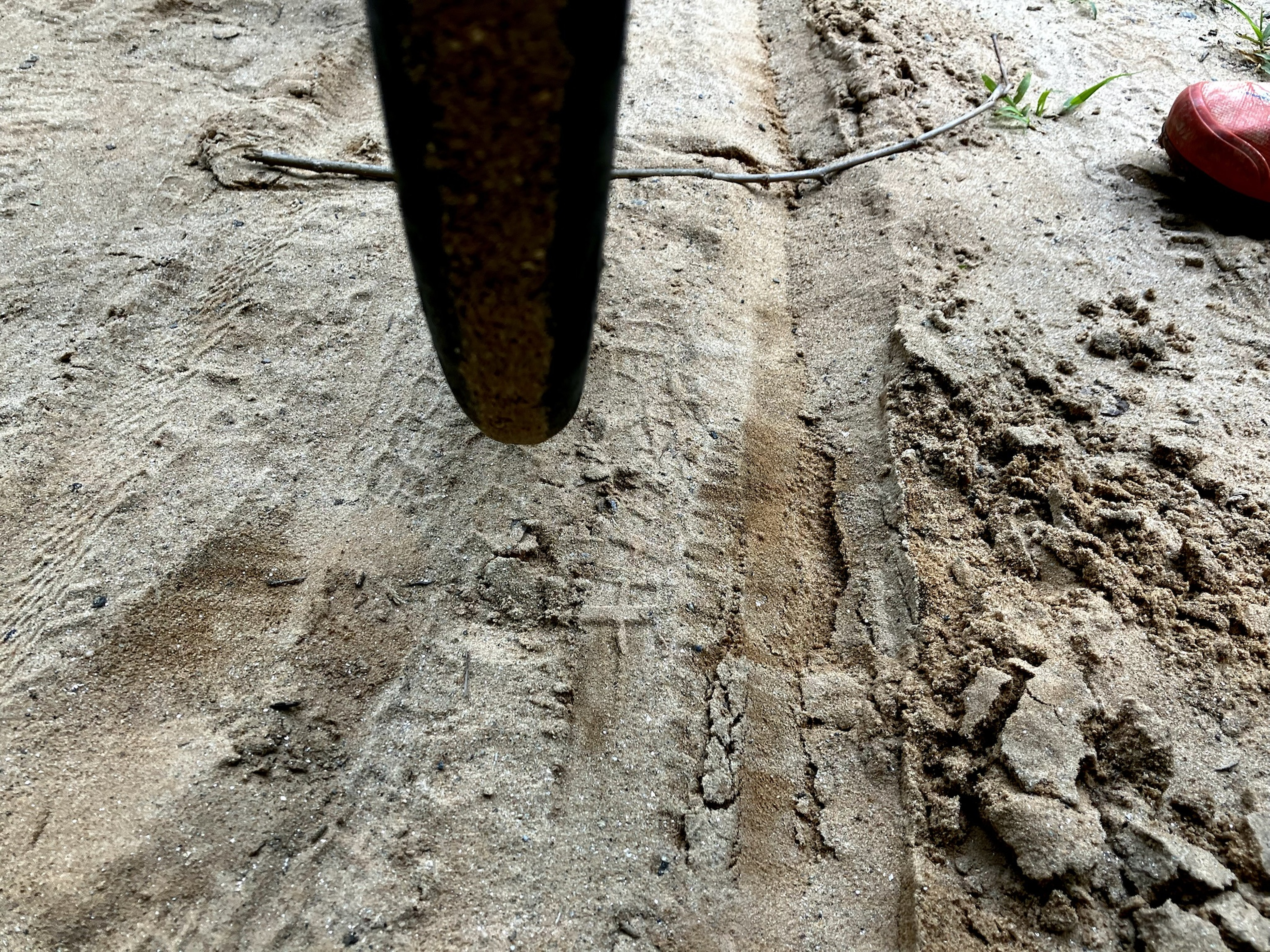

Sometimes plowing can be captured after the fact. This is sand with what was undisturbed top crust from light rain. The plowing effect was primarily from the front tire with the rear following. Rode through here at a moderate speed and had the ride of my life for 1/4 second as the front sunk and then plowed through and the rear displaced itself immediately to follow. That’s a 38mm tire so the actual lateral displacement or slip was relatively little but it felt incredibly powerful.
You can see the understeer too, with my higher trail bikes I can follow the center arc through the sand perfectly at higher speeds.

pricing is a bit tough on composite pedals, but definitely looks interesting, might have to try these out
They supposedly have a high/er recycled carbon content, which may contribute to the price.
