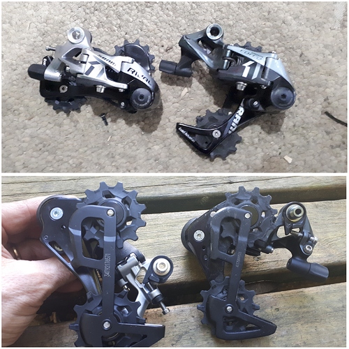

I got a surprise when I compared my new long cage Rival to my medium cage Force. They look like completely different beasts. But TBH, the thing that makes the most difference is the “stop” on the Force which stops the derailer cage from rotating back more like the Rival’s. How does the derailer know if I am in a 32 on the front or a 42? I guess the answer is, in one of these combinations, the chain will be the wrong length? Ultimately I want to go 2x I think.
Aren’t those 1x specific derailleurs? If so, once you cut a chain to the specified length, it is only good for that chainring size*
*Chain length depends on the combo of chainring size/chainstay length. So in theory a chain of X links could be used with different sized rings as long as the bike had adjustable chainstay length too.
Yep. Both 1x. I was just surprised at how different they looked. Functionally the only difference is supposed to be that one will shift to a 36 and the other a 42.
