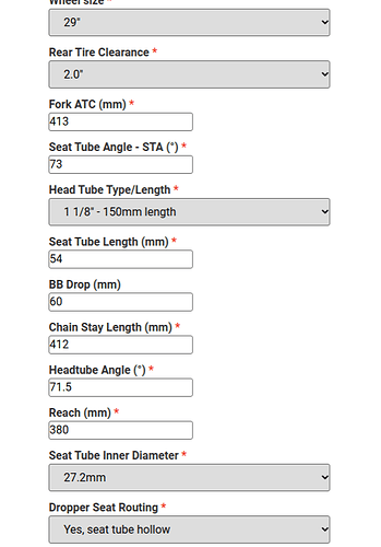

Alright, assuming I have a little money left after I get sued later this month, I’m going to get Marino to build me a frame. Going to be a big tire fixed gear thing so I can stop buying shitty frames on craigslist and trying to jam 33mm tires them.
What I want is a fast fixed gear bike that fits 700x40s and has front rack mounts.
Going to base the geometry around a Ribble Urban 725 with slightly shorter stays and maybe slightly slacker head angle but I’m very open to suggestions.

This is what I’m thinking. Not sure about rear spacing and dropouts. I think I want 120/track ends but someone should tell me why I’m wrong.
Get it made with disk brakes. Surly makes a good fixed disk hub.
I think I’m coming around to this. 135mm rear spacing. Surly Ultra New Disc 135+DT Swiss R470 or similar.
