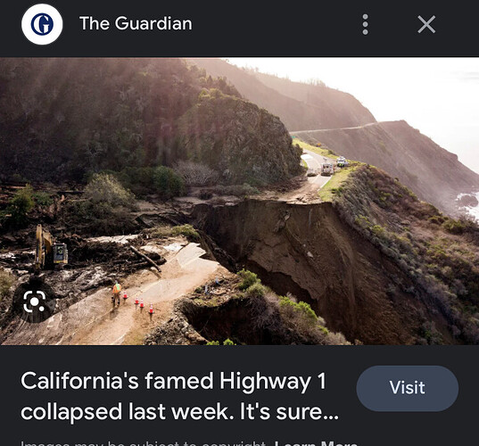

More like highway none
highway undone
Oh snap
That’s HWY 1 alright, should have seen that coming
hey what’s up it’s me the smartest civil engineer in like 1925, gonna go ahead and say that cutting a road in some soft, absorbent dirt on a real steep hill and then letting an increasing number of increasingly huge vehicles drive on it is a great idea.
I don’t know if I’d blame the engineers that built it. Imagine being the guy that is hired to make the fever dreams of a bunch of Musk-types come to fruition.
Naw dawg this sort of slide has little to do with the road and a lot to do with saturated sediments in a filled gully.
TL;DR bad engineering but not for the reason you think.
It’s still a dumb fucking place for a road and the road might make the slide more likely but like a 10% not a 100%, and mostly due to poor drainage in fill and not vehicle usage.
there are a lot of fucked up awesome roads in CA. there was a week way back in the early 2000s when the place I lived (Humboldt county) was entirely cut off by road. roads south, west, and north were all either snowed in or slid out. kinda cool. the southern road has since been replaced by a gigantic overpass
