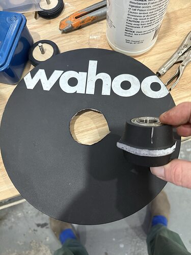

yikes! bad casting?

It’s an older kickr core, i got it along with a 1st gen kickr for mad cheap as both had issues. The issue with the 1st gen was pretty mild, forget what, think i just needed the QR spacer kit they don’t sell anymore or something. I use it now.
Core needed a bearing swap, but i don’t plan to make my fancy bike a trainer mule so i gave it to him, along with bearings.
This happened as he was pressing the bearings out, he’s not a brute but i wonder how much pressure he was applying and if knocking them out might have been a better idea.
Crikey.
I haven’t replaced that bearing and it looks like it would be much more if a pain to do.
Does that bearing have a shoulder it rests against or something and can only go out in one direction? I can’t believe that pressing it would fracture it before the bearing moved unless they were pushing it somewhere it couldn’t go, (or there was a preexisting fatigue crack…)
