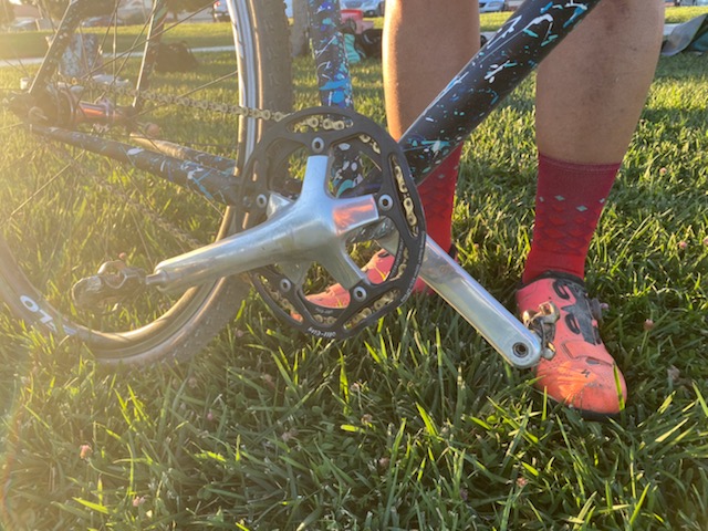

I suppose in this case the fender would have to come off. And at that point I think I would prefer to pull the fork.
I don’t actually remember. The rack and fork were both custom made to work together, and it went down in the context of a fork swap.
Oops. Pretty sure this was user error. I switched those cranks pretty late at night.
IMG_3167
Yup
How does such a thing happen?
Someone forgot to tighten the pinch bolts.
Speaking from experience, not tightening the pinch bolts to the requisite 15 Nm.
I had to unfuck my cranks in the woods so I could pedal out when I did that.
Oh man, now that’s a pretty rough oopsie!
One was kinda tight…
Just waiting on the rotor spindle and I’m ready to go with the new cranks.
i don’t see the problem with those knock off Power Cranks ™
Kangaroo Mode engaged

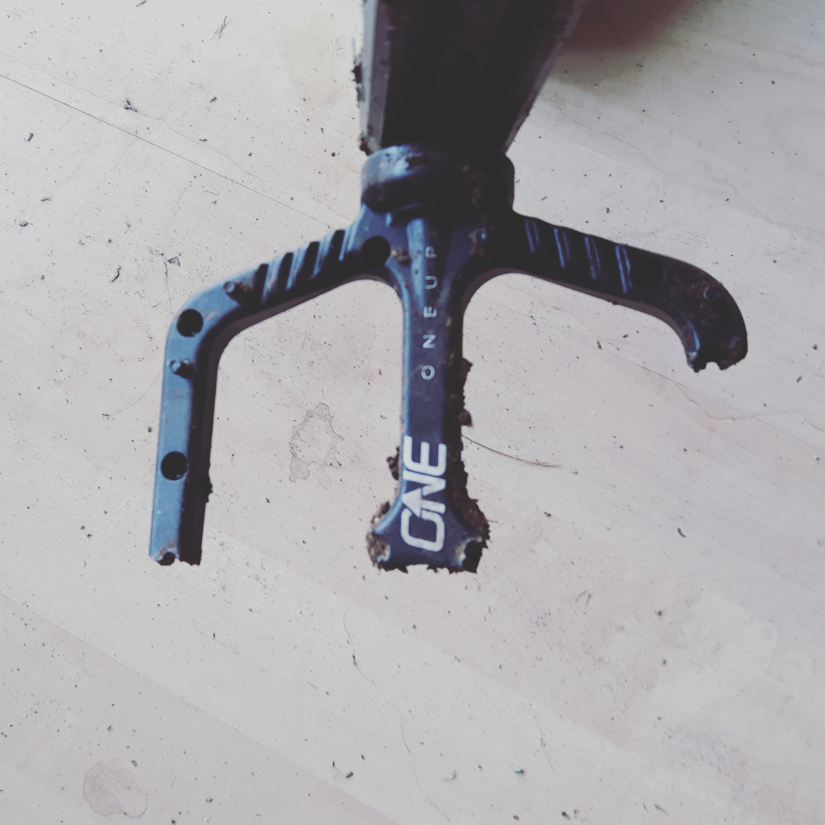

First ride :frowning:
I had to double check to see if this was the fooker thread. What happened?
Clipped a rock. Where the pins are the metal is around 1mm thick. Which means one little hit and boom. Some things can be too light.
More like 2
Yeah, that’s an email with pictures to OneUp.
tore up one up
That pedal is fooked
