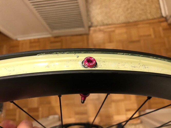

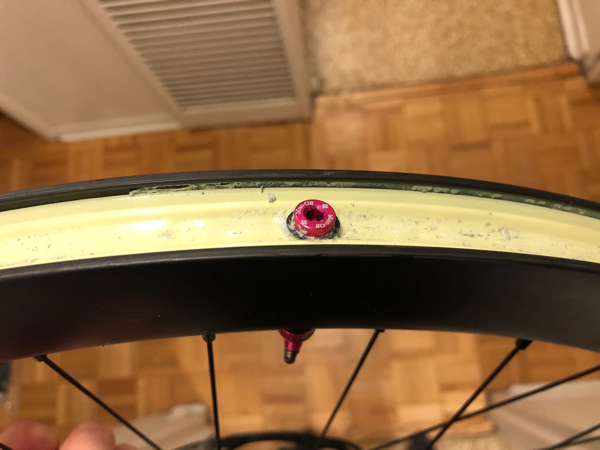

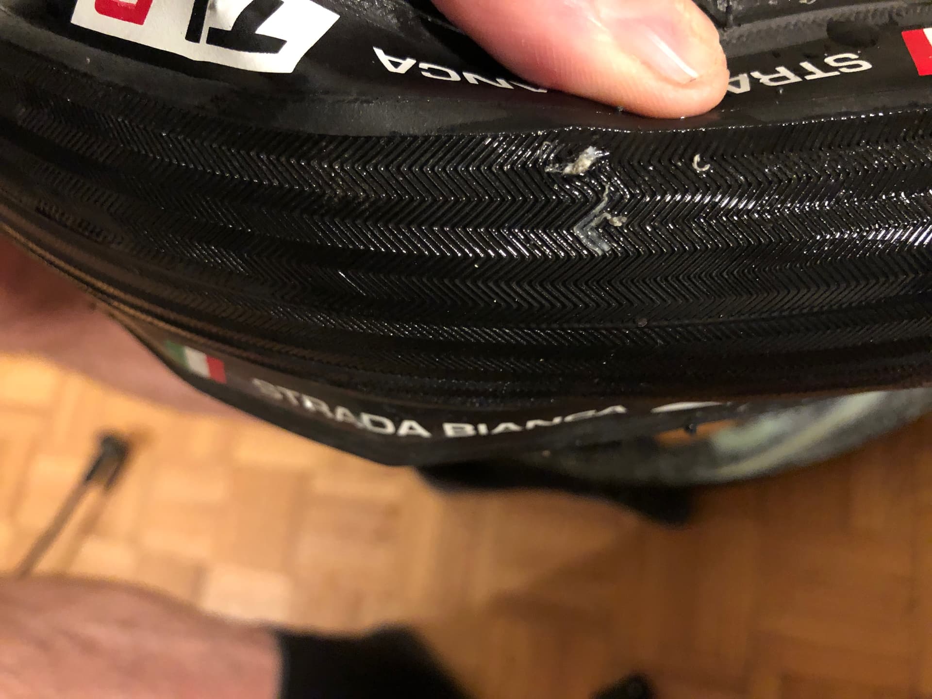

Picked up a gash on the edge of my tread on mine after less than 1000 km that wouldn’t seal up, unfortunately. Probably just bad luck for me, so will give em another go around. Which leads me to this question, how much prep needs to be done between tire swaps, at minimum? There is a lot of dried sealant on the interior rim wall all around which makes me wonder if they could use another wrap of tape, or just scrape this stuff off and yolo?
I’ve trashed two fronts in the last 6 months. Definitely bad luck. Hit something crazy at speed blasting three holes (one in the sidewall), was able to plug and get to destination. Last week on a giant chunk of glass that filleted a pinky nail size bit of tread off but somehow didn’t actually “puncture” until 10 minutes after I got to work.
But anyways… rinse the rim, if the tape looks good, new tire and go.
Awesome, thanks Braden. What are you using to plug? I was chatting up the guys at my preferred LBS about what kind of plug they like and fella was telling me he doesn’t even bother trying to plug, just throws a tube in then trashes the tire, which seems… wasteful?
Dynaplug for anything over 35 psi is the way to go. Bacon rarely works well enough in my experience. That first tire took two rather expensive plugs but got me to the shop and saved me the embarrassing walk due to forgetting to carry the correct tube for the bike I was on.
That being said… I’ve also been saved by a plug when it was a small hole that wouldn’t seal because the sealant was mostly gone. So there’s that too.
But yeah, normally I would carry a tube and if the tire looked like it was going in the trash and I wasn’t in a hurry, I may have saved the dynaplug.
