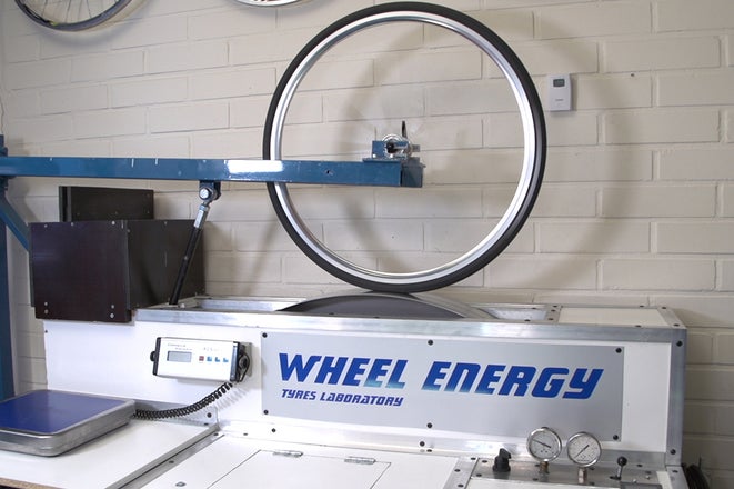

Here’s a neat article on velonews on the topic of rolling resistance:
Discusses breakpoint pressure at length.

these data were produced with athletes all having very low body fat percentage and therefore, lower hysteresis than most normal people!
Now there’s something I’ve never thought about
I am currently dieting to reduce my rolling resistance
Nope, that’s not how it works.
It’ll reduce your hysteresis which changes the break point. Who knows whether that goes up or down? Up, I’m guessing. Now I’m trying to imagine the resonant frequency of someone’s fat deposits and how that influences things. Not something I thought I’d ever be considering.
Ultimately, though, there’s a coefficient of friction at play which is influenced by the weight of the system. Also the potential reduction in frontal area will yield an aero benefit.
Yes I understand what you are saying but at a constant pressure more body fat = more RR
I would think that higher body fat would reduce your tire pressure breakpoint. Lower pressure less body jiggling.
