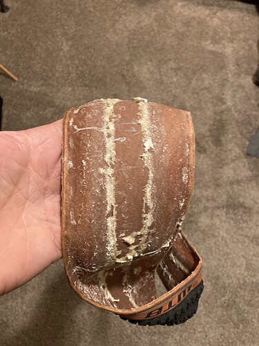

I also think the contact patch tends to affect how the sealant disperses during slower riding & spin up/down. Every tubeless tire I’ve ever used has shown parallel sealant build up at the sides of the contact patch, inside the tire. Which is shown in the videos but not emphasized as much as I believe it would be with the tire in contact with the ground.

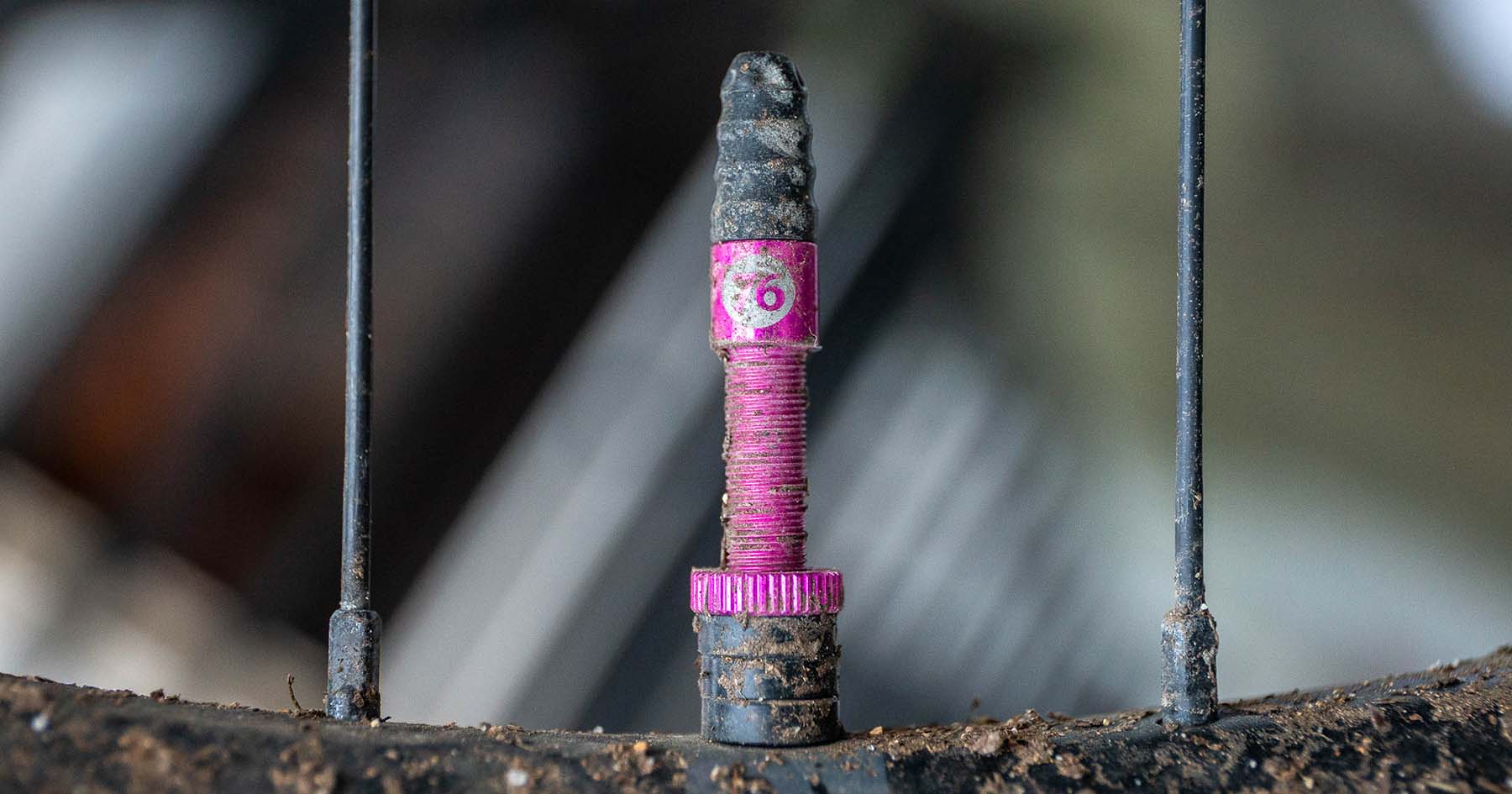

Coming in hot on the heels of the Reserve Filmore, a new high-flow tubeless valve stem. Looks like this is now a legit category, and I’m looking forward to trying these as I build new wheelsets and replace old stems.

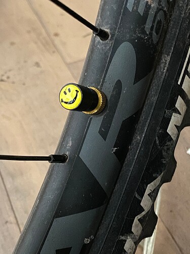

One day someone will rebrand schrader valves for tubeless
the future is then, old man
https://www.danscomp.com/alienation-tubeless-alloy-schrader-valves-black-pair-32mm-63985/p1306945?v=1306947&gclid=CjwKCAiA55mPBhBOEiwANmzoQveBKsvEc6uYfwW7FhG25F2ILjINwFqBZRlQCZJ3yMzh4uzfrZRMSBoCcpkQAvD_BwE
:smilegrant:
Yeah, you can also just buy Schrader’s at autozone
I will definitely be using one of these the next time I have the tires off. Tired of replacing valves.
I just cram a spoke or something in there to get all the gunk out every time I take the core out. The cores are replaceable so if they get all cocked up I am not too worried about that either.
Same. I’d rather do this then mess with a proprietary thing.
Schrader might be the least proprietary valve in the world tho. not gonna work on all rims and won’t work with some bike inflation accessories. but that’s not schraeders fault
I was gonna say. I’ve done tubeless with schrader. I used a cut down bolt on car tubeless valve and copious amounts of gorilla tape.
