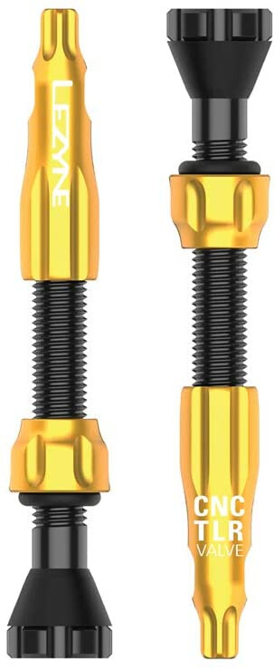

For presta, I keep valve cores on hand, and clean out the valves occasionally. If I need “high flow” I just seat the bead with the valve core removed. I’m not keen to add additional weight to my wheels either. I used the Lezyne tubeless valve stems for a while. This guy:
Because gold is best, but the damn gold nut is so heavy that it annoyed me, and that’s only a gram or three. These days I’m using the MucOff v2 coz 7075. I also have some of those Lindarets titanium dudes.

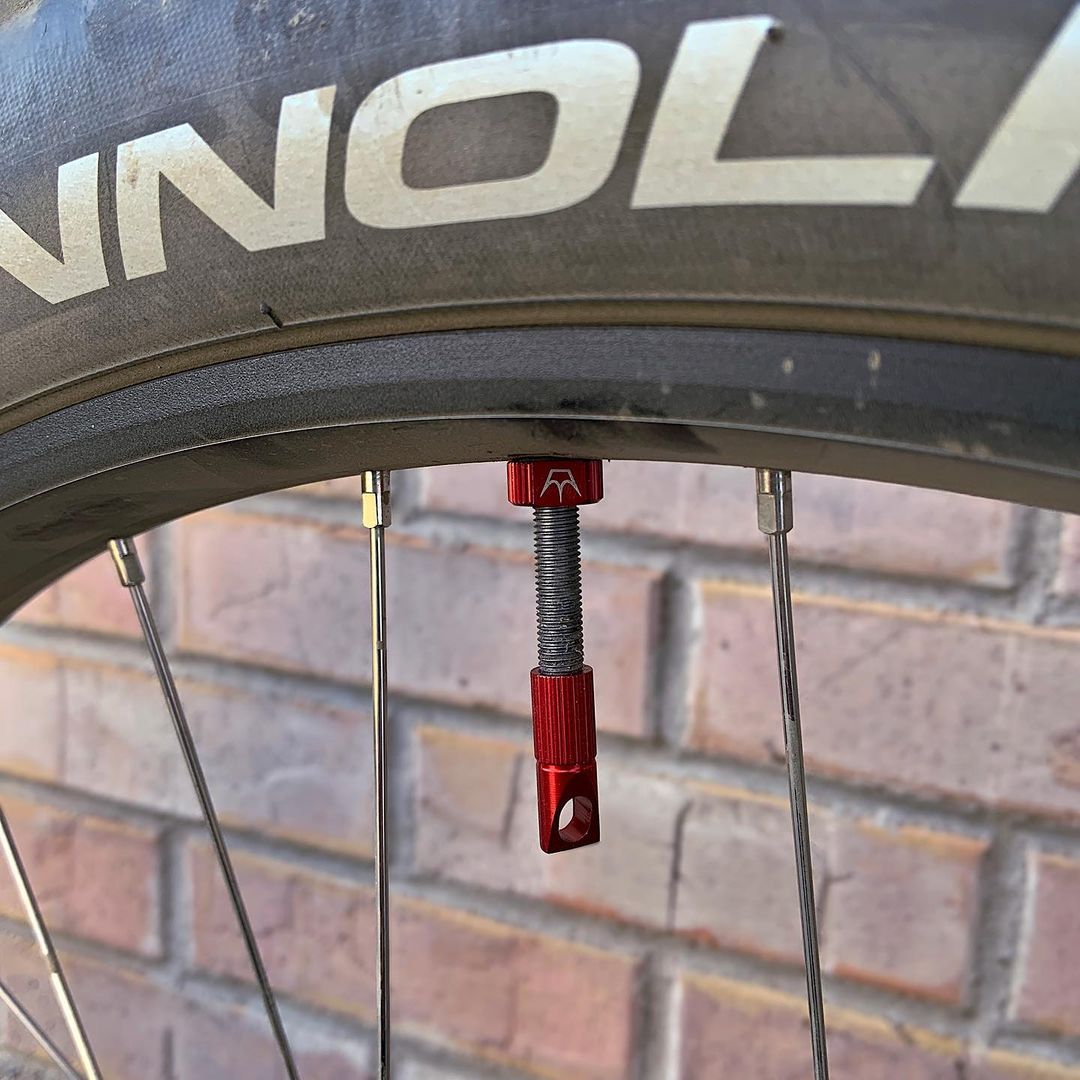

I have the muc-offs and ride it with the cap on cos its got a key in it. Still got one in my kit tho.
Muc offs in oil slick way for me - I just use the little plastic stick that orange seal gives you to knock out the gunk from the valve.
Just the valve part not the whole thing. It gets irretrievably gunked and it is always my front wheel. I do not know why. I just buy a package of presta valves and replace as needed

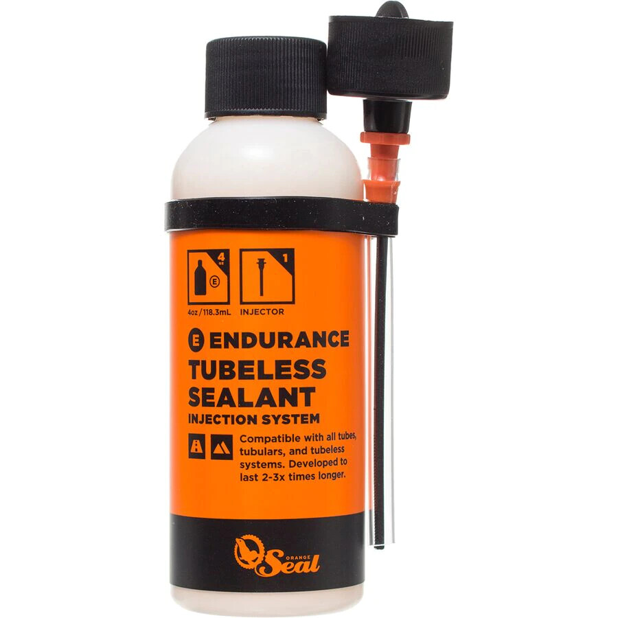

They never gave me a little plastic stick.
I have the plastic stick as well.
It comes in this kit:
Oh, huh, I always just buy the 32oz bottles of sealant.
