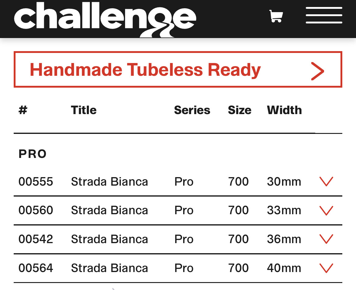

Strada Bianca 33mm TLR are a thing now. Don’t need them but I will drunk buy them next time I’m awake at 3am.

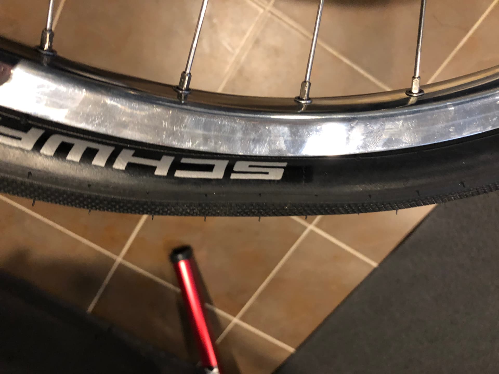

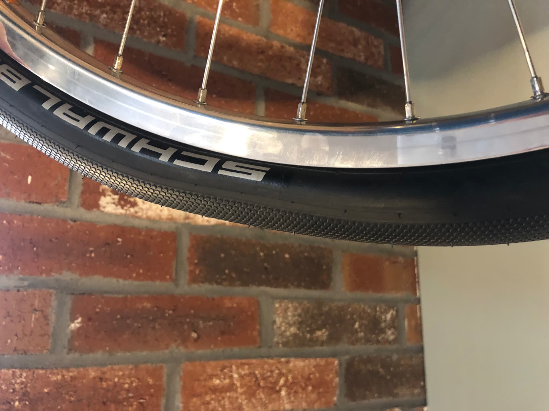

I generally fancy myself to be reasonably competent at installing tires, but these Schwalbe G-One Speeds (40-584) are infuriating.
The front set up tubeless without a problem on a Velocity A23. For the back, I’ve tried two tires on two different rims (A23 and VO), and they will not seat evenly, either tubeless or with a tube. There’s a low spot that’s dramatic enough that I feel a bump every rotation when riding. I’ve set of the non-Speed G-Ones in both 650b and 700c sizes without any memorable issues.
Am I doing something wrong? Any tricks to get it to fully seat? Is there a bad batch of these?
My trick was to send them back.

What rim tap? If it’s anything other than proper tubeless tape start there with the appropriate number of plies.
Seating with a tube is a good plan… lube the shit out of the bead with some dish soap and run it up to 80psi or so and let it sit a few minutes. Hopefully it snaps into place. Of it does I’d let it sit over night to stretch a bit then try again without the tube.
Yeah, two wraps of tubeless tape.
I’ll give one more try with dish soap and then get in touch with Schwalbe.
I had the same exact problem with a Surly ET on a VO Voyager. Tried all the tricks and nothing worked. Tried a different tire and all was well so I guess there was something wrong with the bead.
