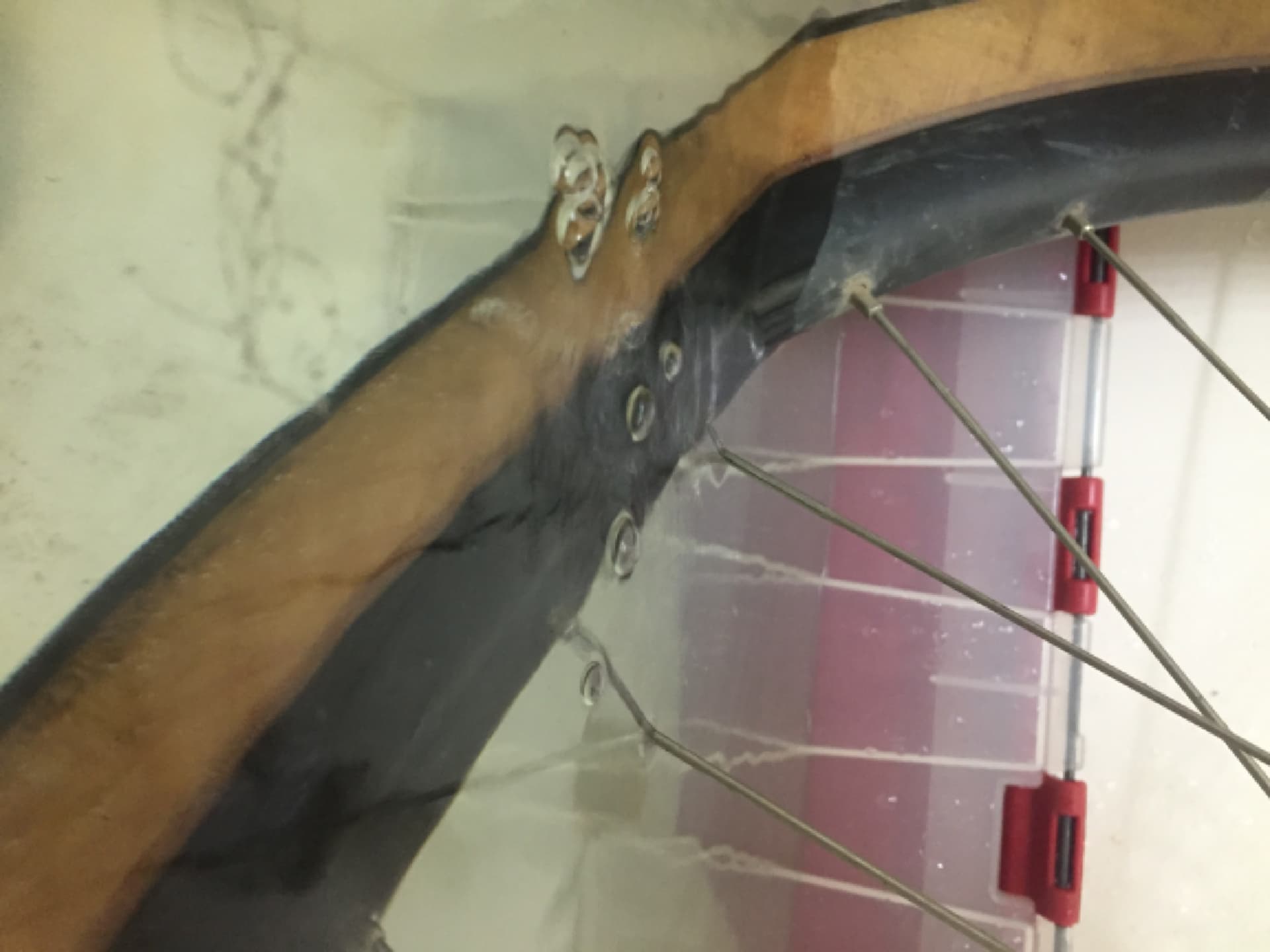

HY found my slow leak
WTH was so sure it was a tape problem that I didn’t think twice before submerging the rim so it is currently hang-drying for a while
You can’t seat the bead, and throw the tube away—a man is not a piece of tube!

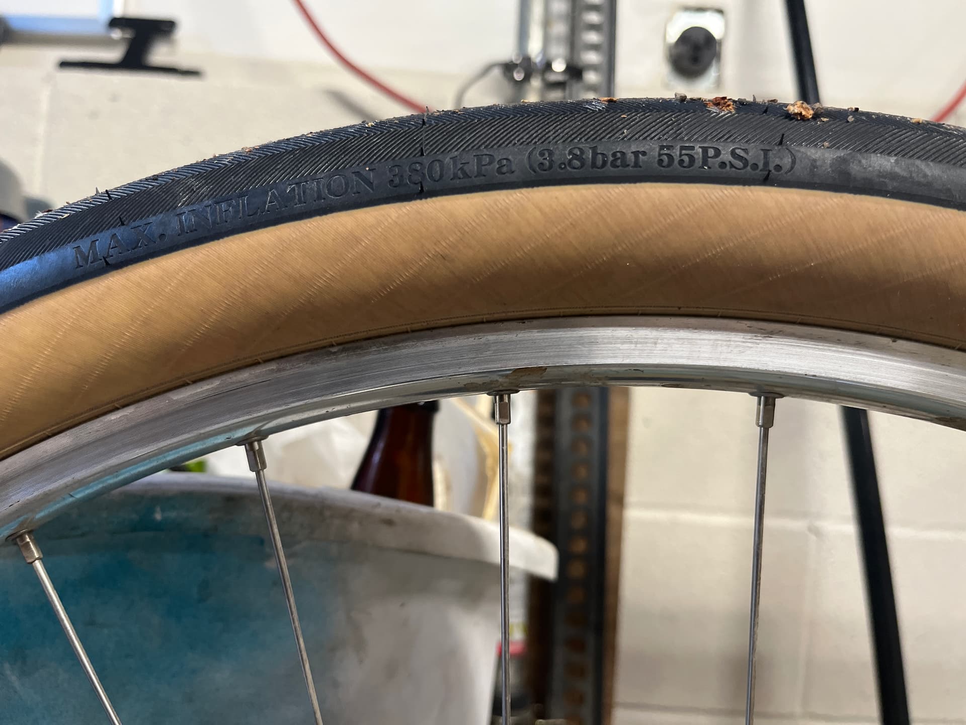

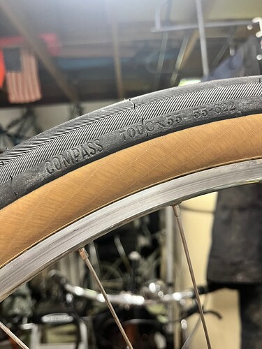

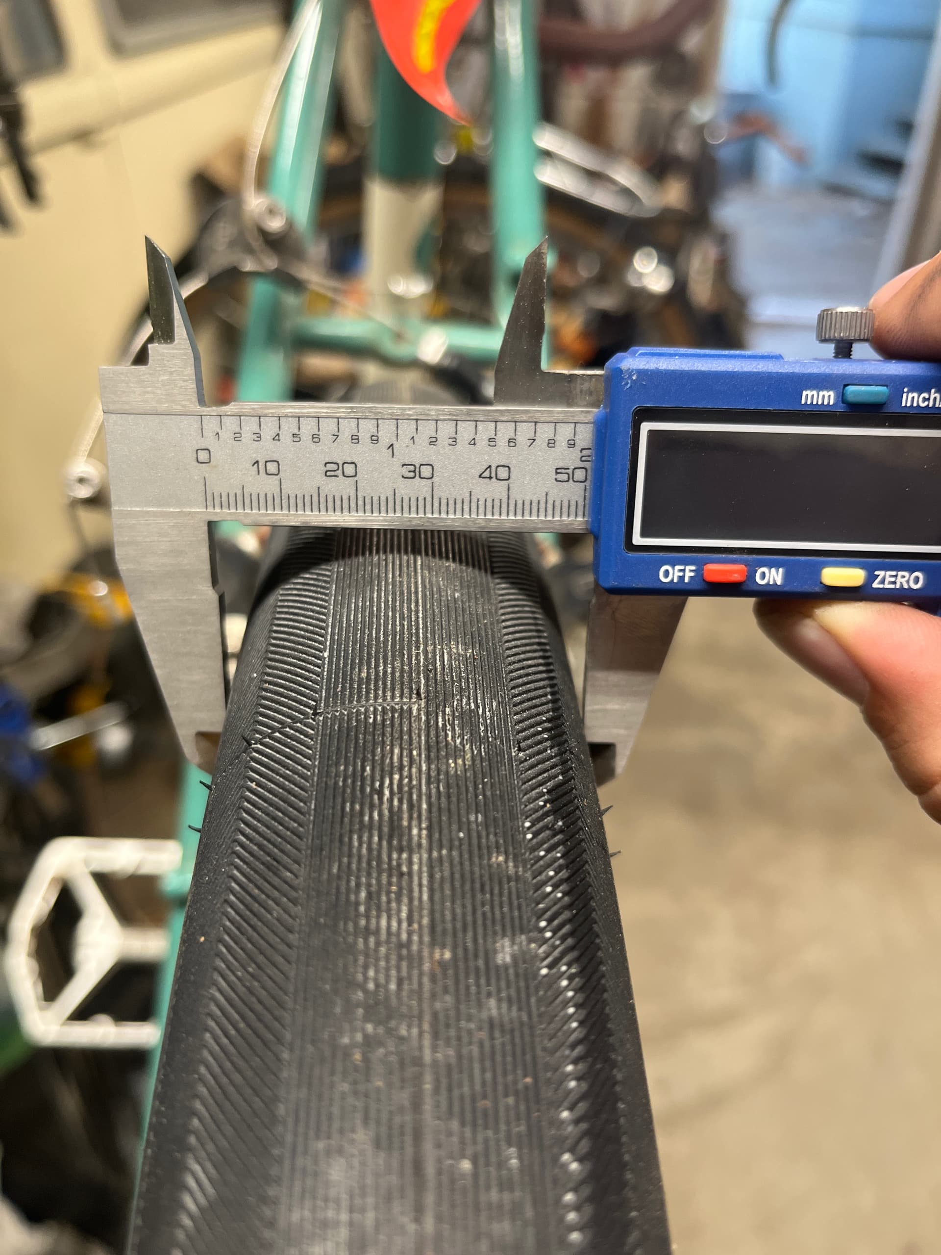

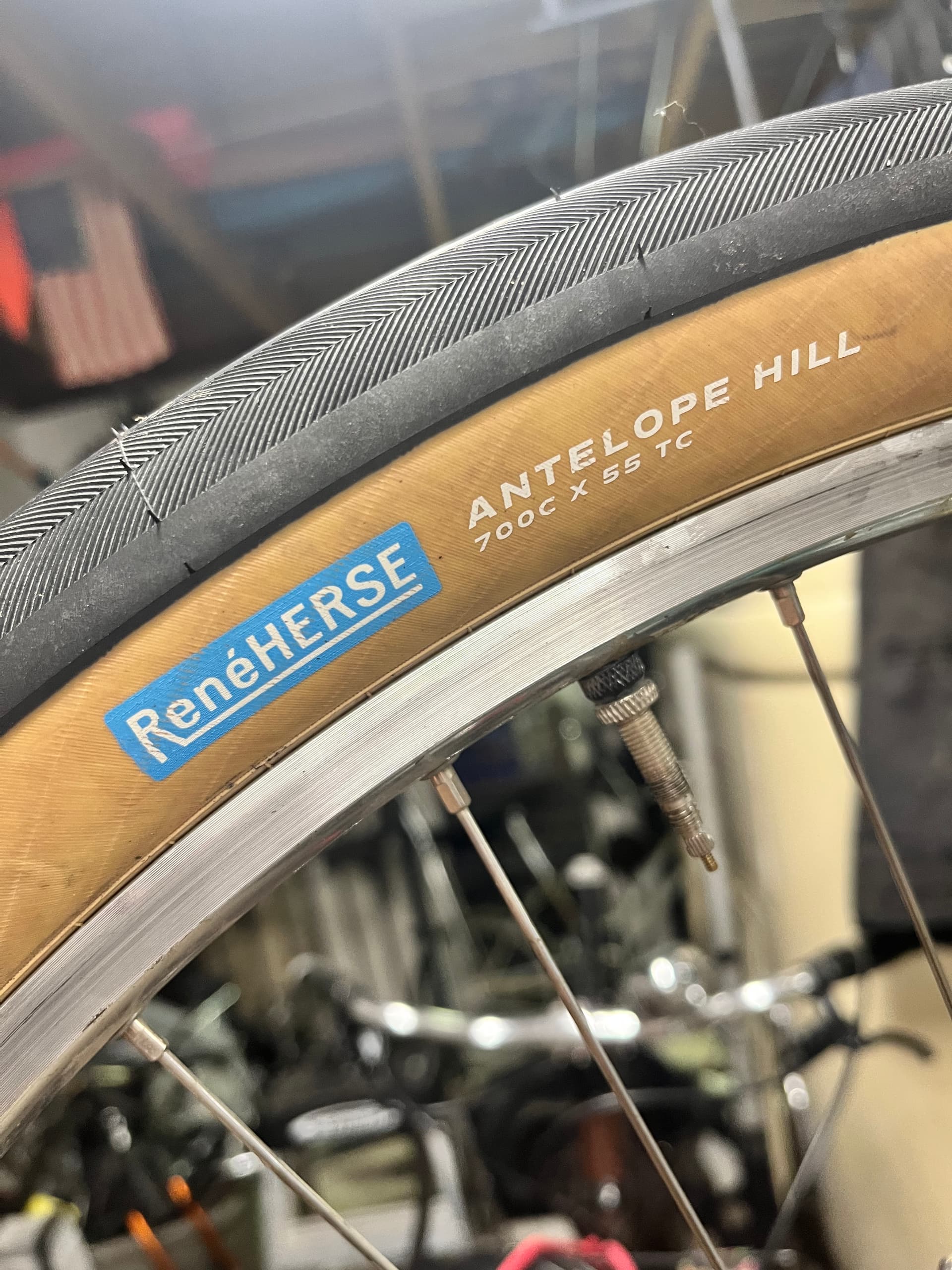

Sitting at about 50mm at 40 psi. Going to let it set overnight to fully seat before adjusting to a more supple pressure. No drama so far with setting them up tubeless. Bought these Antelope Hills used, but interesting find; printed label says Rene Herse, stamp into the rubber says Compass!

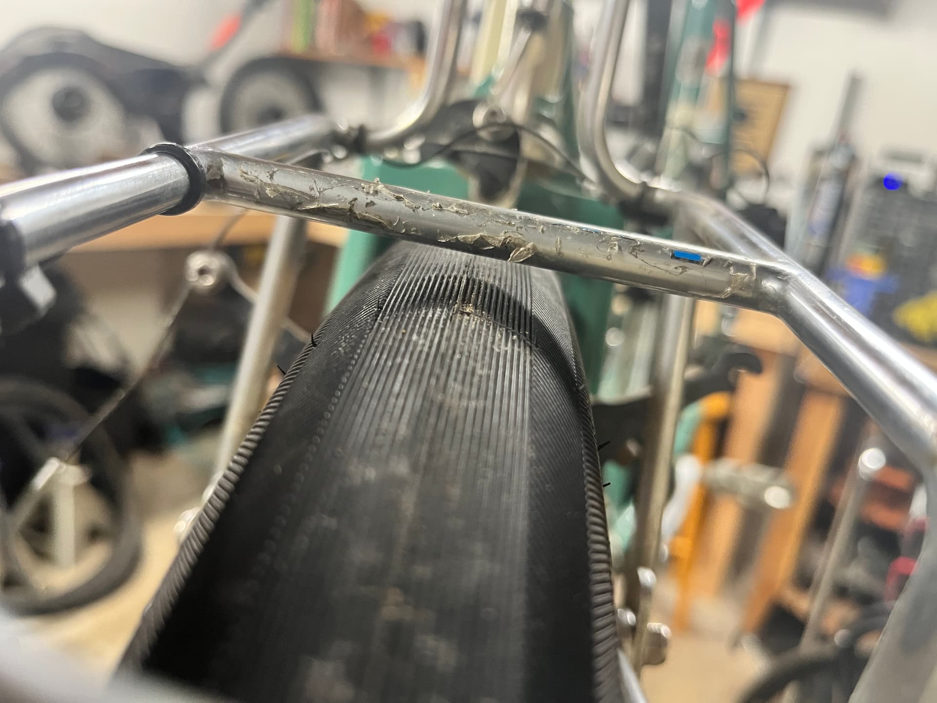

Rack clearance is a hair tight for my tastes.
Probably still has unsafe pressure ratings stamped in there too.
I don’t think I’d want 55
