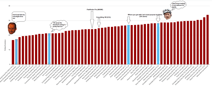

Another dual purpose Heine tire performed poorly over at BRR. I really need to stop Jan-posting, maybe as a new yearâs resolution.
Iâm really curious how closely this method does in fact correlate with the real world. The lack of proper ramping on the RH knobs seems like it should be a hindrance. Maybe that is not the case.
Things seem to get especially murky with the use of a tube. On the one hand, it would seem to keep the testing âstandardizedâ by always using a tube, but with some tires the claim is that they are truly optimized for tubeless use and the penalty for using a tube can be relatively greater than running a tube in a tire that itâs built for.
I understood the novel concept for ânoise canceling technologyâ was the application to bicycle tires since road noise is a well developed area of study for automotive tire manufacturers and asphalt development. But, I had thought it was a novel concept.
Guess everything really has already been invented.
The testing from Tom A and Poertner seems to support the idea of strong correlation with roller tests and real world results. Relative to each other and not in absolute wattage sense. Some (most?) people could feel and determine a difference between EL and Standard casing Rene Herse tires. Which would indicate a lower bound of ~12-15% difference in BRR tested wattage.
I think the knob design is a hedge for on-road performance specifically for the BQ style rolldown testing. They donât roll as well on non-flat surfaces and also donât have great traction - although Panaracerâs single compound rubber is probably an equal detriment here. So I would think youâre correct in the hinderance to good roller test performance. But if riding off-road the result is probably closer to the truth than rolldown tests on pavement.
The tube issue is significantly more complicated and fascinating. The BRR article is fairly surprising both in the issues discussed and the implications for the rest of his testing.
Another point to consider is that the margin of error is bigger when tires are tested with inner tubes. This is because not all tires have the same kind of âgreasinessâ or texture on the inside of the tires; rolling resistance will be lower when there is less movement between the inner tube and tire. The next complication is that when the same inner tube is used in a âgreasyâ tire, it will take some of that âpollutionâ onto the next tire and affecting the results by a couple of tenths of a watt.
The American Classic tires I have were fairly slick on the inside being they had a layer of rubber over the weave that seemed to actually have mold release compound or something on it, so I suspect they would test worse with a tube than something from Panaracer with actual open tread weave inside. How much this matters outside of relative ranking with other tires is open to interpretation.
