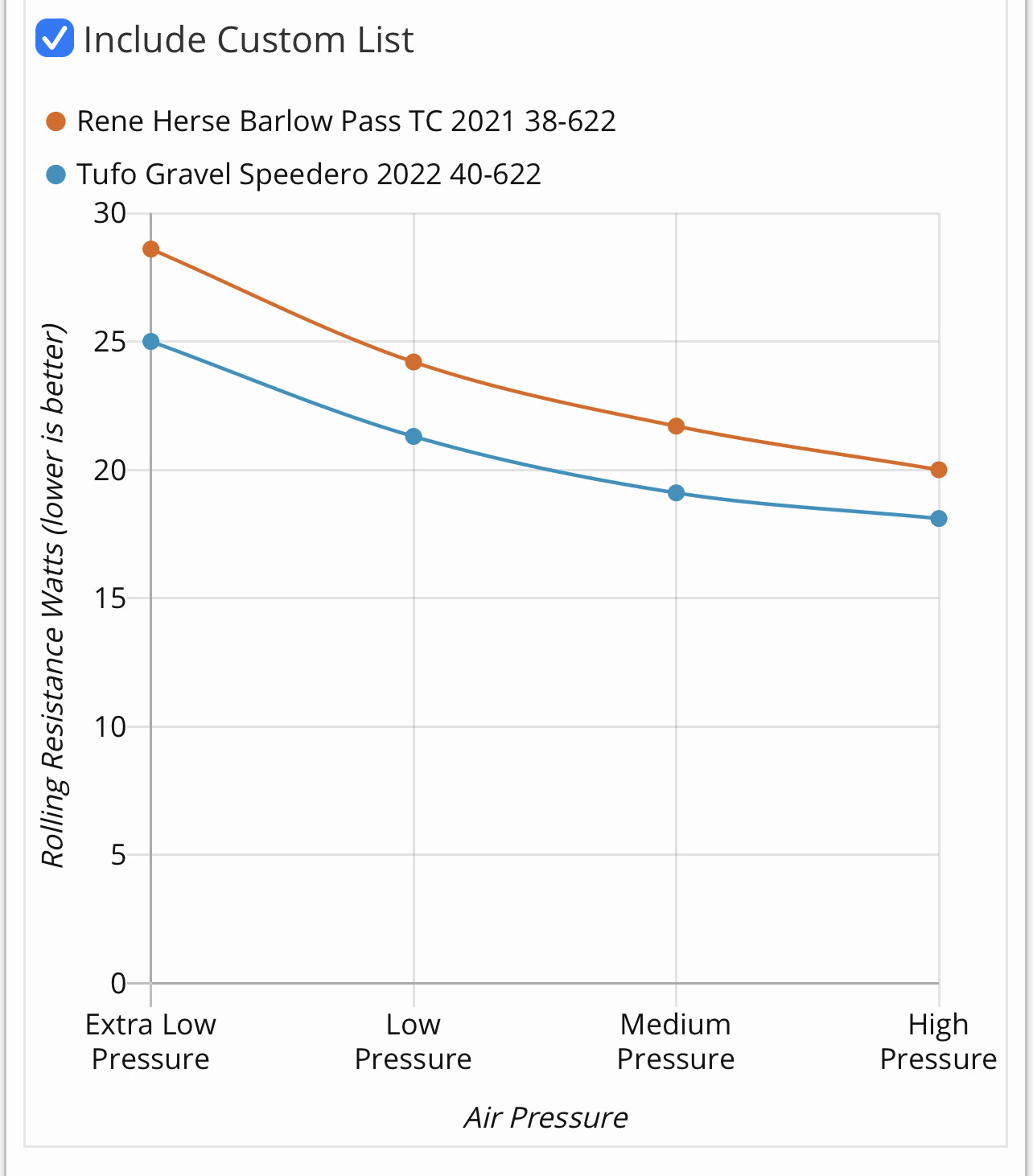

I had a set of Barlow Pass which is roughly similar in size. The tubeless experience was not good and there’s the weeping that happens. The casing wasn’t made to be tubeless. Finally, they weren’t that fast for as delicate as they are:

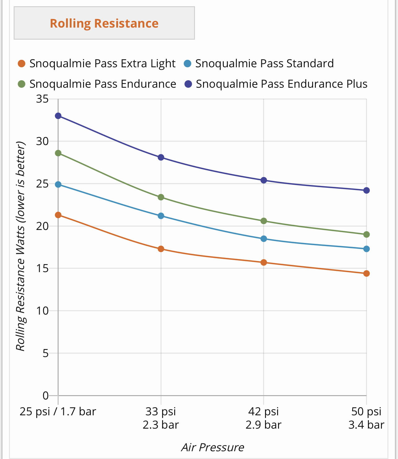

I imagine similar rolling resistance across all the RH sizes for a similar tire. BRR tested the various casings:
An extra light casing looks appealing from a speed point of view but I’m aiming for some puncture resistance here. However, I’m the BRR puncture resistance test, the extra light did as well as standard.
Still the GP5k is fastest among all the tires and has puncture resistance I know is good. If I want faster, I may get a set of those in 32mm which may be sufficient for my winter needs.

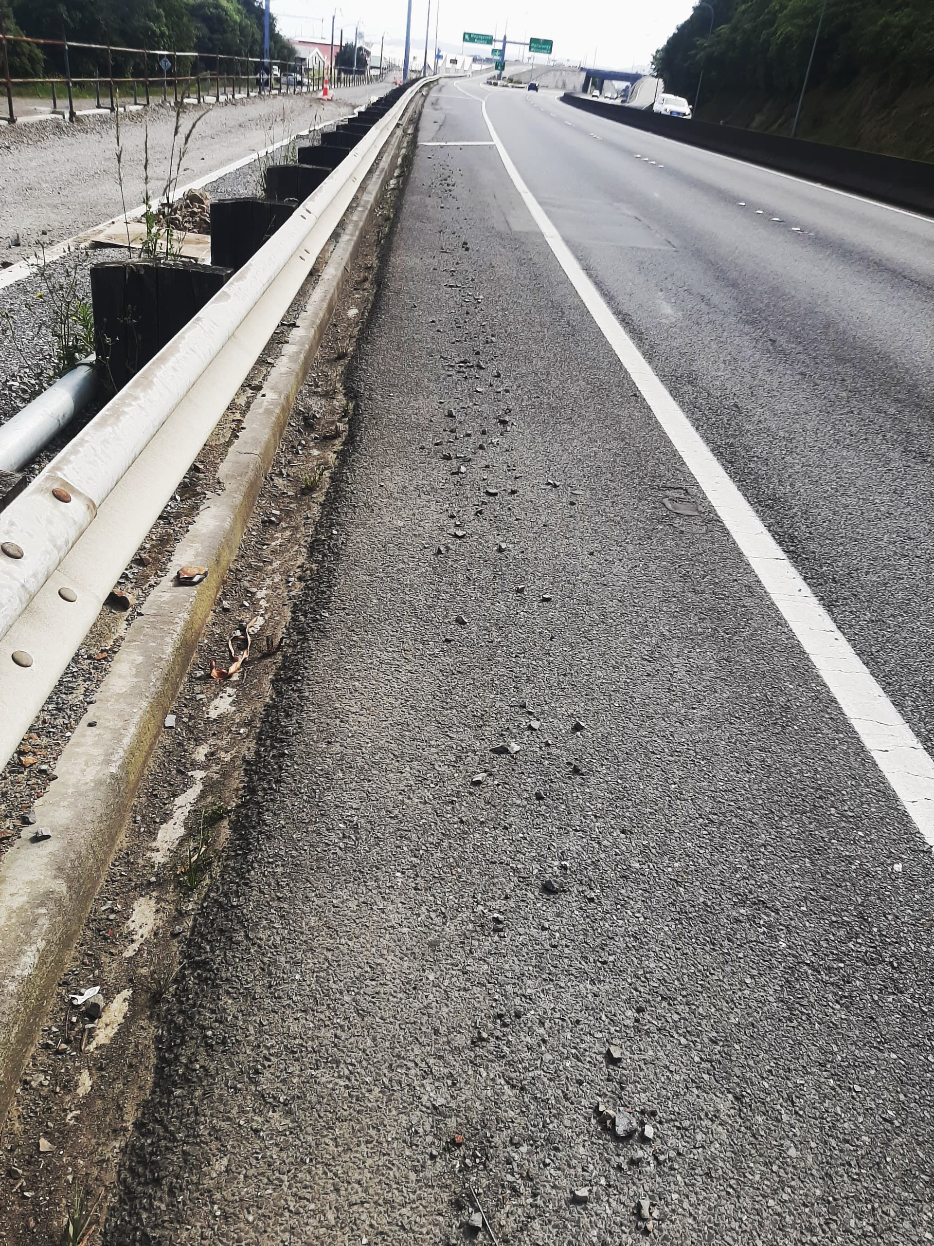

This is part of my commute. Been like it for about a week now. I don’t get punctures, but use tubes. Using runny arse most times. I guess not that much glass enroute.
That doesn’t look like a good place to ride a bike
I ride through the worst parts of Oakland on a daily basis. There is glass everywhere. I avoid it if I can, but often can’t. Thing is, I’ve never had problems with punctures until recently.
