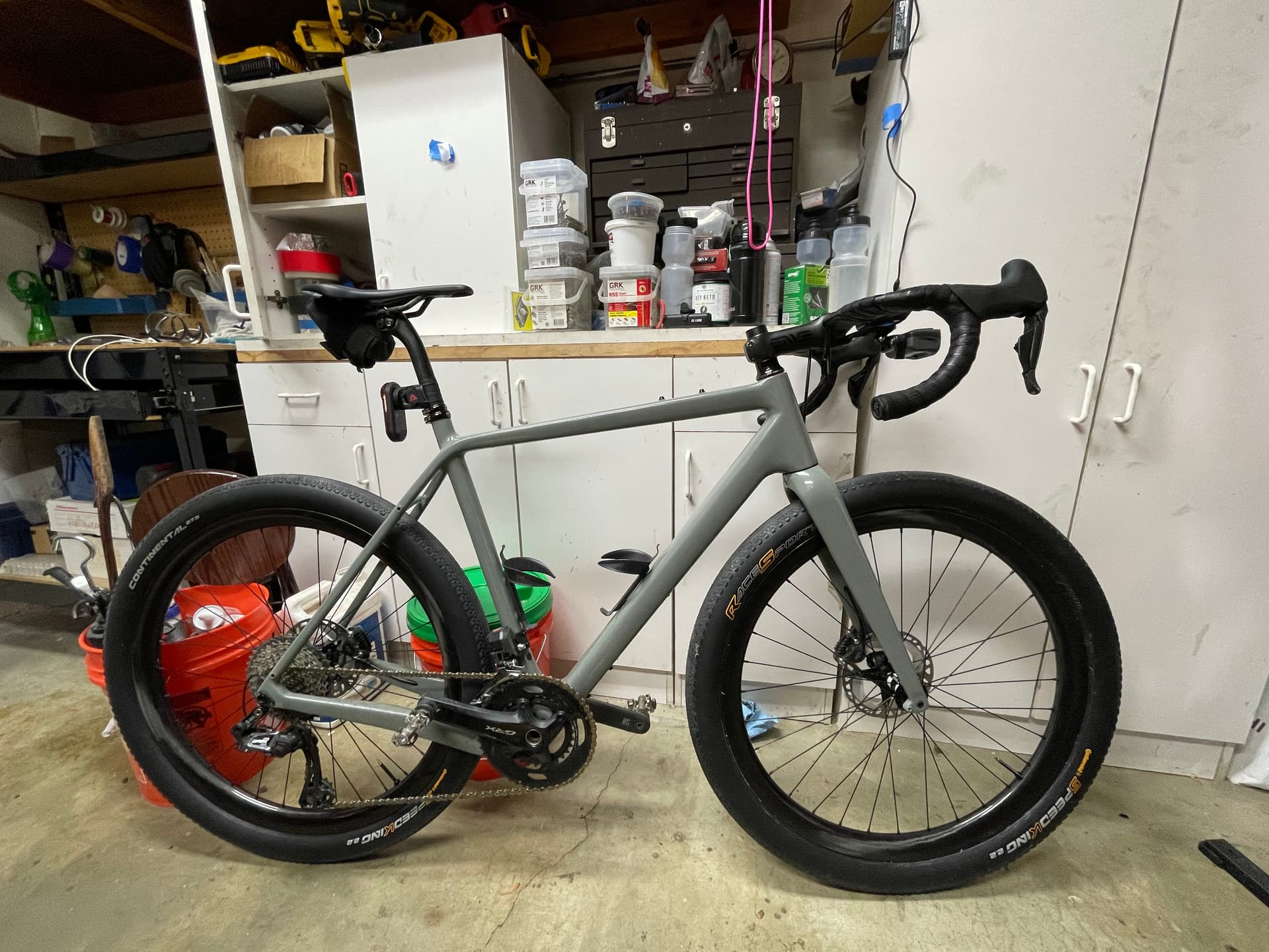

That looks mean as hell. Those Contis really are fast.
That bike looks soooo badass

Also, Heath’s bike broke my brain last night. XC MTB tires on a carbon drop bar road bike? Those look ENORMOUS.
Same. Thought there was something going on with the photo (like the 3d crap), but no, it was just hella wide tires.
My goal, of course was to settle an argument in which there was no terrain that I could handle on this bike that would necessitate the use of a dropper. Handled climbs easily that I’ve had problems with in the past. Hit the single-track behind my house that’s tough on a good hardtail, much less a gravel bike and… I don’t think a dropper would’ve saved me.

I think most of it is due to the rim profile. I had a 2.2 s on my bike here and it does not look half as badass.
Is your bike 27.5 or 29 though? I seem to be making out 27.5 on the sidewall.

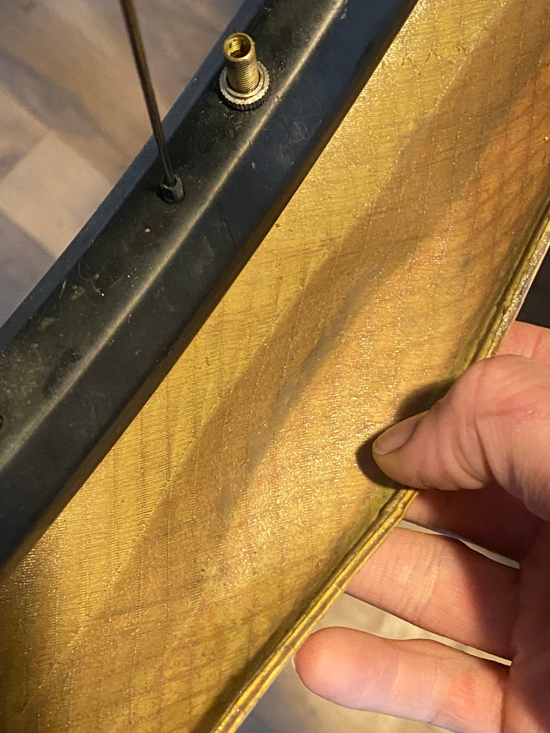

Anyway, I cracked open my leaky reen to switch it from Stan’s to Orange Seal.

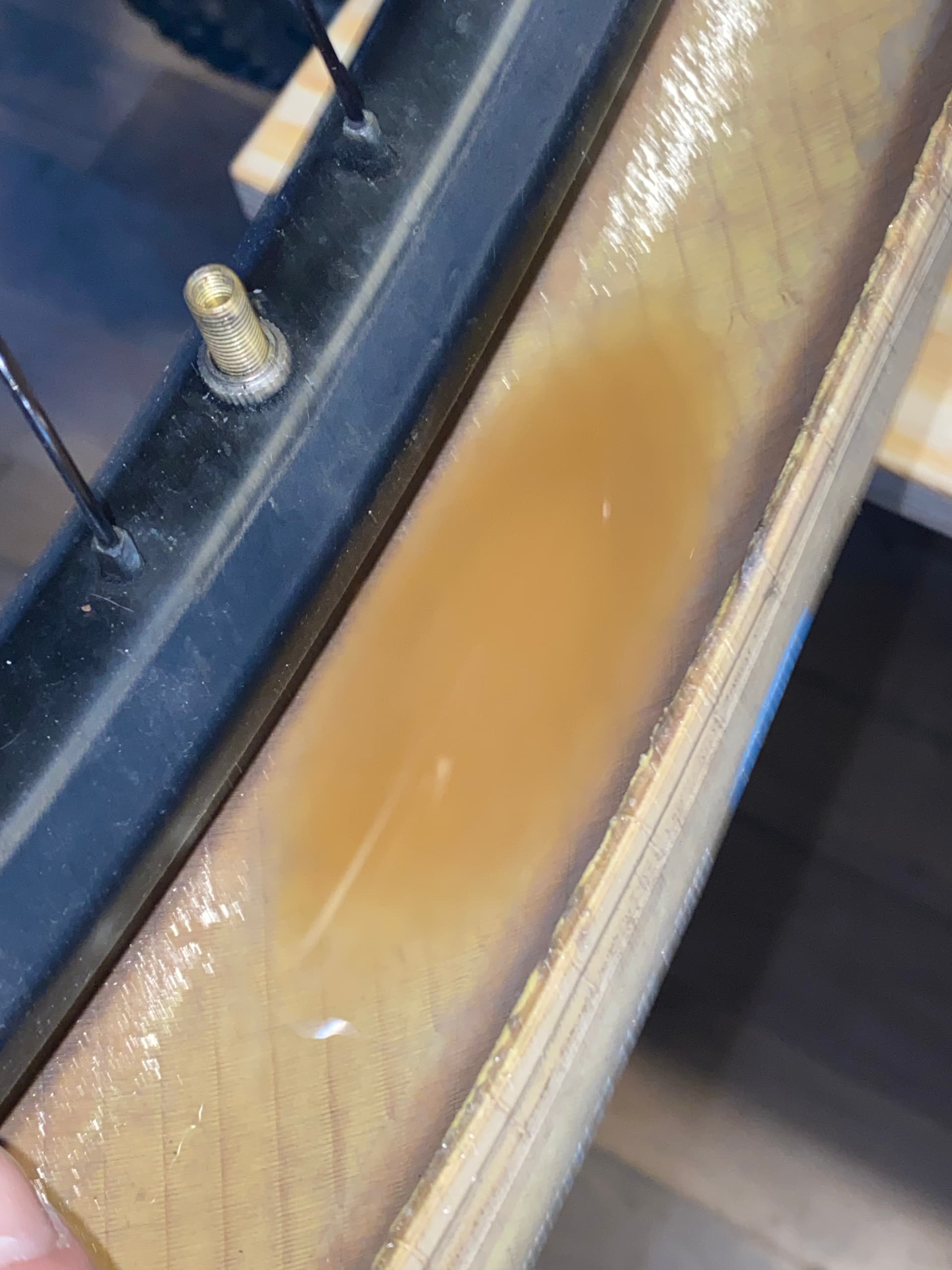

First off, this looks unlike any Stan’s I’ve ever re-visited in a tire. Goddamn gross:
Second, it doesn’t look like it is playing well with the casing at all. As if it weren’t adhering and thus not building up a layer to seal the sidewalls.
So I did a quick wipe, seated it (first try with regular floor pump), filled it with 2-3 oz or so of Orange Seal (endurance), and will see if it weeps out of the sidewall like the Stan’s did.
27.5 Heaths is too eh?
