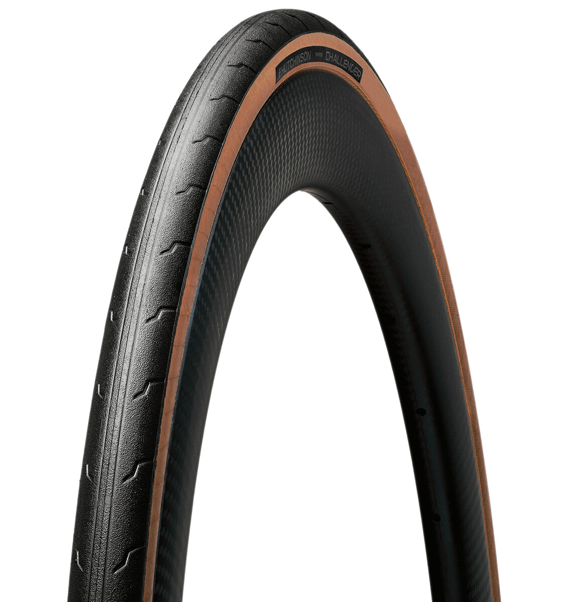

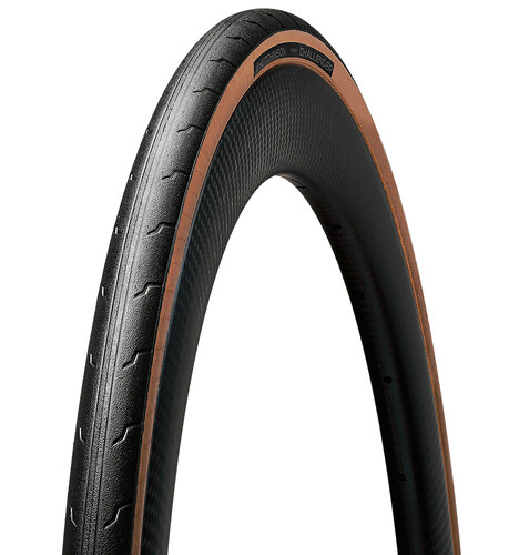

Need a durable but not too turdly 700x30 tire. Preferably on the cheaper side of things. Preferably tan sidewalls. Not tubeless. Anyone try Hutchinson Challenger?
Edit: seems to be hard to find in US actually. Open to suggestions.
