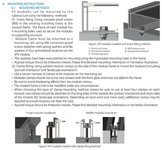

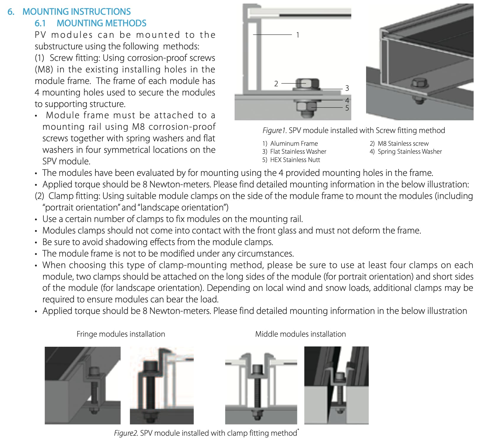

so you basically need mounts or standoffs for rigid solar panels only, a rack is kind of a different thing and implies other types of gear to be temporarily mounted

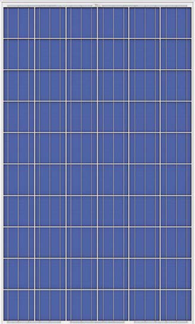

are the rigid panels you have self-supporting or do they need structure beneath to support their own weight and wind forces?
They’re self supporting - I’ll probably get a fairing for the front but honestly this vehicle doesn’t drive 55 very often
I mounted a rigid panel to my fiberglass roof using vhb and sikaflex. I used some 2" aluminum angle stock between my roof and the panel. No pics, sorry.
their instructions state you need airflow behind the modules, but they also have integral rails with mounting holes. assuming the surface of the fiberglass cap isn’t planar though so you may need some way to adapt the geometry which could be as simple as a couple rails cut to fit the profile of the roof, then secured in place with tabs
