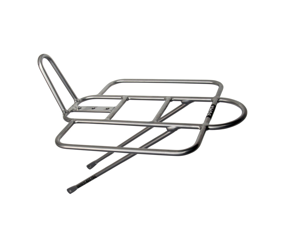

We’re working on a more adaptable design, but it’s still a ways out. What fork are you using? Soma? Would it work if you bend the legs out to make a larger angle?[/quote]
Yep the Soma, I wasn’t confident in my bending abilities, plus the tang needs to be longer and thicker to extend the decaleur tombstone 2-3mm further away from the handle bar and cables. In fact you guys should just make one of these:

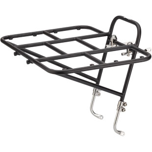

in 4130 or Stainless, adjustable lower rack struts, adjustable top struts, tang extending half-way through the rack, and triangulation in the platform.[/quote]Surly already makes what you’re describing
And it’s an incredibly heavy piece of junk. Once you have 4 adjustable struts on a rack like this you can’t make it stiff enough without having a bunch of superbeef special hardware. That’s why the haulin Colin and similar sit atop the pecking order of front platform racks: no adjustability. Designs like the soma rack are the best compromise to fit bikes with slight variance in dimensions because they move all the adjustability to the tang and only have 1, as opposed to 2 adjustable struts. It could benefit from being steel and having a thicker tang. Even with the soma style design you still need something close to the rawland/riv braze on spec

Unlikely as the Collin rack is basically made to the fork. I tried moving mine to a forked with the rawland/riv spec and it was off by a CM here and there. That Soma rack is close, but no eyelets for lights is pretty meh.
That and it’s aluminum, I’ve seen one snap and collapse. Where’s the rack thread?
