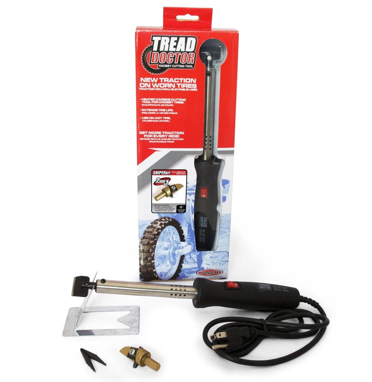

whoops just bought this

[quote=lukasz]whoops just bought this
[/quote]
you gonna de-knobbinate something?
yes
