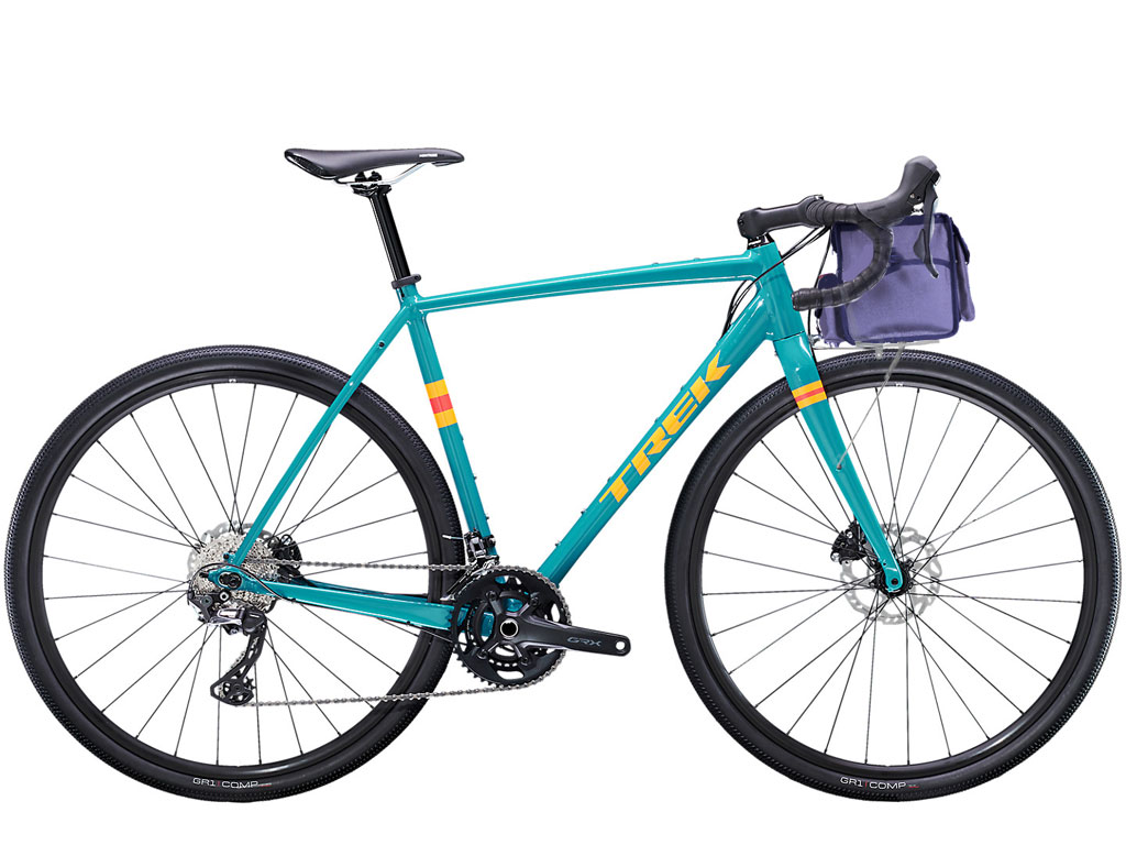

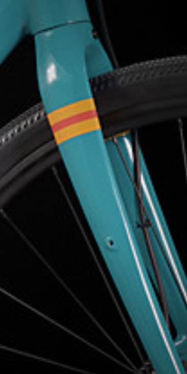

It carbon fork with all the right mounts n crown hole
Did they ditch press fit BB yet?
new treks are all T47.5 (the .5 being for better tool purchase during assembly?), I think.

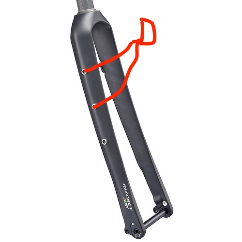

if I could figure out a non-JA light mount situation for this Ritchey fork I’d probably already have it for the DayRuiner.
  • mounting a light on one side of the fork gives that awful wheel shadow
  • bar mount gets in the way of any sort of bag attachment possibilities
  • maybe mount on top of a fender?
  • rig up a 3-point mount from each blade and then to the back of the fork crown?
clearly this is what you need:
