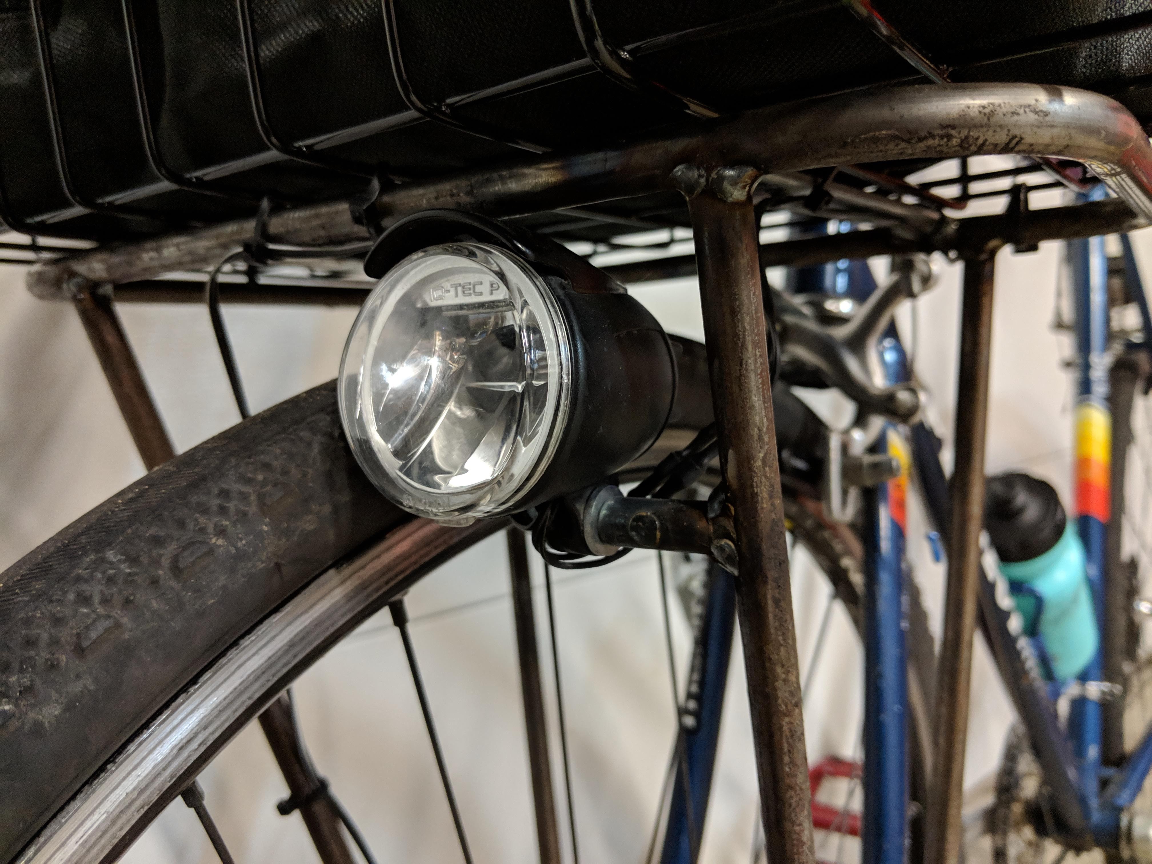

I thought mounting to the bottom of the front rack next to the tire but forward enough to avoid wheel shadow was the one true way.
This is what I did on my commuter and it is delightful.
Samesies

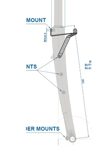

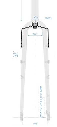

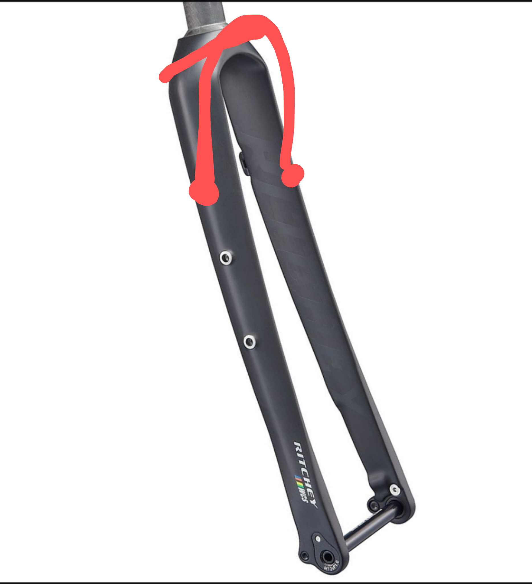

Maybe a simple 3 point mount like this (to back of fork crown)
But then I may as well have a rack :man_shrugging:
What is the rationale for not drilling that hole all the way through?
If they did, then you might put a rack on it.
How long would those two arms be?
Ponoko can laser cut 1/8" aluminum and they have a hub in Berlin. Or maybe it’s a sandwich of 1/16" aluminum with acrylic or delrin in between.

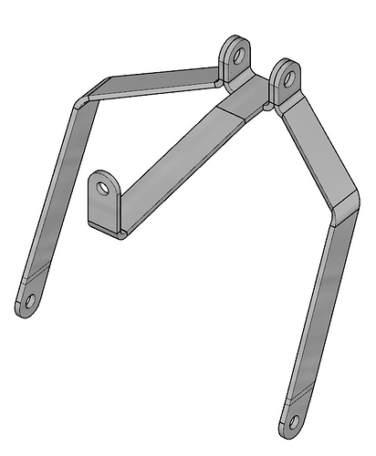

Here is a possible formed sheet metal version. Could definitely be made one piece, and a lot better looking, but this is a start and would be easier to make yourself, and/or would fit in a smaller area if trying to nest it with other parts.
I’m going to try and make a version for 3d printing, because I think that would be a good challenge and I haven’t worked on something fun and product-y in a while.
