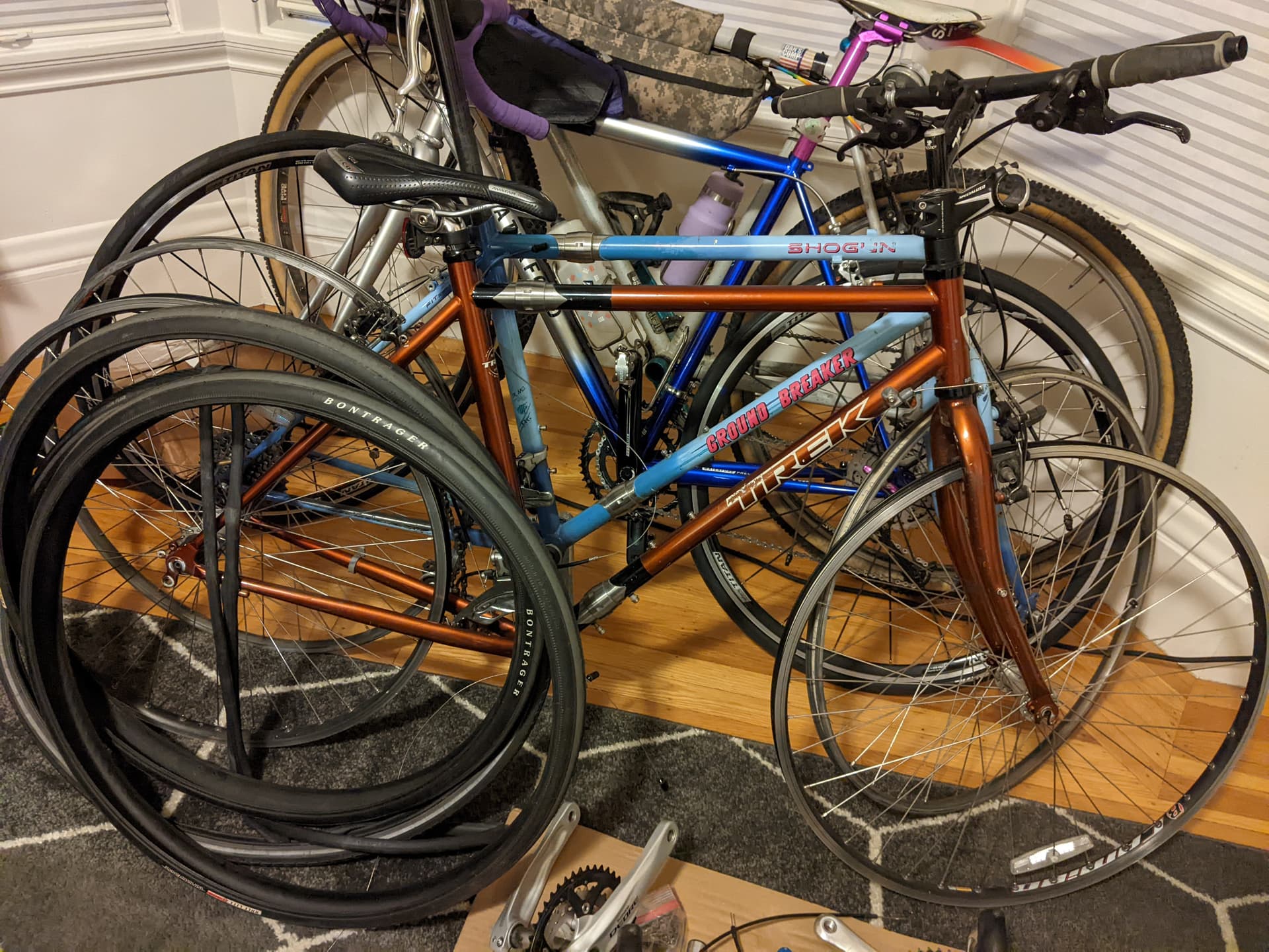

these two couplered bikes will be making a big appearance in here soon. I originally thought i wanted to keep the Trek and give the Shogun to a friend, but now, seeing them, I think the Shogun might be the better travel bike if it fits. They need a lot of cleaning. it looks like the tire clearance on the GROUND BREAKER might not be satisfactory for travel. Probably going flat bar/ alt bar on both.

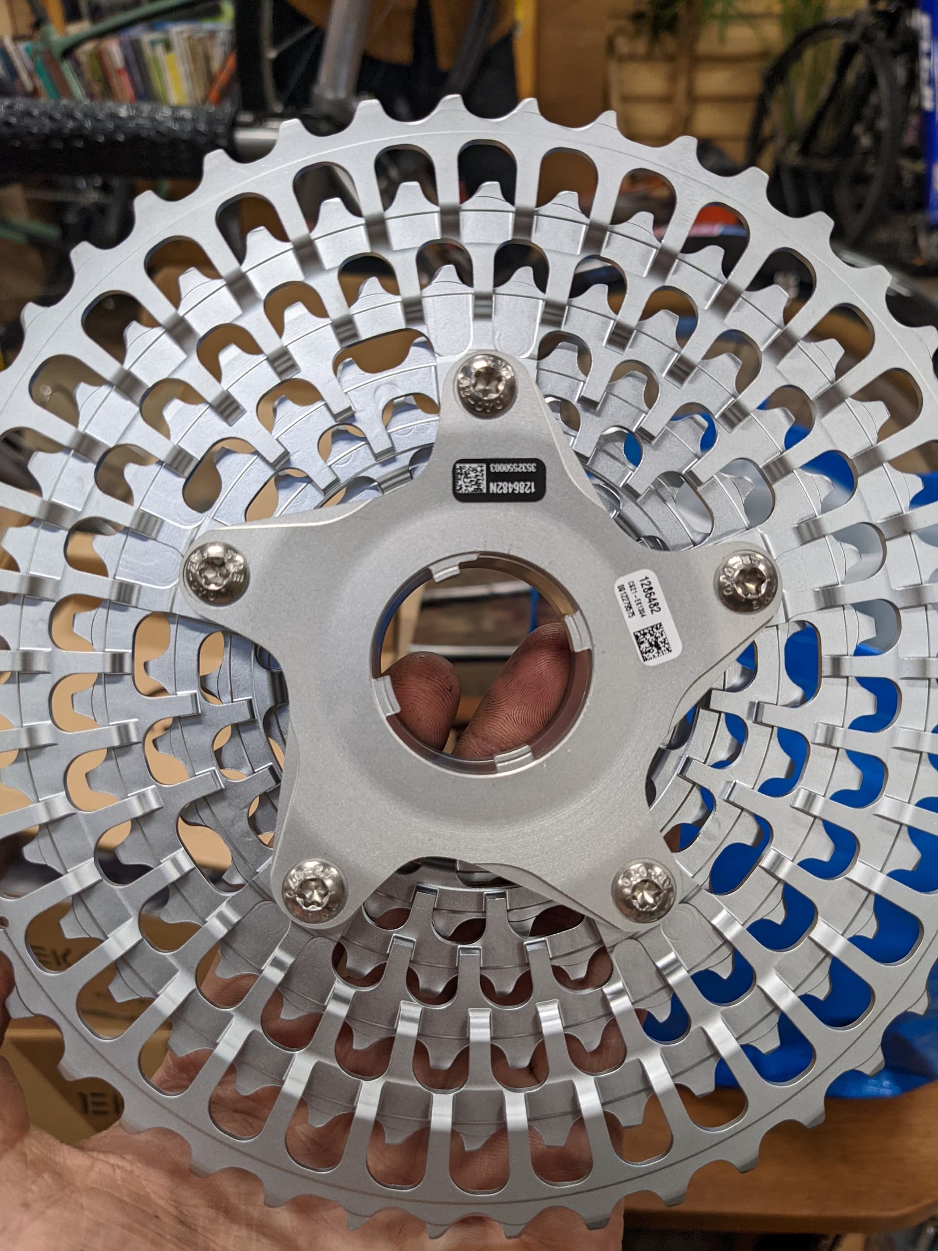

Gathering parts for the CG build. I’ve never run Campy and have only worked on it a few times.
This cassette is a damn work of art
Yeah. The new 12 and 13s stuff is really impressive.
wow that is truly beautiful
now that nothing on bikes is compatible i am campy-curious
I’m a campy hater and ekar is cool AF.
