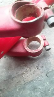

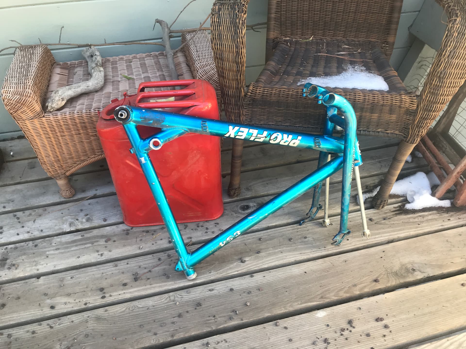

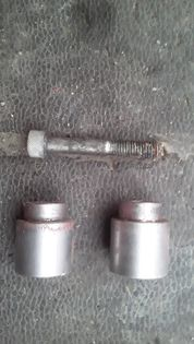

Here’s a weird one, was gifted this ProFlex 854. Seems fun to try and put back together, but all the pivot hardware is missing. Trying to scrub the internet for an exploded view so I can figure out how to replicate.
What it was;
Yep, had one just like the red on in the article. Tried my best to rebuild it.

One dude came through with the deets! Surprised/not surprised its all friction without bearings etc.
I wonder if you could find someplace to make replacements out of Delrin or a similar bushing material.
Yeah, feel like there could be better ways. I have a friend who is luckily the great combo of fabricator/bike nerd so we have been discussing a weekend playing around with his machines and making some things. Also wondered if brass would be a better material?
I bet it runs on WF-1620-08B
Do you mean the material, or that exact item? Would need more shoulder to bolt on the swing arm I think?

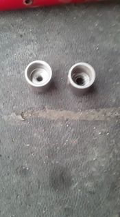

The acetal Oilites were definitely used on bikes at the time. I’m guessing on the size based on ID since I don’t have any other dimensions.
Just out of curiosity, are my pictures above not coming through on your end? Shape is different than what your found.
Screenshot at 2022-03-03 12-59-57

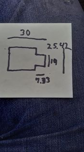

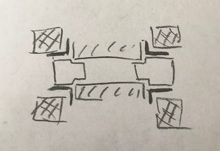

Assuming it fits like this, unless the flanges go the other direction into the frame and you need a 3/4 bushing instead of 1"
I’m fairly certain I’m the one confused here. From your link part A would go in the frame and B would sit in the linkage, so my thought is the dimensions listed (0.875" for A and 0.125" for B) don’t seem correct? A should be short, B should be the longer.
