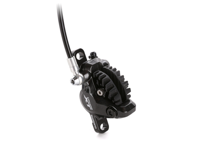

Hope RX4 Front:
Can’t use on the fork because 160mm IS to Postmount adapter hits one of the 4 pistons that hang low (fits fine with 2-piston BR-RS785 caliper).
I could possibly upgrade to 180mm rotor because caliper clears the 180mm adapter but I also discovered that IS mount is too far inboard to allow the caliper to center on any size rotor. DOH! Should have checked that before putting the bike under torch and powdercoat.
Hope RX4 Rear:
Had it sort of working on Saturday for our quick overnight camp but was getting some weird rotor rub that got louder as time progressed. You could reset the noise by flicking the lever.
Got it home, checked the centering and discovered that the new orange powdercoat was thick enough to make the already hairline acceptable tolerance even worse. As I mentioned last month the rear IS disc tab is also too far inboard similar to the front but was barely acceptable with the brown powdercoat. New orange powdercoat thickness has pushed it over the acceptable limit and I can’t center the caliper which was already at the end of the slot.
Also discovered that 4 pistons have their own set of issues, one of the smaller pistons didn’t want to cooperate even after pushing them out, cleaning them with alcohol and cotton swab then reapplying mineral oil to the sides of the pistons. While setting them up I also noticed its a pain in the ass to remove the pads out of the caliper because the right angle banjo & hydro line get in the way with my weird hose routing orientation (caliper on chainstay, hydro tube along seatstay).
For a second I thought I could pull off BR-RS785 on the front and Hope RX4 on the rear but needing to carry two different replacement pads on extended tours and dealing with bleeding two different styles of brakes left me thinking I should just get an XT caliper (for the banjo) to have the front and rear mostly match for ease of everything.
Also, Shimano calipers are amazeballs and easy to bleed compared to the Hopes. Not being able to turn off the bleed hole on the RX4 seems like a stupid design.
Overall it was an interesting learning experience for my first hydro bike. It also changed my feelings about chainstay mounted disc calipers. Going forward I would only recommend chainstay mounting if the frame builder has figured out an easy way to get a allen key to the mounting bolt (closest to the dropout) that secures the caliper to the adapter. Even my extra long Park Tools T-handle driver had a hard time getting into that tight spot. Imagine trying to recenter your caliper in the field only to discover you can’t get your multi-tool close enough to the bolt.
Its crazy that all this trouble is my fault because I really wanted to run the hydro line along the seatstay and toptube instead of the chainstay and downtube.
In conclusion:
  • The only person I can blame is myself
  • Chainstay mounted calipers are kinda dumb if you need to adjust them in the field because the seatstay gets in the way.
  • If you are a frame designer make sure your IS tabs are further outboard because its easy to shim them inboard with washers if needed but the opposite is impossible.
  • 4-piston brakes seem like more trouble than they are worth for road/gravel centric use, doubles the likelyhood of piston issues.
  • Shimano is awesome (except for the BR-RS785 which doesn’t accept right angle banjo connectors)

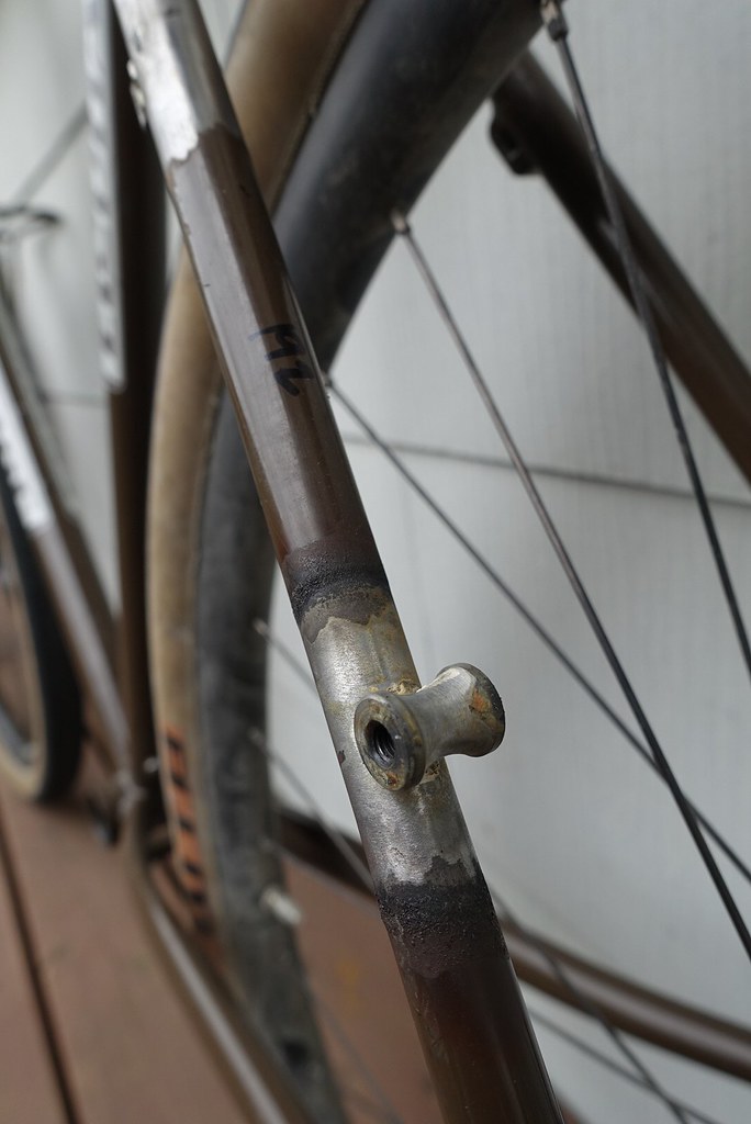

I forgot to mention earlier that I really exacerbated the issue by deciding to have the rear light barrel braze-on located halfway down the seatstay where the allen T-handle needs to rotate.
Elephant National Forest Explorer Modifications by Andrew Squirrel, on Flickr
